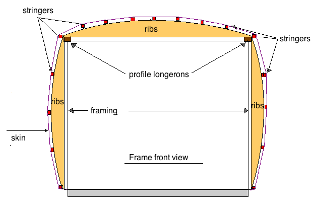

I am a newbie to the forum, but have seriously enjoyed lurking on the site. I'm an industrial design grad student, and I am presently designing and building an ultra-light pop-up travel trailer. I'm planning on using the skin-on-frame technique you all are talking about (though more similar to the Greenland style kayaks than the airplanes).

Postby GPW » Sat Oct 16, 2010 7:19 am
Great site JDave!!! :thumbsup:
Par' , this was what I'm seriously considering ... http://tnttt.com/album_ ... c_id=65819
You can make the walls as rounded as you want with "formers".. the closer the stringers , the smoother the look ... http://tnttt.com/album_ ... c_id=66568
This process should produce a Very Light TD , capable of withstanding the air loads of highway speed towing... planes built like this fly Much faster than we ever could tow ... :o No problem... Glassing it would make it very TOUGH!!! Probably not add that much weight if you were careful with the resin (the heavy part)...
Just like building a Big Fat canoe ... :lol: ... and you could probably pull this off pretty cheap too if you did your own wood cutting ... :thinking:
