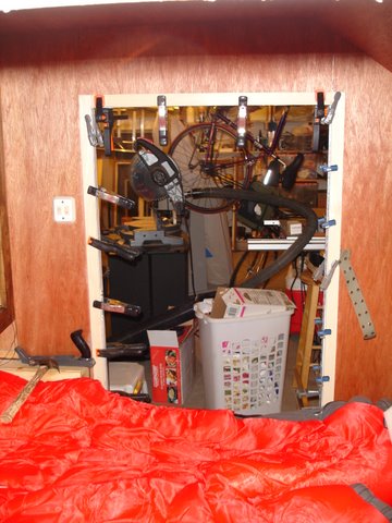

Well, as it turns out, I didn't leave enough room for weatherstripping around the doors.
I tried something from HD, and it should have worked, but couldn't fasten it.
It looked promising, too!
But, it kept shifting. So, I pulled the door jambs off
I'm gluing 1/4" poplar strips that will be behind the door jamb
When the glue dries sufficiently, I will put the door jambs back on and have 1/4" to put weatherstripping in. Hope it works!

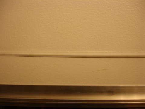

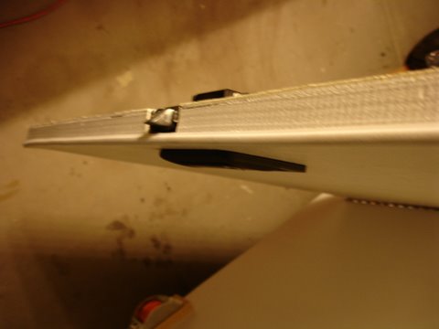

Cliffmeister2000 wrote:Well, as it turns out, I didn't leave enough room for weatherstripping around the doors. I'm gluing 1/4" poplar strips that will be behind the door jamb. When the glue dries sufficiently, I will put the door jambs back on and have 1/4" to put weatherstripping in. Hope it works!
It should work. I almost did the exact same thing but caught it before I glued my door frames on. Glad I did because I epoxied my frames on and to remove them would have been difficult without tearing up the interior. Anyway, I glued a 1/4" strip in like you and used a 3/8" weatherstrip to finish. Worked great.
Spacer glued in:
Frame glued on:

planovet wrote:

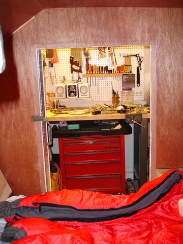

Mark, what is the white fuzzy stuff in this picture?

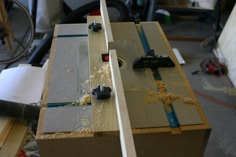

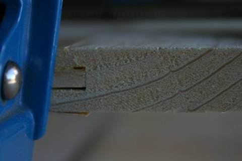

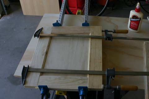

Well, today I used my home built router table to make my very first cabinet door! A weak attempt at best! Still, there is some satisfaction in having narrowed the fear factor to a manageable level!
This door is made from cull lumber from HD. $0.51 each, 1x6 lumber 48" long. $19 worth of Aracua 1/4" ply.
Hummm... Panel needs to be 1/4" narrower and shorter!
Home built router table, with Chinese 1/2 plunge router installed.
Original plan was to make these of poplar. However, due to continued unemplyment, cull pine seems a reasonable alternative for now.
Router set for the stiles and rails came from Harbor Freight. Not recommended.

Cliffmeister2000 wrote:Mark, what is the white fuzzy stuff in this picture?
Sorry it took so long to reply, I was on vacation 8)
The "white fuzzy stuff" is a carpet-like hulliner that I put on the walls. I did not want to be surrounded by wood and wanted something to dampen the noise. It went on with spray adhesive and looks great. You can get it here.

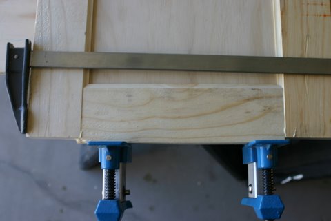

Had to make a clamp extender,
