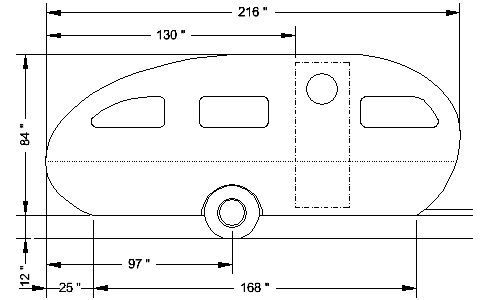

I am thinking the straitening the frame and moving the axle back will be the better option, let me pass this by my welder friend. The large step outside the trailer scares me (and my handicap), so moving it inside helps.angib wrote:Hmmmm...... not that easy.
As you might have been encouraging me to do, having given all those dimensions, here is a quick sketch of what I think your frame looks like. Here I've positioned it so the axle is in the (guessed) right place - more work is needed to see if that really is the right place:
I am guessing the axle is unmoved and the tongue is lengthened "X" amount of inches
It's too long at the back and way too short at the front, but by similar amounts - so here it is with the frame slid 15" forwards, but leaving the axle where it was:
That's a reasonable fit, though the rear axle bracket is now well behind the kink in the left frame rail (leaf spring coloured red) - I think the only choice there is to cut the frame rail at the kink and build it back in straight. This is a fair amount of work, because that means re-making the joints further back too. I can make this strait and move the axle, I am assuming this way requires no tongue extension
So that just about works.
Now comes the dropped floor question. This produces several glitches that need more thought:
- having a leaf spring pushes the back end of the dropped floor forwards by 9" or so (not ideal, but bearable);
- at the joints in the frame rail, the rails need to overlap by 9" or so, but there is no spare rail length available;
- ditto at the A-frame (where it 'un-drops' back to a normal frame height) with the added problem that the A-frame couldn't be overlapped even if there was enough material, because the A-frame has a fixed width.
It might be possible to add new material in at the drops, but that will make the joints longer and so it will make the dropped floor shorter. What are the frame rails and A-frame made of (depth, width, thickness)? Joining that C-channel isn't going to be that easy, whichever way it's done.
