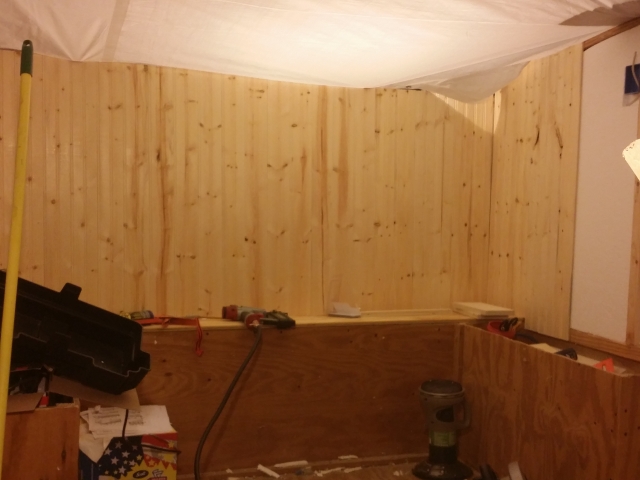

Postby IndyTom » Sun Feb 05, 2017 2:31 pm
Finally something that looks finished. Finally started putting up the paneling on the inside.

Re: My Build Thread - Introducing the Bungalette!!
Postby aggie79 » Mon Feb 06, 2017 7:56 pm
Panelling looks great Tom!
