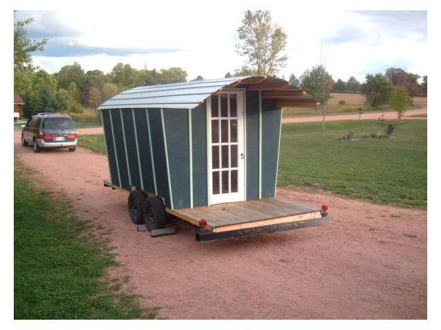

Postby Deryk the Pirate » Sun Sep 30, 2012 2:42 pm
Now here is some ideas Im condidering for my next build, a standie! I like the idea this guy had, but I would lay tarpaper down, then that ice dam on the 2x4's then the metal roofing... add 2" foam on the inside and use strips of wood between the 2x4 rafters on the inside and varnish it all for a nice look!

Postby Deryk the Pirate » Sun Sep 30, 2012 6:19 pm

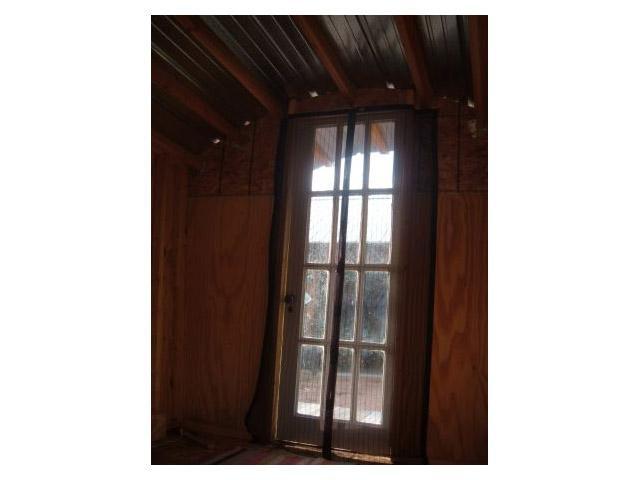

Thanks Becky, I saw it and thought it was interesting...especially the roof. Im not overly keen on the black roof, Im gonna have to get it white or something since it does get warm in there if the sun shines on it.
http://tinyhouselistings.com/gypsy-wagon-for-sale-3/

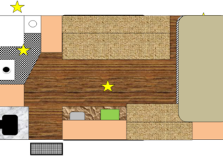

not setted on the design yet, but here is a draft
stars are proposed lights
closkwise from the font
bunk beds on the right
coffee bar right of entry with a sitee joining
wood stove to left of entry
wood storage underneat gun rack
shower, sink and bucket unrinal
closet
couch on far wall which makes into third bunk.

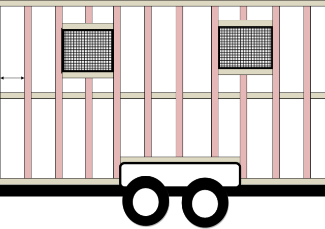

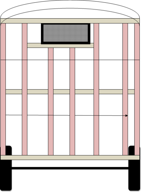

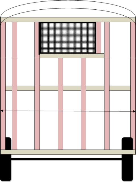

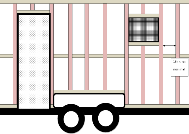

Framing plan
back
rear framing.png (29.03 KiB) Viewed 3107 times
entry side
entry side.png (43.24 KiB) Viewed 3107 times

more framing
far side
left side (2).png (34.94 KiB) Viewed 3107 times

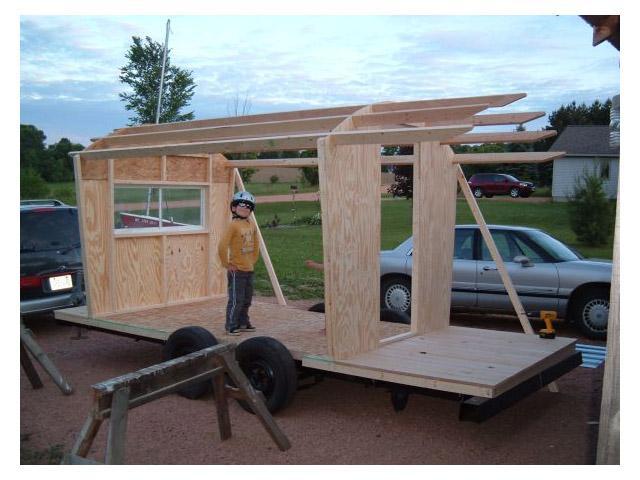

Postby planzman » Fri Oct 12, 2012 11:07 am

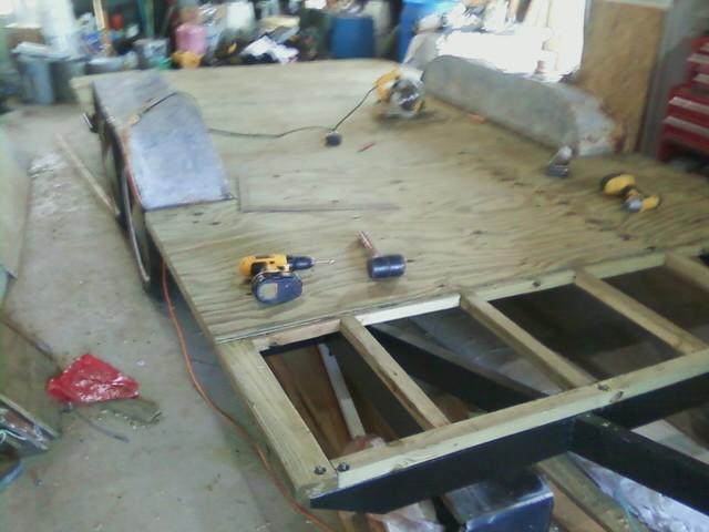

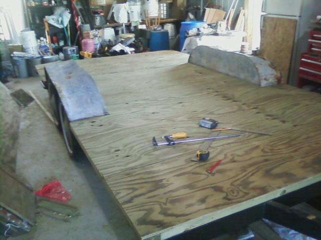

been out of town and got back to work on the hut
got the 1x2's down on the painted frame and started laying in pressure treated subfloor.
almost finished sub floor
half floor.jpg (43.79 KiB) Viewed 2972 times
here it is now all down
finished floor
and started framing

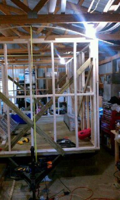

started framing
building camper.jpg (49.75 KiB) Viewed 2972 times
my plan is to lay down stips of 1/2 inch plywood with 1/2 foam insulation and then cover the floor with 1/4 pine plywood to give a non toxic interior floor. will look to either vinyl or wood
hope to finish framing soon and start getting metal for siding and move it out to put roof on.
we are goint to start using it unfished for now, since it is for a deer camper.
we may work on it as the middle of the day is sorta get out of the woods and take a break.

Postby planzman » Wed Oct 17, 2012 6:36 am
more progress

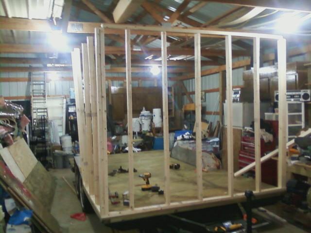

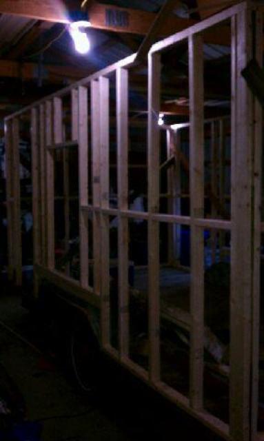

i worked on an off over the weekend and managed to just about finish the rough framing.
My son showed up and we started making every square and plumb.

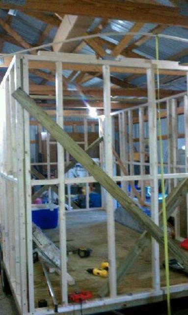

unframed window
I am using a batton to approximate the roof line. (yes my shop rafters are too low, will have to move it outside to finish roof). :shock: My plan is to place a 1/2" sheet of 12" x 96" ply on top of the end wall and trace this arch. then i will put two panels together and cut the curve out. Then i will use this as a pattern to cut same curve on three 2 x 12 8 foot long. I will also cut out arch on under side parrell to the top. Once the arcs are made, i will lay out 5 notchs, 16 inch on center for the perlons to sit in to hold up the roof. I will first lay in 4 sheets of 1/8 luan so as to extend over the sides and ends by several inches. Then 30# builders felt, then 29 guage metal 15 feet long to give me a watertight roof.
but that is another story..... :twisted:
