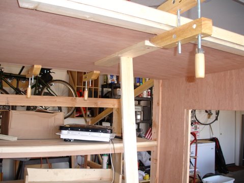

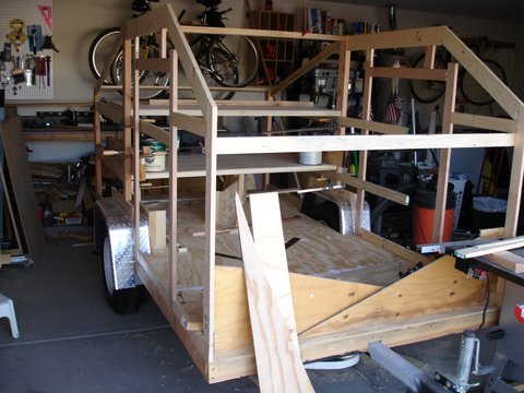

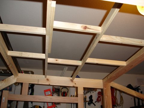

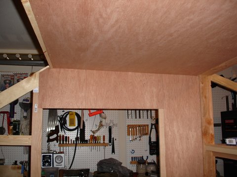

Getting ready for the main section ceiling
Ceiling held in place
Installed!

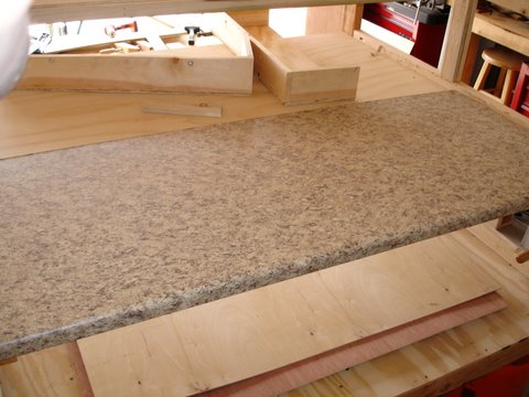

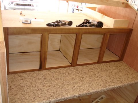

Dry fitting the galley countertop

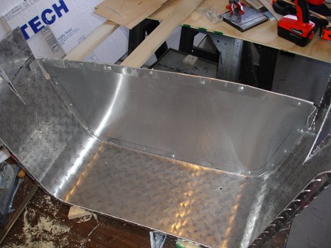

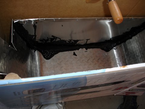

Putting sheet metal inside the fenders
Sealing the seams with TAR!

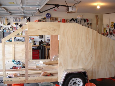

Sunday - last day of my Brother's vist. Going will really get slow now. We've been working 12 hour days for 9 days straight!

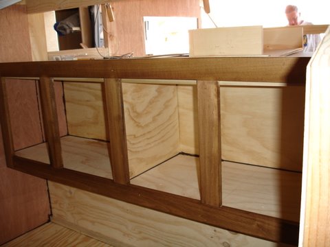

Galley Cabinet faces
Dry fitting countertop -oops! Cabinet faces a bit low. They will have to do!
Beginning to skin

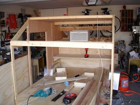

Positioning A/C unit
