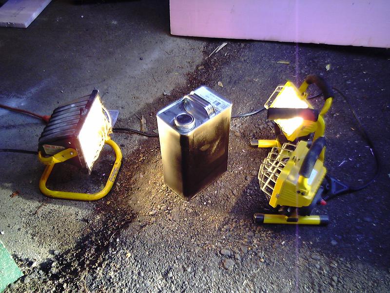

it worked
Postby coal_burner » Wed Sep 10, 2008 9:07 am
The epoxy took about 3 hours to become fully liquid, but it did work.
its amazing how much heat can be thrown off by a thousand watts of halogen lights. The epoxy can is spray painted black to absorbe a little more of the light (they start off silver).
there is now a 2" thick by 6" deep piece of pink foam glued across the front of the bub. the space above it will be filled with pink foam scraps and spray in expanding foam, then sanded down so that i have a 45 degree angle as the leading edge of the top of my camper.
I pondered the math behind just cutting a piece of pink foam to bridge the bowed roof at a 45 degree angle to the flat front window area, but decided that i probably wouldn't have been able to accurately cut all of the angles into the edge of the foam anyway.

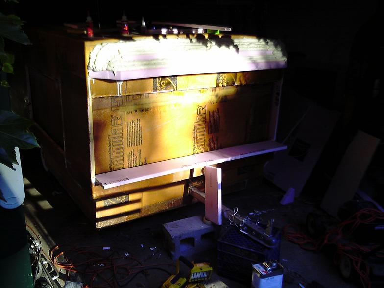

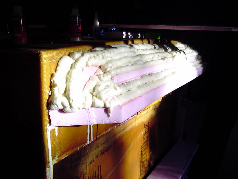

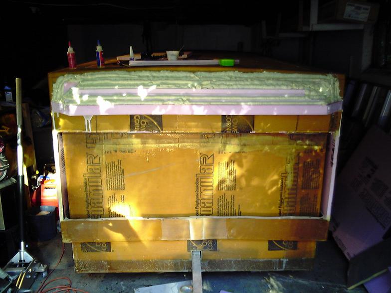

misc. foam scraps were glued into place using a 50/50 mix of 5 minute epoxy and glass micro balloons (the mixture which henceforth shall be referred to as "wet micro").
Exactly one can of spray in expanding foam insulation was sprayed into place, and began expanding.
The next morning, things were a lot more expanded than in these pictures, but the lighting wasn't good enough for a pic.

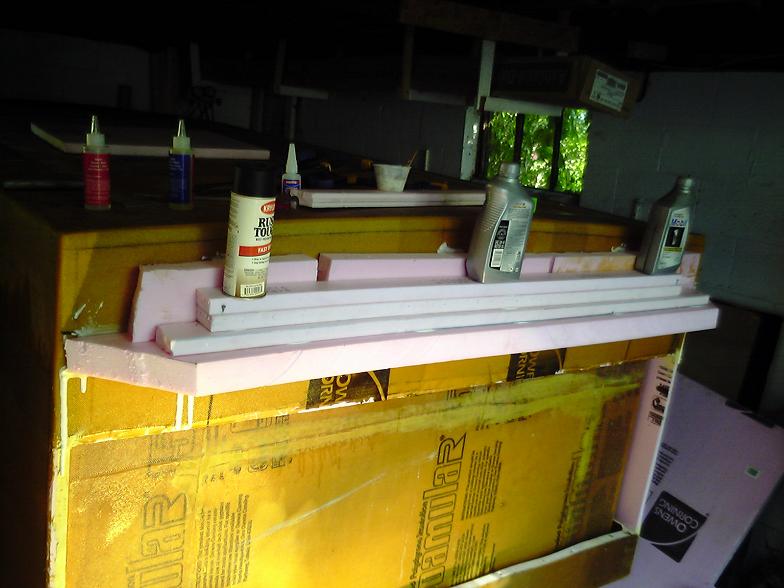

The next step was to start on the bottom portion of the fairing. A piece of 1" thick foam was wet microed into place extending 6" forward of the front wall of the trailer. this will give me a 7" deep shelf at the head of the bed when the sides and window are in place, and should also give me enough room to hang curtains/blinds/window shade/whatever without having to remove them when i lower the top.
I'm making a slight design change. Originally, when the top was lowered, the lower edge of the top was even with the lower edge of the trailer deck. This required a seven inch tall gap to be cut into the cap so that it can be lowered around the tongue. I've now decided to not lower the top completely for towing. It will stop 2" short of the bottom of the camper. This will do 2 things for me. The tongue gap can be reduced to only 3" by 5", which is pretty easy to do structurally, and shouldn't require any gap filling when the top is raised.
Secondly: with a ground clearance of only 8", i am a little worried about the lower edge of the cap having to absorb the full force of a frontal impact with the ground when hitting a pothole while navigating a steep driveway (it could happen). If the top isn't completely lowered, the camper deck will be the thing that makes contact with the ground, and that is so tough that i'm not worried in the least about it. I have some kevlar cloth that i'm going to epoxy into place on the leading edge of the deck just like the fiberglass cloth. This stuff is used by kayakers to prevent abrasions to their boats when they come into contact with boulders, so i think it will be good enough for my purposes. remember also that this camper is going to act as a kind of base camp while canoeing, so it's going to scrape along a lot of submerged rocks while floating down the river.
