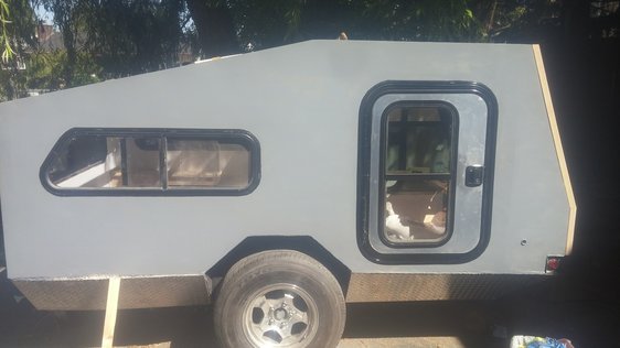

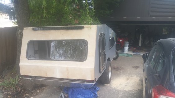

No word from Frank Bear at Vintage Technologies yet, so I went ahead and installed the doors with the wrong sized rings (and I paid extra for the larger ones). The doors look good and function well, so I'm just going to try filling the gap with expanding foam and then see how hard it is to make look good later. I think the trailer looks much better with the doors on.

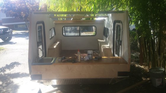

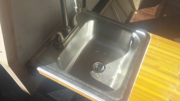

I also installed the kitchen counter and sink. I made a trip to the big box store and bought a bunch of plumbing stuff, among other things. I got the correct drain stuff and drilled a 1.5" hole and ran some ABS pipe out that for the sink drain. I wasn't able to find a rubber p-trap like I wanted, and I'm worried that water in the trap would freeze, so there's no p-trap in the system now. I only wanted it to prevent the draft, so I'll just put a magnetic thing in the sink or something. Maybe I'll make a plug for the exit to keep critters out. I bought the wrong size connector for the supply side, so that'll require another box store visit. But the sink and faucet look good. The tape in the photo will be removed after I finish caulking.

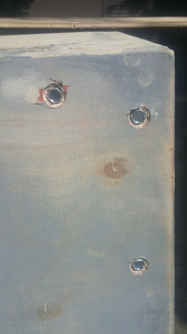

I was still worried about durability, so I picked up some self-drilling 3" bolts and drove a bunch of those in with a nice countersink and then filled the holes. I also ran a tube of interior adhesive as caulk around a bunch of the interior seams to combat draftiness. Hopefully this thing won't rattle apart on it's maiden voyage.

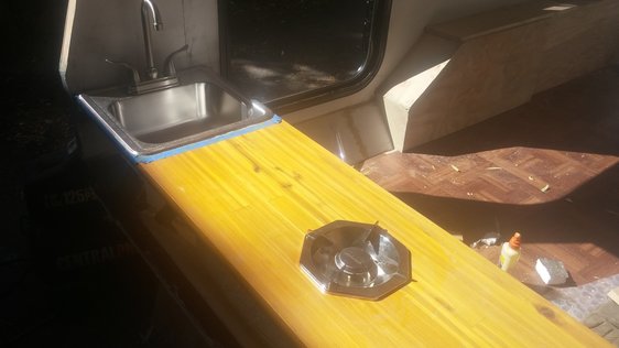

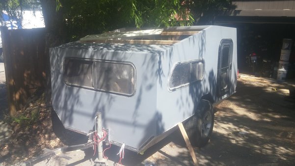

I got maybe four hours of work done on the trailer today. I started by installing the little Coleman stove that my friend gave me a long time ago. It's sitting flush on the counter now, and that probably won't work. The plan is to space it from the counter with 3/4" screw spacers and see if that lights anything afire. Maybe I'll put a diamond plate ring under it. Unfortunately, it looks like you'll need to reach under the counter to adjust the flame. I still haven't decided if I want to run a propane line from the front to the back of the trailer or have a small local bottle back there. It would be nice to put the furnace back there too, so I suppose I'll be welding in some propane line protection soon. But I won't buy that furnace until I start getting paid again.
I also sanded out a few rough spots and cleaned up a bunch of silicone around one window and repainted the entire exterior with topside paint. Another morale booster. Most surfaces have at least two layers now. I'm thinking of spraying a clear coat on them later.
My jigsaw died, and I've been depending on it for a lot of the work, so I took it apart and tinkered with it until it started working again. I think one of the brushes was out of whack.
I cut a long, thin piece of ply to cover the little gap between the front wall and front ceiling and stuck that up there.

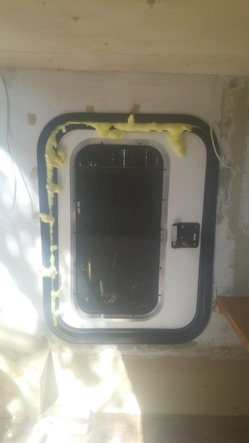

I broke out a can of expanding foam insulation and shot a bunch into the door gaps. I also hit the oddly-shaped area around the sink drain and then filled the gaps between the front diamond plate pieces and the lower frame. I'm going to seal those gaps up with the fiberglass Bondo crap. I'm likely wrong, but I think this thing will be pretty much water-tight below the doors and hatch.
Finally, I roughly cut a piece of rubber pond liner (used, from when I had to rebuild my pond) for the front roof. It was pretty dirty, so I washed it hard with a pressure sprayer and hung it up to dry. The idea is to glue it to the roof and roll the edges around some strips of steel and screw them to the walls.
It's nice seeing visible progress, and that's got me optimistic. The plan is to seal this thing up and keep it nice and solid. Then I can smooth out any rough edges, so to speak, with time later. I think I'll have a hard time NOT working on it and improving it over time. So any little bits that bother me can be fixed right up. I'm creating a whole new house project from scratch here!

I re-caulked all of the windows and doors, this time with lots of tape. Lots of silicone too. I removed the great stuff expanding foam overflow from the door gap. I should have remembered how sticky/messy that stuff is and taped everything up. So that took a while. Oops. But the doors look good inside now. I added the little trim strip to the one door I hadn't put it on yet. I taped up the sink and caulked that and a bunch of other interior stuff too.

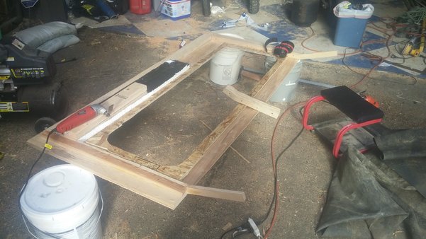

I got some work done on the trailer today. First, I scraped and smoothed the filler I used to fill gaps on either side. Then I cut out some trim strips that will go around the left wheel well. And I connected the cold water part of the faucet. The water works well and has nice volume, but there's a small leak where the hose attaches to the "bulkhead."
Then I finally started on the rear hatch. The photo doesn't show much, but this took a couple of hours at least. It's got some insulation, an opening for the window, side supports for the bottom of the hatch, and I've got additional supports for the bottom part ready to go. I think it will work out. And I finally found some weather stripping that I'm happy with

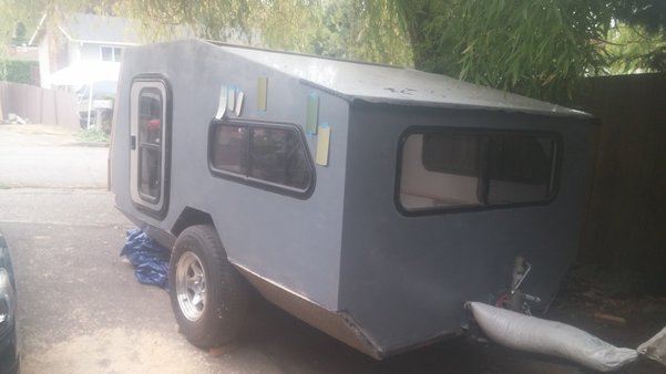

The trailer was still in the garage while it rained yesterday. I pulled it out later when it was sunny. As you can see in the photo, it's a little messy and cramped in there.
I actually managed to hang the rear hatch. It's pretty heavy even though it isn't finished, so that was difficult alone. The screws through the hinge into the door were too long and bound up the door, even though I had taped brad shafts to the top seam to keep the gap perfect. So I pulled those out and used the leftover screws from the door kits. I've only got about 1/3 of the screws in, but everything works well. So I'm pretty confident the door will be solid with all the screws in once I buy some shorter ones. The gap for the weather seal is good enough but not as tight as I'd like. Maybe paint, etc. will fill that up. For what it's worth, two layers of rubber will cover the hinge.
I cut the rubber front roof coating down to the final size and glued that down. I had sanded it with 100 grit on the power sander first to make sure it stuck well. Then I stacked sandbags and lumber on top to get it to flatten as much as possible. The rubber needs to be in place before I put the plexiglass down, because the plexiglass will sandwich the rubber down. So I need to get the rear roof rubber installed soon. Meanwhile, I installed the now-finished roof rafters and pounded them flush with a rubber hammer. I filled the little gaps around them with wood filler.
Jumping ahead, I also cut out the plexiglass to the final dimensions and pre-drilled all of the oversized installation holes. I also pre-drilled the holes into the lumber that I had installed earlier in the day. The white plastic coating is still on the plexiglass, which is good, because I've been moving it back and forth a lot to prepare the mating surfaces, drill holes, etc.
I planed down the lumber that framed out the hatch hinge that stuck out above the roof line due to the funky angle. There was a hideous gap in the roof above the rear hatch, so I covered that from the inside with plywood, filled it with insulation, and capped it off with wood filler. Not pretty, but I think it'll do after being smoothed out and covered in topside paint and rubber. I filled a bunch of screw holes and seams on the back hatch too, after I'd applied more plywood to it. I've been using brads lately (in combination with lots of glue, of course), so I've been filling those holes too.

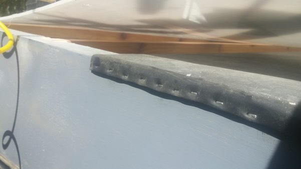

I only put in about four hours today. I folded up a rubber seam on the side of the front roof and stapled it to the side. I folded it under and put adhesive silicone sealant under it so the water can't wick under. When I was done, I put more silicone over the staples. I was low on staples, so this was only a proof of concept. I think it looks fine enough.

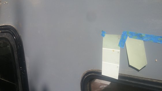

We also grabbed some color swatches for ideas about exterior color (not all shown here), and I taped them to the exterior. I'm liking the somewhat darker of the light greens.

For final color, I'm thinking of something between the right-most two.
