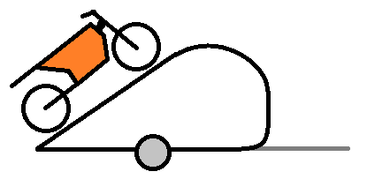

If my fiancee hadn't wanted a standie, I would have built a drive-on-top toy hauler / teardrop trailer to haul our scooters with on vacation. I lost the sketchup, but the basic concept is this:
The sketchup drawing I had made used the HF trailer, and had trays to carry 2 scooters on the top (made the drawing before I dirt biked).
Alternatively, you could build a conventional teardrop slightly moved back on the HF frame, with a platform on the front of the trailer for your bike. Think like the Little Guy 5' Platform:
