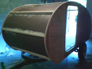

Hey everybody... it's been six month or so since my last visit... Just wanted to let you know that I didn't give up even if I don't have a lot of time to work on my teardrop... today i've just mounted the walls on the chassis with the help of my friend... BIIIIIIIIIIIg day... I hope you're all well and had a lot of fun camping with your ttt this summer...

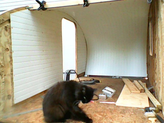

Today I was off so I've installed all the cross members and gave a try to the inner panel/headliner...
Then took off the panel and pre-drilled it to match the cross members
I've cursed a hundreds times about those 2x2 that I bought at Home Depot and are everything but straight...
Someone knows where to buy 2x2s that don't look like a 90 y/o guy spine ?

Clear grain select cedar ripped from 2x10 x 10ft. Pretty steep cost wise, but nearly 100% yield and you get to use what you pay for with pleasure. Local lumber yard.

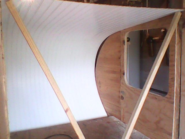

Inner panel screwed and glued... now is starts to look like a Teardrop... :D

Crazy Frenchy wrote:Inner panel screwed and glued... now is starts to look like a Teardrop... :D
Yes, it does....nicely shaped one, too!

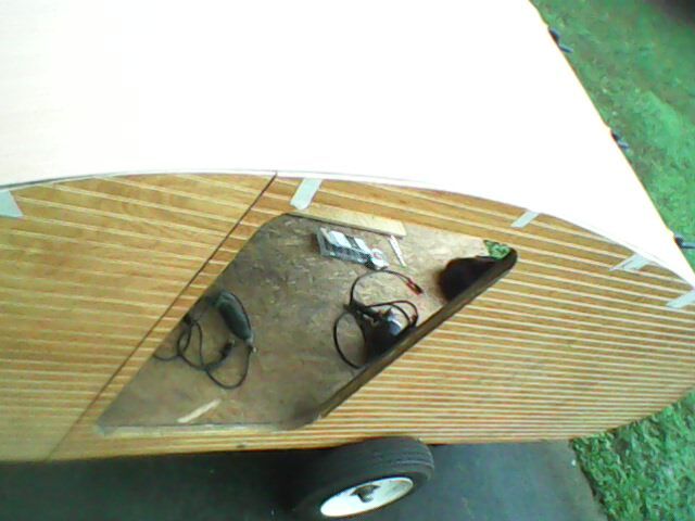

The week end has been busy...
One inner wall down... one more to go...
I gave the outer roof skin a try...
I've started to get paranoid about moisture so i've coated everything with penetrating sealant... Inside and out...
I'm not sure it's that a good idea though... When moisture is trapped in an enclosed space it has to go somewhere... What do you think guys ?

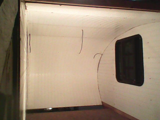

Inner right wall on, electric cables for lights and roof vent fan on, first window on...
I doubt that extra sealant will hurt anything and it could keep delamination at bay. I did a little of that in some places, too. However, hopefully, you'll have your teardrop sealed well and it won't get moisture between the walls.
