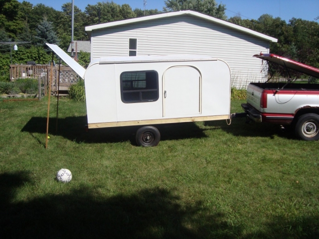

Here we are ready for our first outing. I don't have any struts to hold the hatch open so am just using some pieces of wood. In fact, I didn't even have locks on the hatch so I just screwed a piece of wood over it to keep it shut. We had a great time and it was very comfortable.

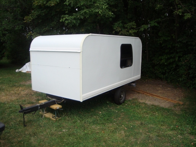

Here is a nice view of the front side:

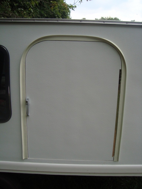

Here is an closer look at the door. I used some garage door molding around the outside (and along the roof and corners) and glued it on with contact cement. It seems to work very well and is very very flexible. ($18 for a 30ft. roll)

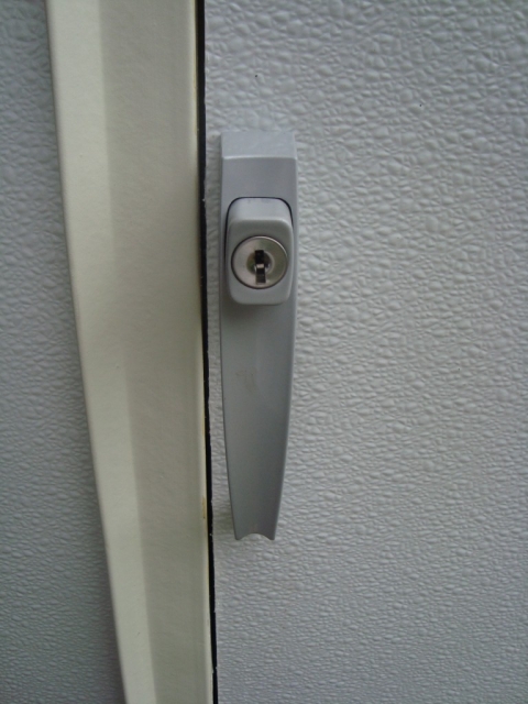

Here is the door handle I got for $11. I was excited that it had a key for it. The door was a little too thick but I easily modified the mechanism. There is a pin that moves when you push the handle. It just needed to be a bit longer so I fashioned a new one out of a big cotter pin I had in my junk box. Works great!

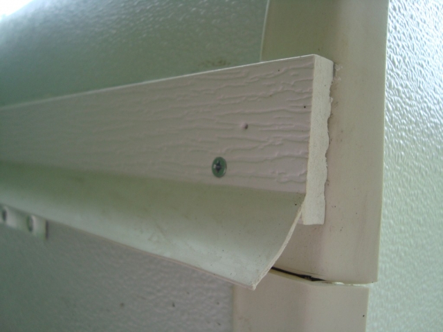

Here is the molding that I used over the hatch and front window. It is another type of garage door molding that has a nice flexible piece of vinyl on the bottom. I used a piano hinge instead of a hurricane hinge and figured this would keep the water out. You can also see the other molding that I used on the corners.
