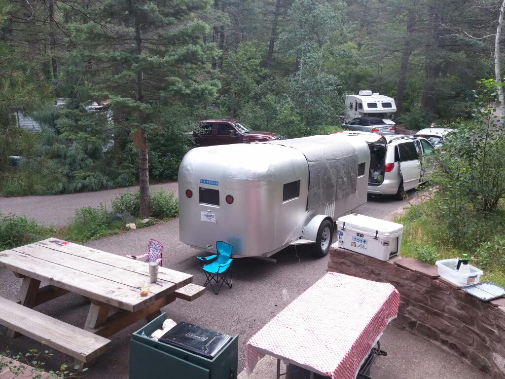

Here is our campsite in Santa fe national forest.

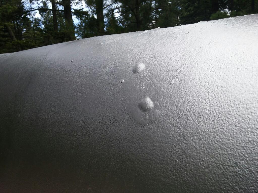

And this morning....the dreaded bubbles!

Ack - the bubble monster has struck again !!! Mine got hit and it hasn't even been out of the garage yet ... :oops:
You can ask around & see if anyone brought an iron with them :R
Looks like a really nice campground. Enjoy your trip, the bubble problem is a pain in the butt tho fixable.

Have we come to the conclusion that the bubble issue is from adding the outer paint too soon, without letting the glue coat cure well?
On the bulging corners, maybe you can strip the canvas off of those areas and sand back to round; let it sit (maybe even spritz it with a mist of water from time to time) to be sure that it is done reacting and has fully kicked. Just sort of spit balling here.

KCStudly wrote:Have we come to the conclusion that the bubble issue is from adding the outer pint too soon, without letting the glue coat cure well?
Seems to me that is one contributor but also poor adhesion to start with caused by failure to sand, oils on surface, missed glue, dried glue, and others.
The bubbles can be repaired by Ironing (heating through a wet towel enough to re-liquify the TB II, or squirting in thinned TB II with a syringe device, or slicing with a razor and doing the sand & reglue thing, etc. It's sometimes easier to just remove the small canvas segment with a razor and redo it properly with finishing using normal dry-wall-repair-techniques to make the patch job invisible.

Pretty minor issues realy considering your build speed.
As KC said you could attack those corners with a belt sander or something and make sure they've stopped "growing" before you recover it.

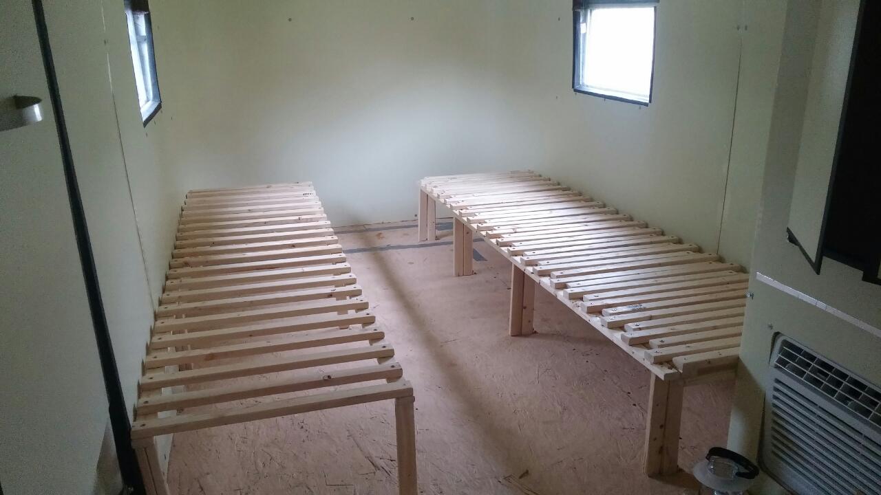

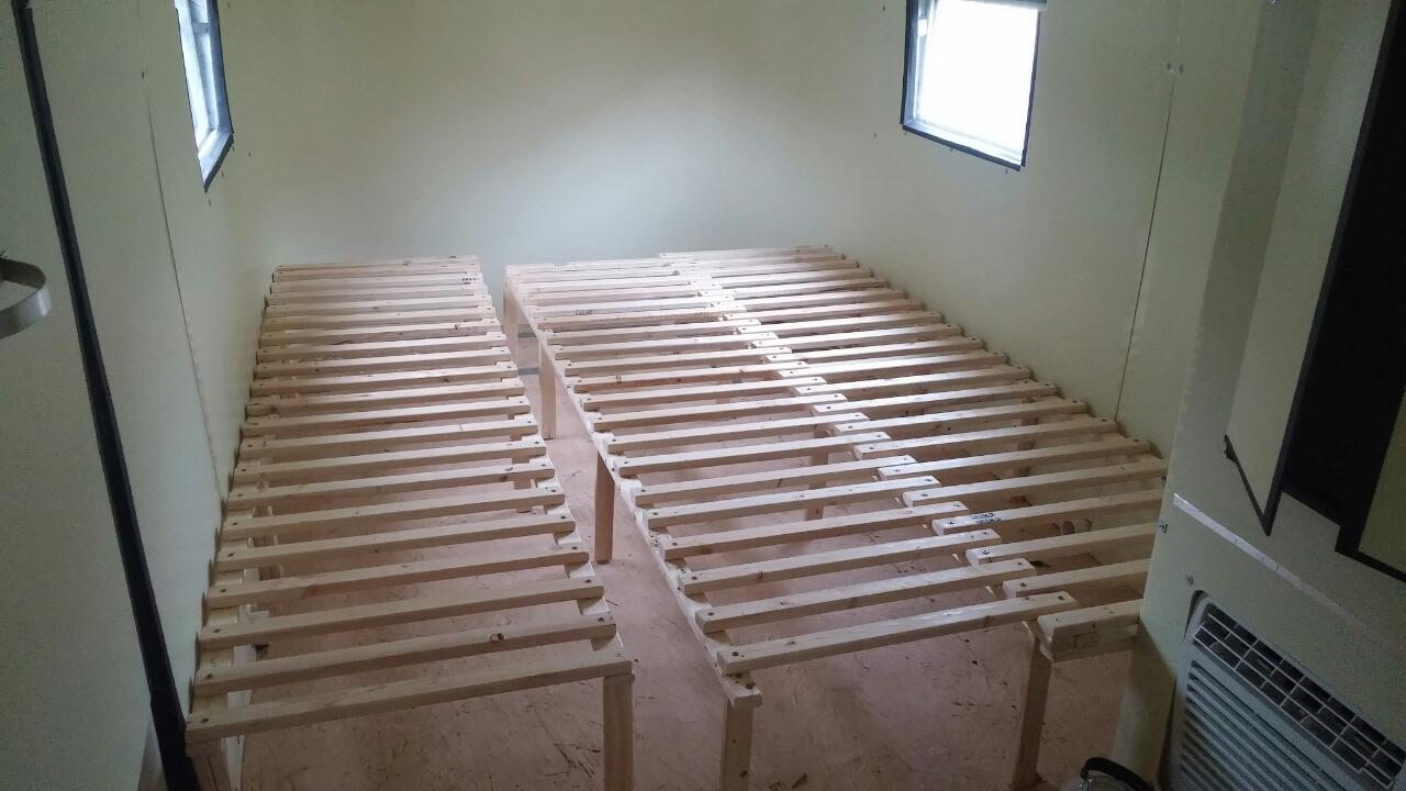

I got some work done on the bed platform. I'm using the "slat drawer" bench seat design. The two sides didn't line up on my first try. It will look better next time I take a picture
