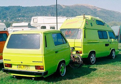

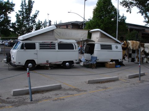

I got this design in mind but my concern is Weight. Any suggestions for saving weight thru design or materials please leave a comment. I'm shooting for around a static weight of 600lbs. Crazy?
Well here it is and yes I'll pull it with a VW Bug.
Or
I like the Poptop but for now I'm thinkin bout keeping it simple. We'll see this might happen.
Basic dimensions are, 64"w, 102" or so Long, height yet to be determined. Wanting to use a Queen air mattress to sleep on. Foam mattress wouldn't work, would like to use inside for more than just sleeping.
It has a Bus shape that is cut down below the belt in the middle. I'm considering F/G over foam. MDF around the doors for strength and attachment. Also MDF for the wall between Cabin and Galley. I spent most of the day Sunday looking at F/G techniques which will be easiest for me and cheaper to do. If I do the F/G over foam I'll use 3 layers of glass, 10oz, 10oz ans 4oz fabric. On the inside I'll just place a heavy layer of F/G mat. Mat is pulled apart glass strands. The inside will have panels that will cover the glass. I need strength in the sides but keep it lite. I'll need to go to my friends house and make some profiles of the Bus so I can cut out the Foam in the shape that I want. I'll make two MDF profile gigs that I'll stand the foam in to cut with a hot knife wire. I'll have to make one of those also. Glue all the foam together being careful to not miss align the profiles, then cover with glass. Sounds simple I just hope that it is lite. I think I'll make different sections and bolt them together. Sides, Corners, Front and roof.
