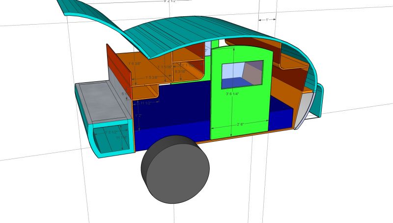

The design
A shrunk Grumman 2. (9'2" length).
63" outside width.
"A" frame trailer.
2K axle w/ standard springs.
750 lbs, dry weight.

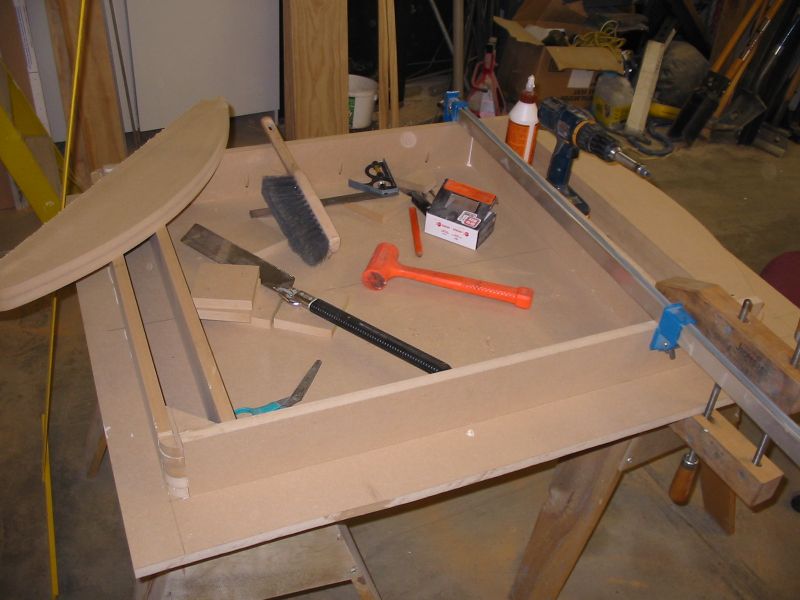

Step one, making a "buck" of the door, so I can make a mold, so I can make parts.

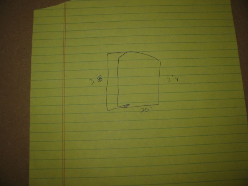

Door design:
Is really is symmetrical...I just made a quick sketch for the measurements.

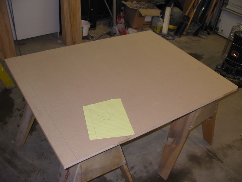

3/4" MDF base:
Sides and bottom:

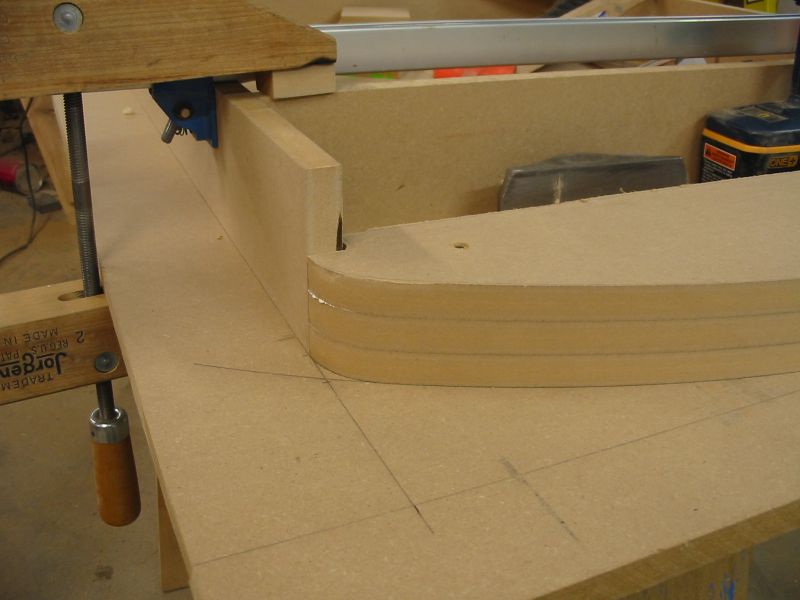

Top arch, MDF stacked to make the curve:

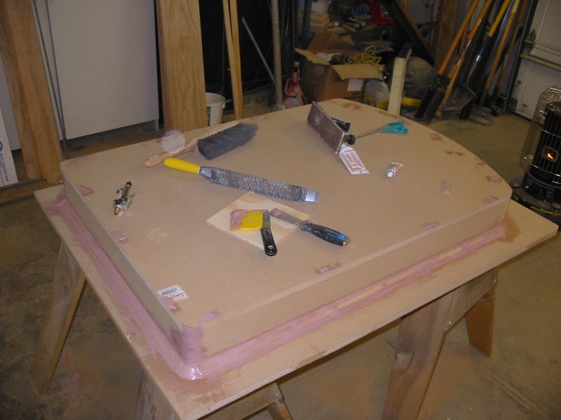

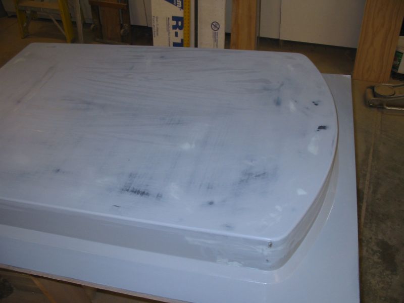

This is the face skin, so Bondo and sanding is the name of the game.
High fill primer and more Bondo:

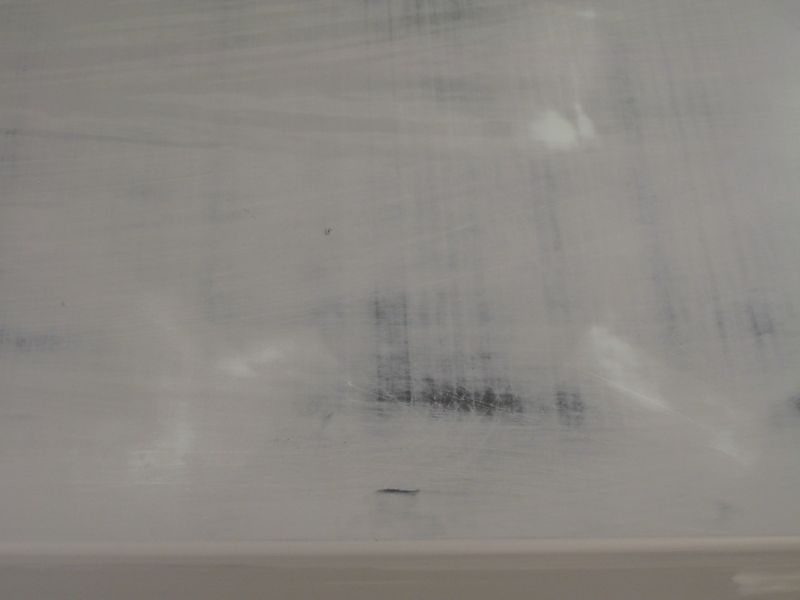

MDF is not perfectly flat.....wet sanded with a long board.....look at the ridges that show up:
Wet sanded 800 grit:
(is was still a little wet, the marks at the top of the picture are not scratches)

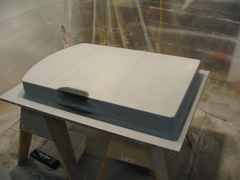

Postby RockyMountainTeardrops » Tue Feb 01, 2011 7:56 pm
*cough, cough*
Mental note...get new filters for the respirator....
Thanks for the ideas Andrew & VTX!

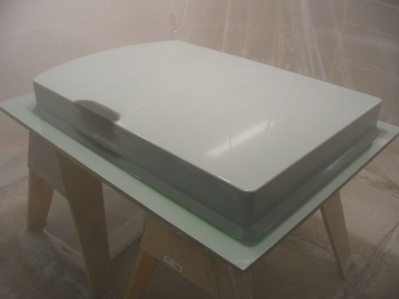

I decided to go with the high build primer.
Three coats.
Sand it through the grits tomorrow.

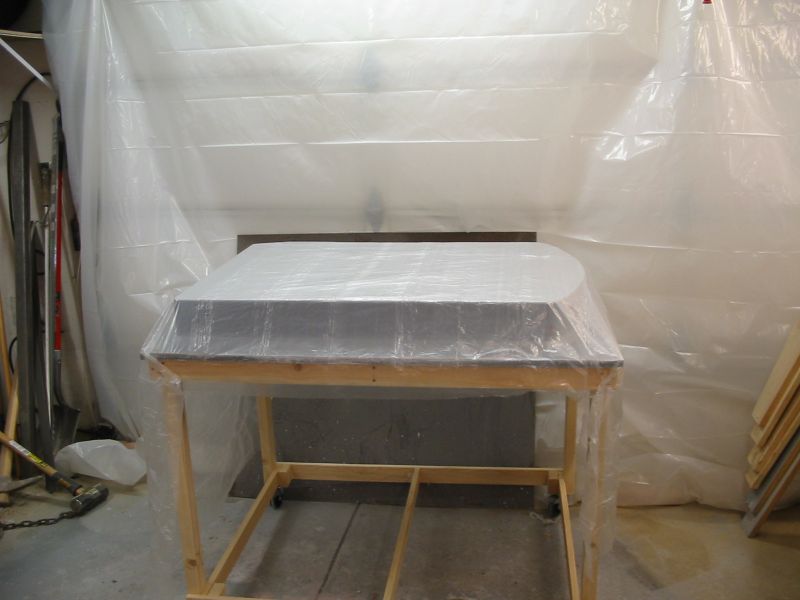

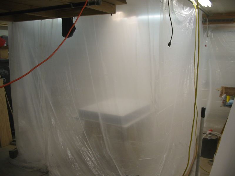

Quicky paintbooth:

Postby RockyMountainTeardrops » Wed Feb 02, 2011 9:17 pm

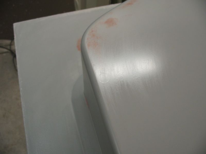

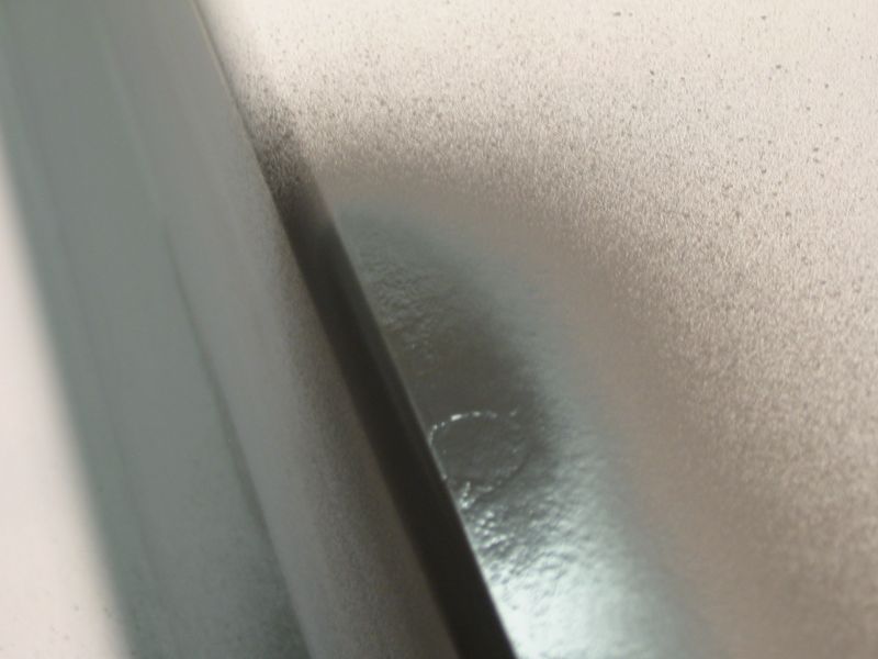

Sanded through the grits today, 180, 220, 500, 800, 1,000, 1,200 then automotive polishing compound.
Sanded too deep along one side, thought it was going to be okay, but I could feel the roughness when I was waxing the plug.....had to clean the wax and do a touch-up. :x
Strangely....you can see the screw head still, but I couldn't feel it (before painting).....I think it just sucked the paint dry.
More sanding...fun, fun.

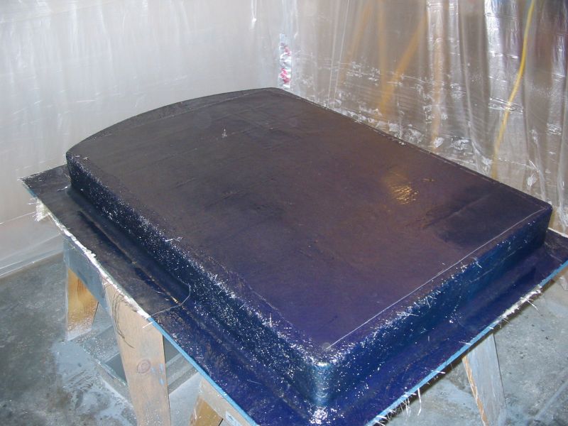

Since I can't keep the temp in the garage above 60° overnight....the resin didn't kick, and it softened and lifted the gel-coat.
Need to re-think how I'm going to deal with the temp issue.
I may have to buy a furnace... :(
(More money that I don't want to spend.)

Postby angib » Sat Feb 05, 2011 10:58 am
I haven't seen that sort of failure before - what is the light blue colour?
You have already set up a 'tent' around your mould/workpiece so a domestic fan heater should be able to heat that space adequately to get the resin to kick (assuming you're using polyester resin).
One trick that I have seen used when polyester resin hasn't cured overnight is to warmit up if possible and then coat it with a layer of glass in 'hot mix' resin (that is, resin with three or four times the normal amount of catalyst). This will get really hot as it cures fast and that heat will often trigger the layers below to cure too - once they start curing, they will develop their own heat to cure fully.
Of course if you do a hot mix, you need to apply it to the job in a few minutes or less, as it will kick off really fast!

Postby RockyMountainTeardrops » Sat Feb 05, 2011 11:44 am
I used two coats of black tooling gel-coat and one coat of blue regular gel-coat (I ran out of black due to a miscalculation of the quantities).
Electric heater I assume?
Styrene vapor is flammable...
I should have known better, the blue top coat had not kicked quite all the way (not sticky, but not hard either).
I was worried about leaving it overnight without a layer of reinforcement, so I put the fabric on it sooner than I should of, then compounded the problem by opening a window to try to air out the garage.
Lee

Postby RockyMountainTeardrops » Sat Feb 05, 2011 12:59 pm
Well, the good news is it looks like I can save the plug.
The bad news is the surface finish is trashed.....so it's back to high build primer and sanding again.
*sigh* :disappointed:

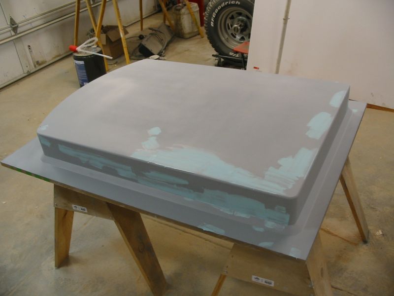

Postby RockyMountainTeardrops » Thu Feb 10, 2011 12:47 pm
Ugh......
Screw heads are shrinking and showing.
The cold weather is killing me.
I bought an electric heater (thanks for the idea Tom), so I can keep the temp over 60°.....but I think it's still too cold and it's taking days for the primer and body putty to finish curing and/or out-gassing, and it's causing issues with the surface.
At this point I think I'm going to put the painting and fiberglass molding on hold until I can get more heat 24/7.
I'm going to start the plug for the hatch, and after that.....I guess I'll start the bucks for the body.

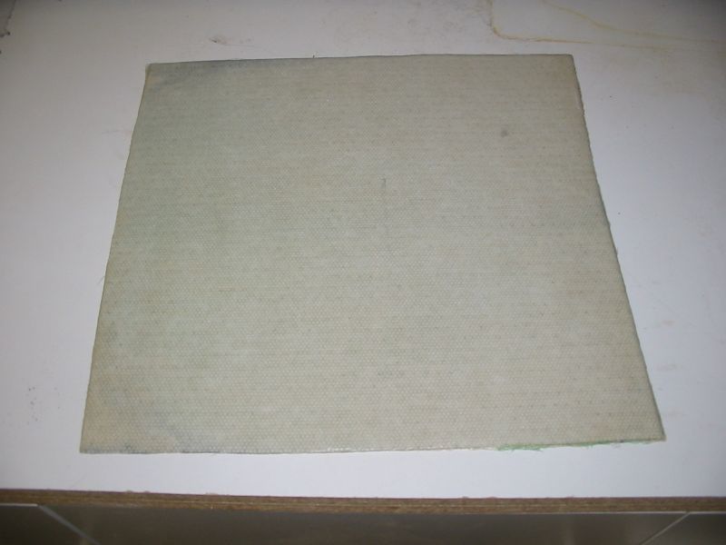

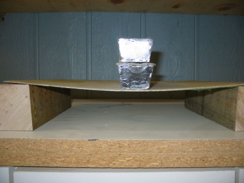

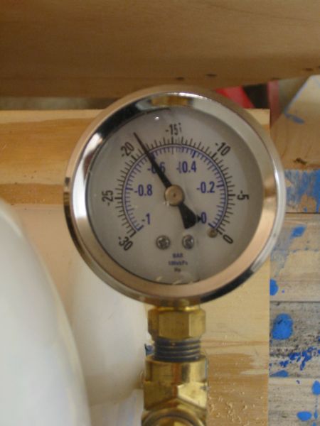

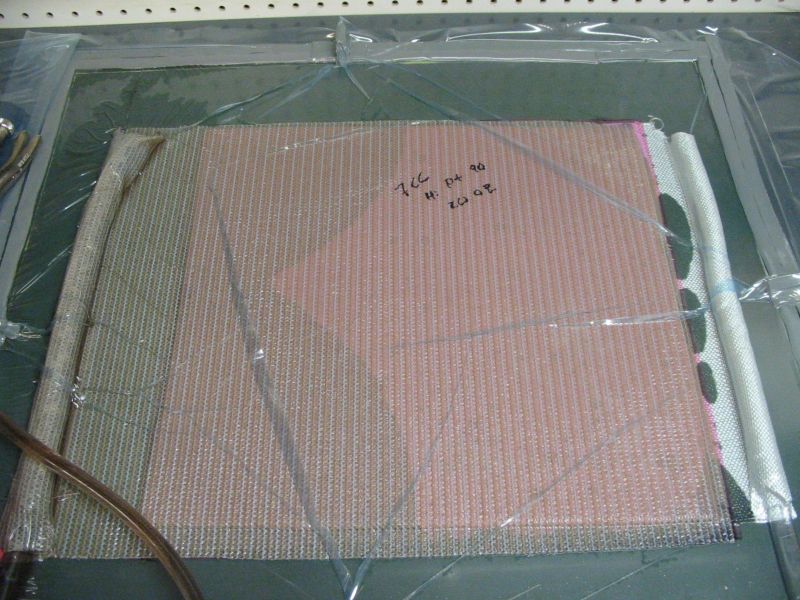

Here's some shots of an infusion test I did a while ago.
9,200 ft of altitude doesn't get as much vacuum as sea level....
Resin front at 11min 26 sec
Finished part.
4 layers of 10oz woven (two each side), 2mm Coremat.
15 lbs concentrated load at 12" supports.
3/8" deflection.
This part is pretty strong and is only 8.2 oz/sqft
That calculates to the outside skin of the entire camper at only 63 lbs!
Of course the floor will have to be stronger/heavier.....but that's a pretty good start.

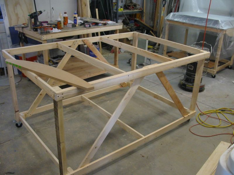

After reading about the tooling for the Dart (for the fourth time) at Left Coast, I decided to start building carts and putting everything on wheels.
(They mentioned putting everything on wheels on their blog)
Quick trip to HFT and HD for supplies...
Tools, clamps, and anything else to be stored underneath, and the top for for a working area.
Door plug on a cart.
Cart for the hatch.
Anybody have any pictures of their workbench carts?
I'm looking for ideas on how to add shelves or bins or...something underneath.
Lee
