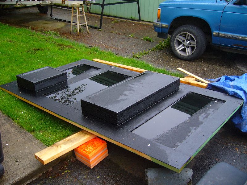

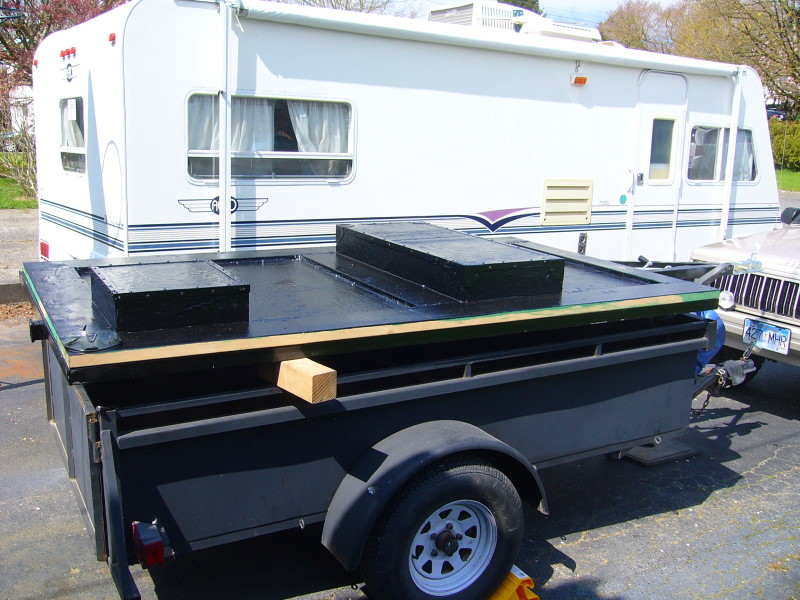

The base frame work for the "shell" to attach too is made of 2x6 pine boards with rabbits to allow the floor to drop into. I chose these dimensions because it allowed me to have plenty of wood to screw too as well as being able to use just one sheet of plywood for the floor. All pieces where glued with polyurethane construction glue screwed together and treated with a wood preservative to prevent any chance of rot. The belly of the floor is coated with the black roofing goop as well sealed with flashing caulking at the seams. You can see it up side down, it was caught in the rain and it actually held the rain on it.

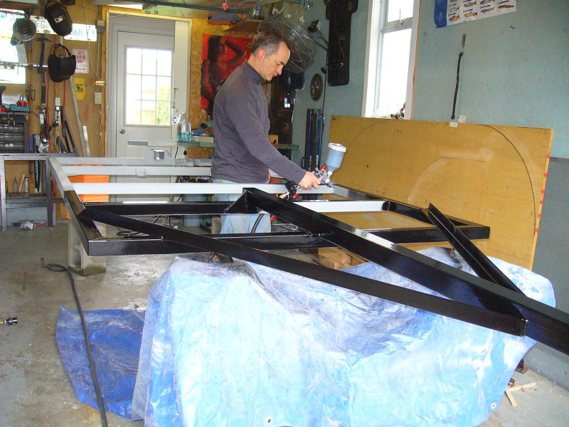

I painted the frame with an HVLP spray gun. Here you can see the added brackets and reciever hitch, but not the added support to the tongue. I'll have to take another shot to show what it was I did there.

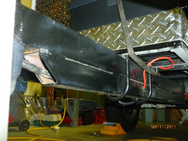

Here is a picture of the bottom of the tongue bar with the added bar welded on. It added about 8 lbs. For peice of mind it is worth the weight.

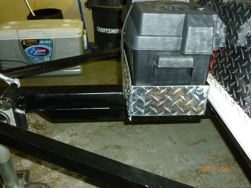

Here you can also see the way I mounted the battery box. I made this box with 1 1/2" angle and covered with Diamond plate Aluminum. I used u-bolts to attach the battery box, so I can remove it easily when I eventually get a diamond plate storeage box. (too much money for now)
The 7pin cord and 12v battery wire run through the added bar for extra protection.
