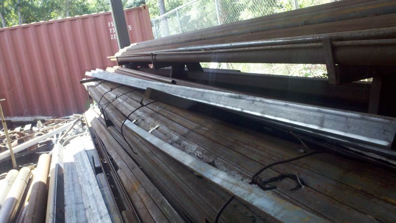

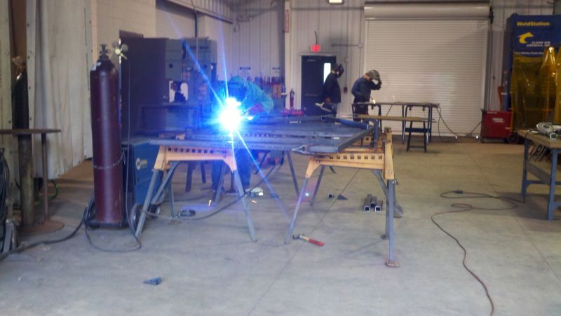

The build starts tomorrow. I won't be making sawdust, but I will be making sparks with the frame. I work at a Technical College in Georgia that has welding instruction. I called the instructor and asked about side projects. He asked what kind of side project. When I told him I wanted to build a teardrop camper, he couldn't believe it. :eyebrows2: He told me he already had his steel purchased, and would be starting his own build this winter. Well, I ordered my steel and it was delivered today. With Scott's help, I should have a frame tomorrow. I ordered a Flexiride axle yesterday and it will ship on Thursday. :worship: I can't wait.

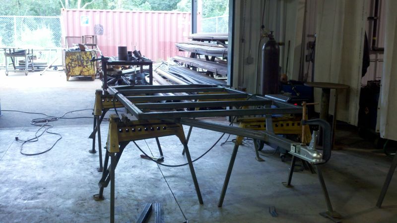

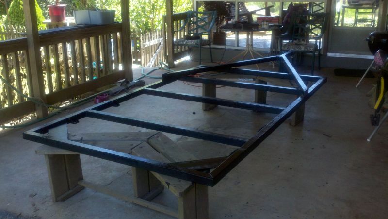

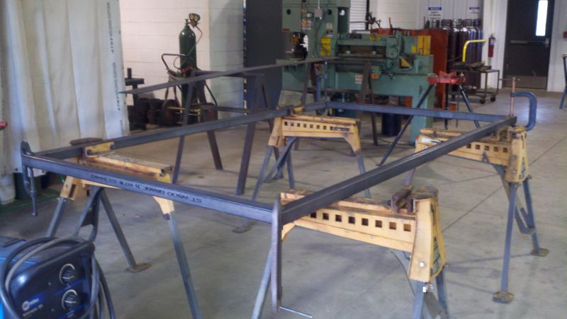

Well, I finally got started yesterday. I met Scott at his campus and we figured out our game plan and went to work.
It didn't take too long to get things squared up and for the sparks to fly.
The frame is 59" X 104 3/4". I borrowed a good bit from DMcCam. (Dave, does this frame look a little familiar?) A little bit wider than Dave's, though. I ordered a Flexiride torsion axle for it . The width for the axle mount is 59". The tube for that length is usually 60". After talking to Les at Trailerpart.com in Texas, he recommended a 61" tube. He was very helpful. That will give me an extra half inch for clearance at the wall and torsion axle. I learned from Tom about that. I had the axle derated from 2000# to 1500#. I learned that from just about everyone that has used a torsion axle.

Bob the frame looks great and your on your way! Sorry to hear about your wife and tomorrow will be the worst as all the bruises she got will be making themselves known and her ankle (been there with bvoth of mine at different times) will be throbing. My wife tripped in my garage and cut 2 of her fingers to the bone, and she is doing fine. Work on it when you can thats all most of us can do and we're all used to it :lol:. Good luck and let us know if you need anything.

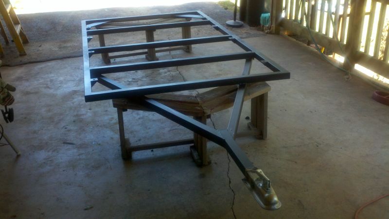

I did get to do a little bit today. :twisted: I ground down the welds and made it all smooth, then got out some flat black Rust-o-leum. It rolls on pretty easy.
Two coats later.................
A pretty good days work when I didn't think I'd get to do anything at all.

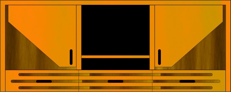

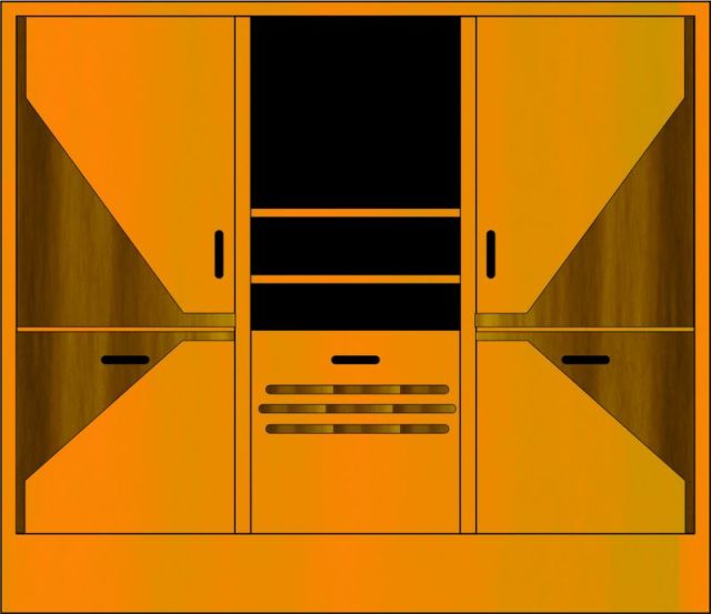

I played around with the design of the interior cabinets. They are not to scale, but close enough to get an idea what they could look like.
Aft cabinets
Headboard cabinets.

Postby DMcCam » Mon Sep 12, 2011 4:43 pm
Yes sir, I've been using CorelDraw since 1.0! You can use it much like AutoCad if you use the grids to keep things on scale. I actually drew my plans on 1"=1' scale and made both vertical and horizontal rulers. I could then just grab one to see how things were shaping up. The more you stay to a scale the less re-do's you'll need.
Your design looks very cool! My only thought is to remind you to check clearance on all views. It looks big enough on paper but when you get it full size it can look very different. I ended using a tape measure constantly to answer space questions like, 'will my knees hit that, is there enough room for my hand to actually grab something in there or is this enough space for all our clothes?' I made a few full size cardboard boxes to envision spaces and to place the intended items into.
Other than that, forge ahead good sir!
