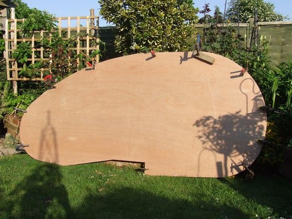

I planned on building a teardrop over the winter, but time and finances got in the way, then my daughter Charlotte decided that she wanted one, as I have 2 weeks looking after my parents house and putting in a decking for them, I thought I might just fit in a teardrop build as well.
She hasn't got a very big budget and a small towcar, so we decided on small and simple and after seeing the Pico Light on angib's site (thanks for you excellent plans) we decided that was the way forward.

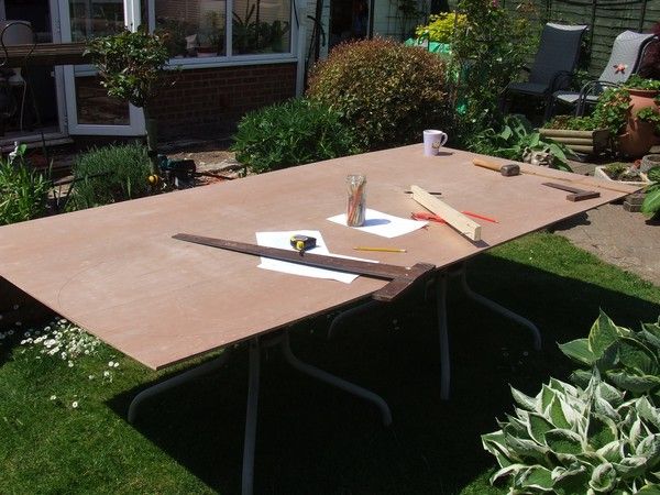

Well things started the outline was drawn, I layed in the outline no problem, Charlotte layed in the outline no problem then came her boyfreind Pete it looked a little tight for him, so we decided that if we added 380mm to the length it would give him more than enough room and a flat section of roof for an roof vent which would make my life easier, also means I have enough room to use some 10' Mini wheels I have, so outline redrawn, axle position moved forward 190mm, (whilst writing that I've realised that's probably not quite right as it changes the 60/40 ratio) anyway out with the jigsaw and this is what we have.

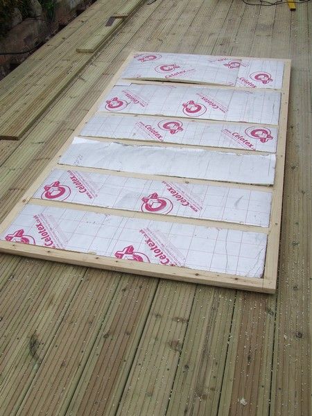

Have got a bit more done, made the floor, slightly different to the original design, I have sandwiched Celotex between 2 sheets of 5.5mm (1/4')ply. Had some fun with the Celotex it was 25mm (1') and I have used 25mm prepared baton which of course less than 25mm so had to slice a few mm of the Celotex :oops: .
The weight of the floor came out at 22 kg (48lbs), as its going to be the heaviest panel this trailer should come out lightweight :)

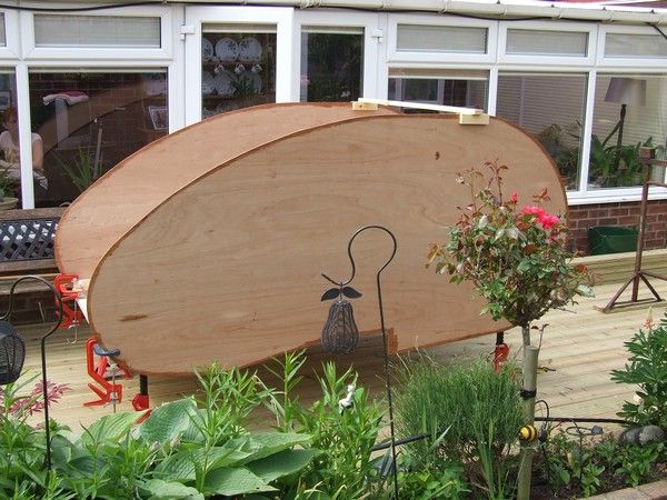

Today I Epoxy resined all the edges of the side walls and floor, never used it before and was alarmed at the price, but am now convinced thats the way to seal everything. Dry fitted the side walls so I could see where I needed too shape the end profile of the floor, which I did, then decided to add another baton on top of the floor to put back the strength I had taken away and shaped the second one, pleased i did this as I now have much larger surface area at when I come to fit the roof sheets.

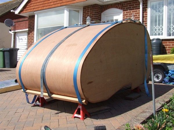

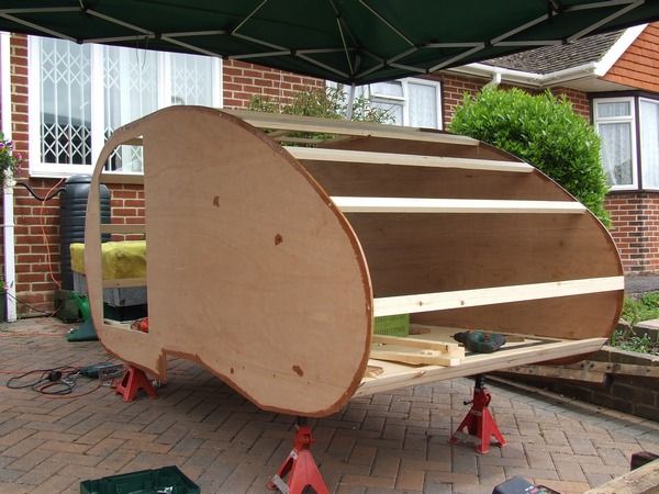

Postby Chess » Wed Jun 06, 2012 2:17 pm
Bit more work done sides now attached, roof spars added and the door opening has been cutout.

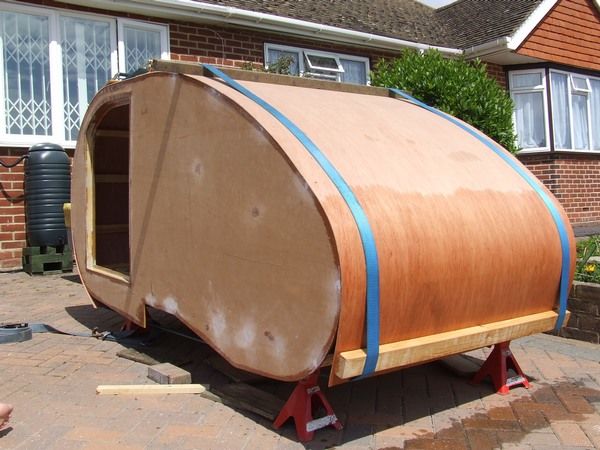

Postby Chess » Fri Jun 29, 2012 6:24 pm
Well things are progressing, we had a small disaster in windy weather teardrop bodies are light enough to blow off axle stands , finished up with a couple of punctures in the floor and the side scraped down an old screw filled decking beam that was in a pile to go to the tip. :oops:
On a positive side the door has been fitted but I removed it before taking photos and the roof has been added, was a bit tricky but having done one the next one will be easier :D

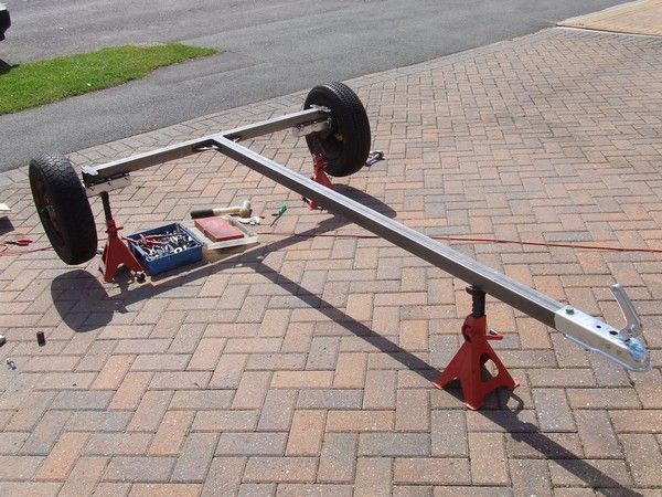

Postby Chess » Wed Jul 04, 2012 4:40 am
synaps3 wrote:What are you using for your chassis? I didn't see a picture of it.
That's because it doesn't exist yet, but after the disaster of it blowing off the axle stands I will build the next one on a chassis!!
It will be a simple A or T frame using 350kgs (770lbs) rubber suspension units like these Image
something I don't see you Americans using a lot as most of your trailers have axles and leaf springs. Hopefully will order these at the end of the week.

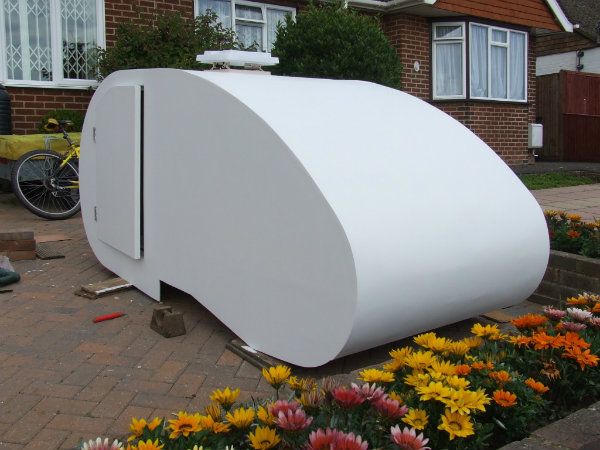

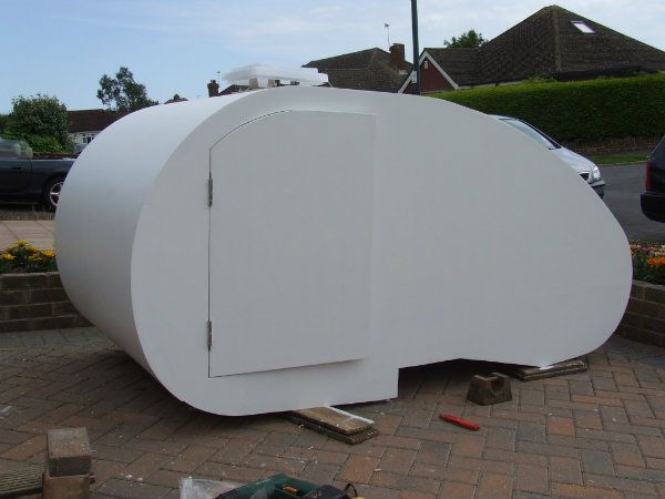

Postby Chess » Sat Jul 21, 2012 10:30 am
Never ever try and build a teardrop outside in the UK even when its supposed to summer, I seem to have spent the last few weeks trying to keep the teardrop dry or repairing water damage or collecting the remains of my gazebo from neighbouring gardens. :x
But progress has been made and the body is ready for the chassis which should be ready in the next day or two.

Postby crumbruiser » Sat Jul 21, 2012 10:39 am
The body looks very nice. :applause: Can you tell us about the roof vent? I've never seen one like that.

Postby Chess » Sat Jul 21, 2012 1:04 pm
crumbruiser wrote:The body looks very nice. :applause: Can you tell us about the roof vent?
Thanks, the roof vent is just a cheap replacement unit available from most caravan/motorhome places in the UK, it permantly vents and can be popped up for extra ventilation http://www.leisureshopdirect.com/caravan/home/product_20395/mpk_rooflight_290_(280mm_square).aspx

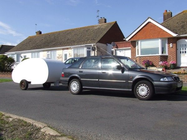

Postby Chess » Sat Jul 28, 2012 1:48 pm

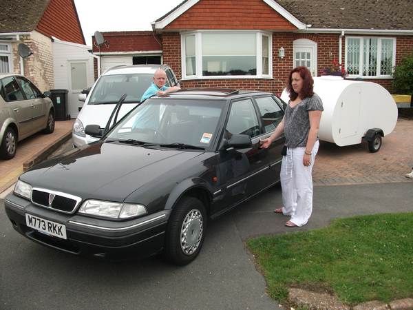

We have a chassis
and some wheels and suspension
and we put it behind the car too see how it looks
Just need mudgaurds and its useable then we just need to add some luxuries like windows etc. As it stands at the moment it weighs just under 120kg( 264lbs).

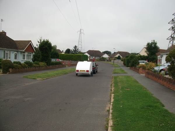

Pico light is on its first trip.
Postby Chess » Thu Aug 09, 2012 11:12 am
Already to go, Charlotte,Pete and the teardrop ready for its first camping trip
Bye
And for the eagle eyed its got different wheels, wheels and mudguards stolen from my utility trailer as one of the mini wheels is slightly buckled and the other has dodgy tyre and I haven't had a chance to make mudguards yet.
