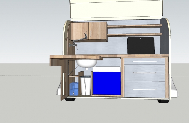

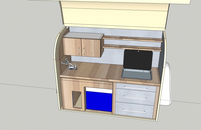

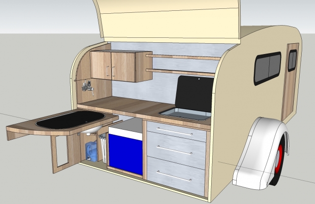

The galley will use the included SMEV cooktop and sink with drainboard. Unfortunately the galley is only 22" deep and a cooler would take up a lot of space. To maximize the space, we will be using a swing out counter for the sink. Since the swingout slides underneath the main counter, there is no space for a traditional faucet. The faucet will be a pot filler mounted on the sidewall with a 17" reach. The lower cabinet is a birch closet chest from Ikea which the drawers will be skinned in aluminum. The countertop is a birch finished butcherblock. Under the counter will be a trash can with a countertop drop through, and a grey water catch tank. The cooler will be on a slide out drawer that can be accessed with the swingout closed.

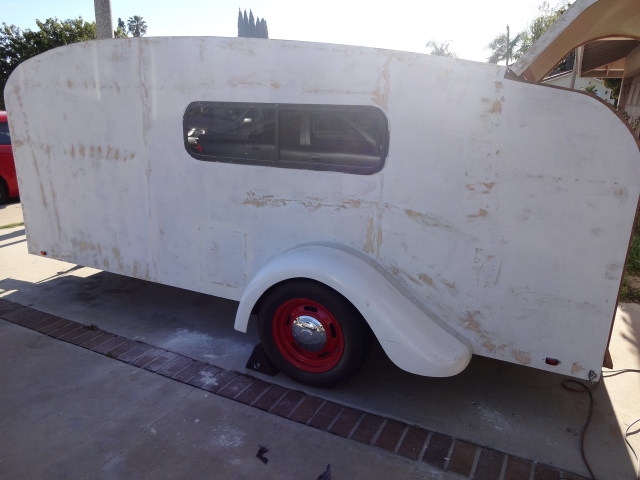

I spent most of the weekend sanding down the exterior. Greg waterproofed every staple and joint with some hard sealant. Unfortunately it didn't leave a smooth finish. It took some effort even with a belt sander to knock it down. I ended up using joint compound to fill any low spots. While the left side required quite a bit of work, the right side was surprisingly smooth. A little more sanding and it will be ready for some canvas.

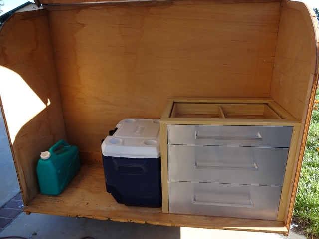

Here's the galley with the cabinet placed and the cooler fitted front-back. I removed the handle and the wheels to save space. The only question is whether the drain pipe will clear the edge of the cooler when the counter is swinging open and closed.

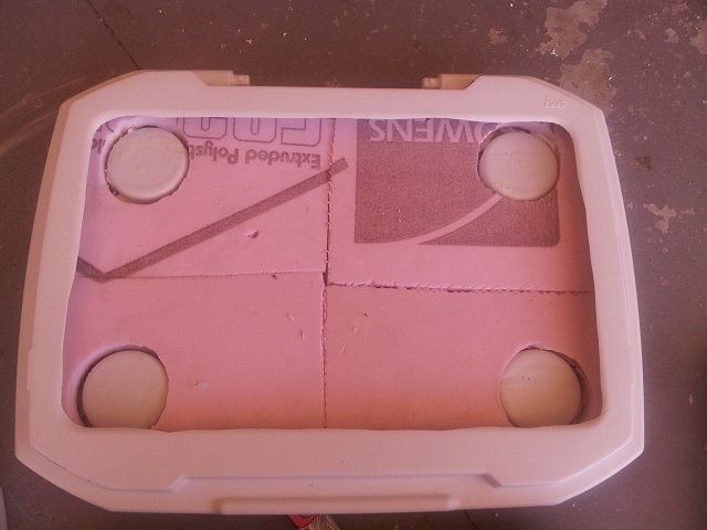

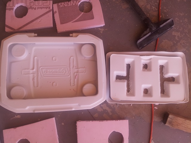

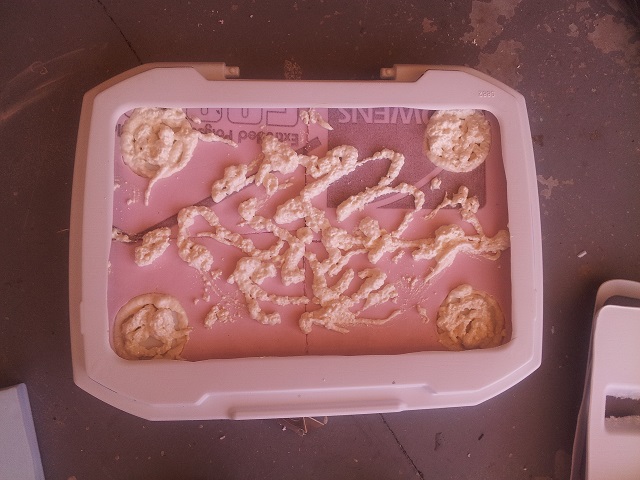

The only 50 qt cooler that had a <22" width was the coleman xtreme. While it advertised that it keeps ice for 5 days, the walmart reviews say otherwise because the lid is not insulated. I'm not sure if the black one sold at $60 is insulated or not, but I figured I can insulate the $30 walmart one myself. Hopefully it works as well as my igloo maxcold.
I guess in order to support an advertised 250lb sitting on the lid, they needed to gusset top to the bottom.
Some spray foam goes in first around the edges, wait for it to expand, the the first layer of XPS goes in.
Some more expanding foam and the second layer of XPS. I just need to find some thin plastic to finish it.

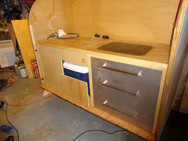

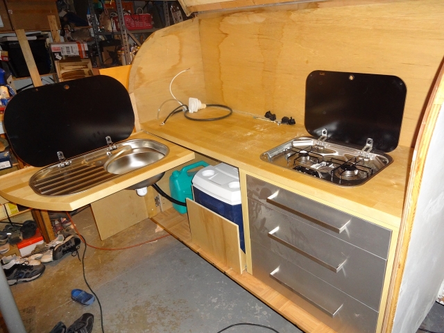

My wife is still unconvinced on the painted canvas finish so I spent the weekend working on the galley.
It's 80% done. I still need to fur out the back wall behind the sink to install power and a pot-filler faucet. It still needs backsplash, upper cabinets and shelves. The gravity tank filler needs to be installed and hose runt to the tank.
Here is the galley closed.
And open for business.
