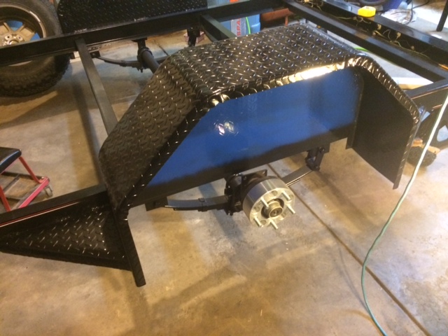

I am starting with a steel frame that was custom built for me by Jayhawk Trailers (a local trailer shop located in Commerce City, CO). With the help of the owner we determined the axle width and trailer construction that I would need for my trailer. To be able to use the Jeep wheels I used a 2" wheel spacer mounted to the trailer hub to be able to clear the dust cap of the trailer hub and use the stock Jeep wheel as is without modifications. The trailer measures 120" x 61" to the outside of the frame for a starting dimension. The fenders and wheel wells were installed by Jayhawk for me and will add a few hurdles during wall construction, but will be a nice flat surface outside of the trailer once it is finished. I wanted a beefy axle to be able to take the abuse of rocks and anything else the trail might throw at it so from Jayhawk it had a 3500# axle on it. I have taken a leaf out of the suspension to derate the axle to be a 2000# axle which should make things ride a little better down the road.
This shows the wheel spacers I used and the blue paint I added to the inside of the fenders.
The inside of the wheel well did not get painted by the trailer guys so I added some blue paint to it
Trailer 2.jpg (118.07 KiB) Viewed 3009 times

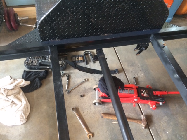

Modifying the suspension
Trailer 3.jpg (122.13 KiB) Viewed 3009 times

Cool trailer. Have you considered switching the springs to the top of the axle to gain some additional height and allow for more articulation when offroading. I did that with my trailer as I take it offroad somewhat as well.

I have started construction of the floor. I have the subframe completed and have the floor started. Unfortunately with the holidays coming up I will not be getting any progress made.
I considered flipping the axle to be under the springs but had the trailer guy build it low to start with. If I find myself running into ground clearance issues I can always flip that later to gain an easy 3". I wanted to keep the overall height low to begin with to make it easier to get in and out of the doors. As it sits right now it has about 12" of ground clearance which is more than the differentials in my jeep.

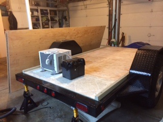

I have made a bit of progress since the last post. I have installed the sub floor and insulated the floor. I also have the flooring bolted in place and put in laminate floor for the galley area. I also have vents installed in the floor for the AC. I was able to find 4x10 plywood to make the walls with which will make construction much easier and eliminate a seam in the walls. Next up is cutting out the profile and building the studs for the walls.

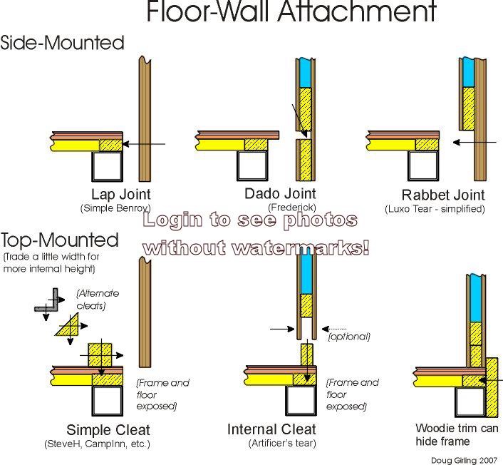

What techniques have people used to attach the walls to the floors?
Floor installed, laminate in place, vents installed and AC placement
Flooring and 1" Insulation between the subfloor members
Floor installed, laminate in place, vents installed and AC placement Subfloor: 2x4's with exterior grade paint

My floor finishes the thickness of my walls inside the frame so essentially my wall load is transfered directly onto the trailer frame and screwed into the side of the floor.
My floor is about inch and 3/4 actual in thickness including both skins so I have plenty of glue surface

Hope this helps! I used the wood cleat style since my frame didn't allow a lap joint which I think would have been better. I first had metal l brackets to secure the walls to the floor and the screws all pulled out on my first trip. I have since used a 2x2 the length of the wall which gave me a better bite into the floor and used carriage bolts trough the walls, it's solid now...

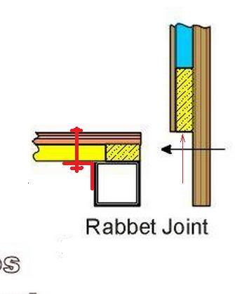

I did a variation on the rabbet joint:
I screwed up (no pun intended :NC ) through the floor into the bottom framing board about every 6"(red arrow). You have to do this before you fasten down the floor/frame, but no biggie if you don't cover the trailer frame with the wall bottom. The advantage is no screws through the outside wall allowing you to use 1/4 or 1/8 ply on the outside, saving 40-50 pounds per wall. Biggest disadvantage is that the screws don't pull the wall in to the edge of the floor, so you'll have to clamp horizontally before screwing.
The cabin is held to the frame by carriage bolts down through the floor into angle iron mounting points. I didn't countersink the bolts, as they're covered by the mattress.
As the absent-minded skydiver said, "So far, so good." :NC
Brad

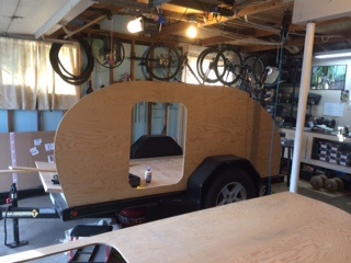

Postby Gibson » Mon Jan 19, 2015 11:22 pm

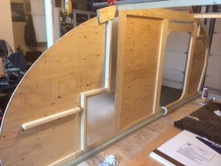

The weekends progress. Next up is to frame the plywood walls
The plywood setup on the side before the frame was attached
The profile is now cutout and the door hole fits the doors

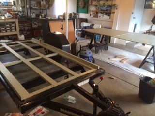

The last 2 weeks have been productive. Getting close to attaching the walls to the frame for good.
Insulation is complete. Next step will be to attach the inside wall
The walls are framed in and insulation had been started.
