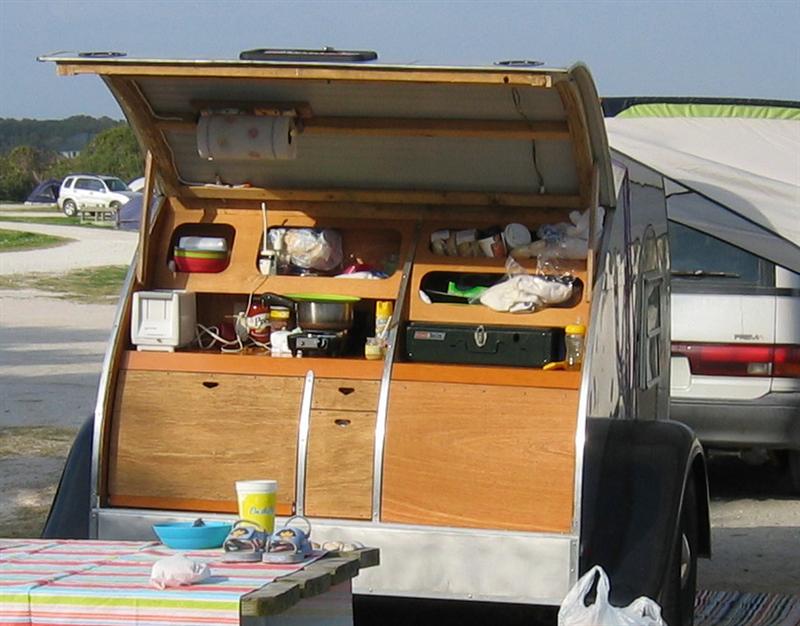

2bits wrote:Image
A really nice shot full of color,
Real nice Thomas :thumbsup: I am kind of partial to this profile. Do you have any particular fenders in mind?
