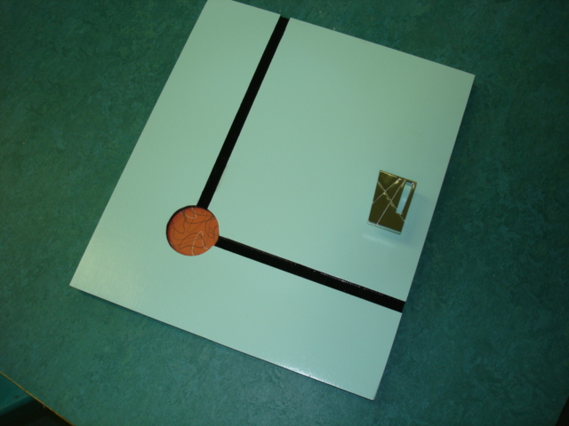

I got the framework for the under bed drawers done, and all the cabinet/drawer fronts made and a lot of painting. Since it was such large piece of flat ply on some of the doors, I thought I'd do up something a little different. Probably not everyone's idea of what they'd do, but I'm the only one that has to camp in it, and I can always make a different door down the road. I'm thinking it will all work.
I put a 15 degree chamfer on the back side of the door edge, drilled out a hole and counter sunk a larger hole in back to hold the piece of the coral Formica. Then routed a couple of grooves and painted them out. Found a late 50's modern/retro handle. Once all the doors are on the galley it will all tie in together, as the black lines will all line up with each other on the rest of the doors. It's all typical late 50's early 60's colors. Now what I really need is about 6 more of the Formica samples. I cleaned out the local Home Depot of the coral boomerang samples they had.
It's kinda fun to not have to worry about wood grain....latex paint hides a ton of flaws. Doug
Postby SIXTOTWO » Sun Dec 13, 2009 9:28 pm
That is soooo coooooollll Doug!!! You really know how to think out of the box!!!
:thumbsup: :applause:

Postby Rocketgirl » Sun Dec 13, 2009 9:28 pm
pretty pretty pretty stunningly awesomely (new word) pretty!

Postby Chip » Sun Dec 13, 2009 10:21 pm
:fb :picklejuice: Pfttttttttt,,,, showoff,,,,, :lol:
Loooooking good thar bud,,,, I like it

Postby doug hodder » Sun Dec 13, 2009 11:06 pm
Thanks all...sometimes when you do something wacky...it doesn't work out. I think this will, some may still be skeptical, I won't have them all done till next weekend. I'll have to install a stick in the grooves so that they all align correctly when I mount the doors, would look funny if they don't. There are some other parts of the picture that aren't quite in place/developed yet as well.
Gage....have at it, I don't mind anyone using my ideas and am honored that someone else might think they are worthwhile. Doug
