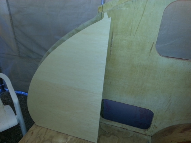

Postby danlott » Fri Mar 15, 2013 6:44 pm
Have not did anything over the winter. Has been too cold and work seems to get in the way. It is starting to warm up, now just need to devote some time to it.

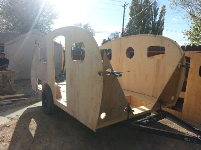

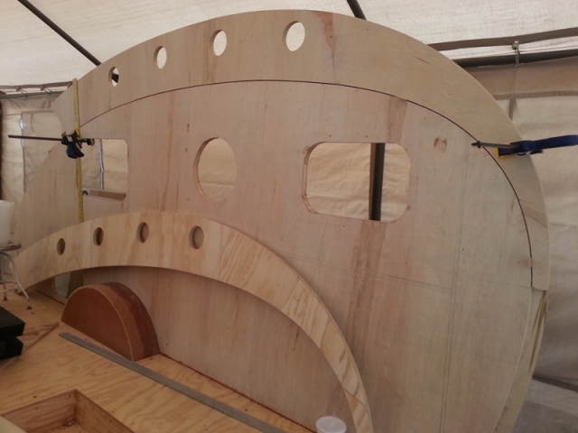

Here are a couple of pictures of my progress before winter set in. I did manage to get the walls attached to the floor.
Here I put one of the trolley top sides on the side wall just to see how it looked and fit. Of course the trolley top will not be sitting on the side wall when finished.
Dan

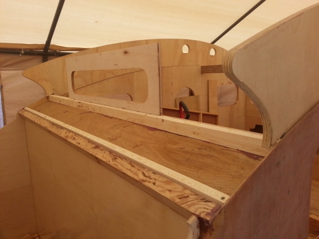

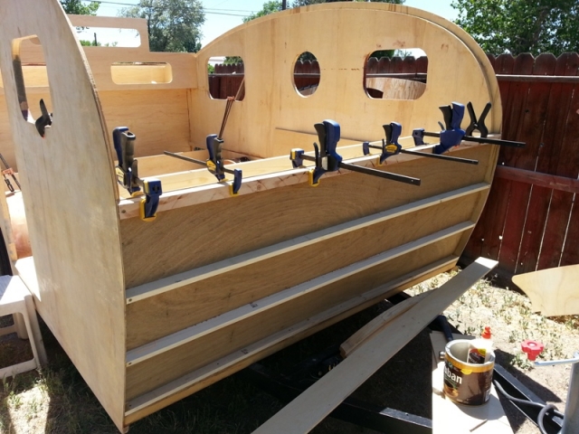

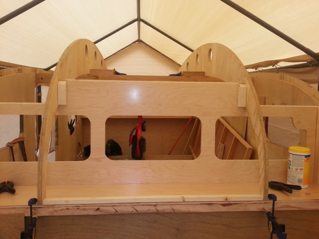

Postby danlott » Thu May 16, 2013 8:21 pm

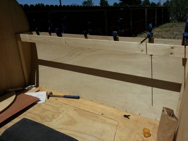

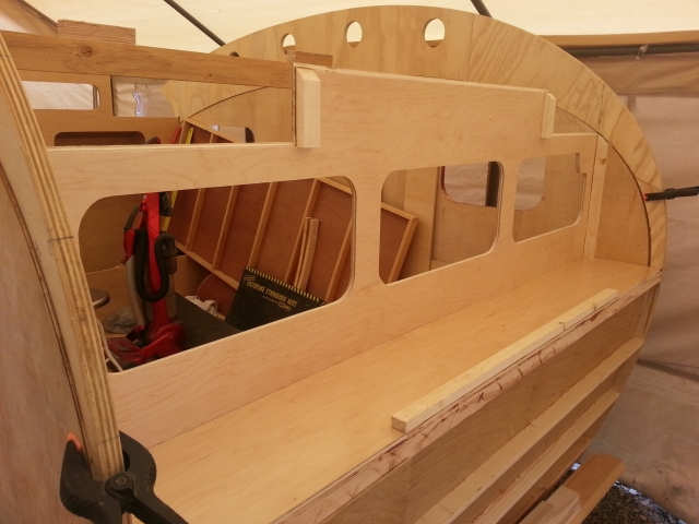

Having a little inspiration from recently attending the best DAM gathering ever and also having a few days off with really nice weather I was able to make some progress.
I am following Steve Frederick's construction guide on most of my build, although I am not following the order that he uses. I mention this, so those that know will understand my galley side wall construction methods.
Here I am installing the 1/8 plywood spacer in the galley sidewall area. This is to allow space for the hatch and seal area.
Here is the finished galley side wall cut out.

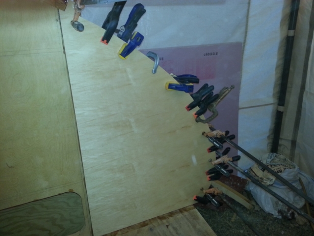

I glued the walls on with thickened epoxy. The bottom and cabin side edges were finish nailed, while the hatch edge was clamped.
This is the galley area with the finished walls epoxied in and ready to be fitted out at a later date.

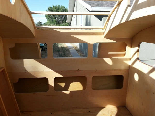

Next I worked on the rear shelf. This is the rear shelf being test fitted. The sides of the shelf has a slot to slide on wood biscuits that are in the side walls. The shelf then is futher supported by the biscuits in the rear galley wall.
Here is a picture of the rear shelf/radio area and rear window area put together and epoxied in to place. Still have to install some dividers inside the cubby areas and make cutouts for the radio, speakers and whatever else I decide to install. The window is in the trolley top section and will look out over the hatch area when the hatch is closed.
Well that is it for now, have to go back to work. More to hopefully follow soon.

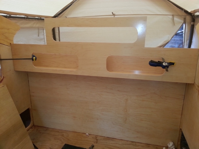

Re: Modified 2+2 trolley top - more progress 6/25/13 -page 8

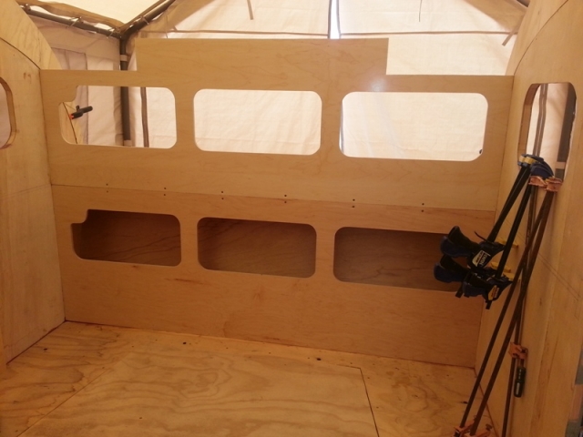

Postby danlott » Tue Jun 25, 2013 4:12 pm

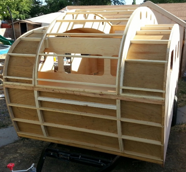

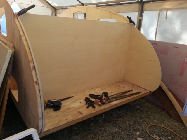

Got a little more done on the trailer.
Got the back cubby area closed in.
Then moved on the front cubby area. The trolley top will be supported off the front and back cubby area.
The seam in the front cubby plywood will be covered by the bunk bed platform.
In this picture you can also see the bunk bed platform lying against the inside wall.

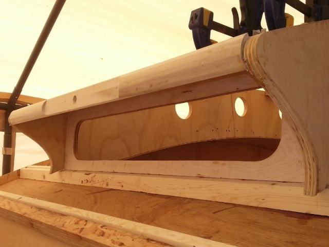

Here are some pictures of the trolley top sides setting in place. The next step will be to get the inside roof skin installed.
In this picture you can see where the rear window will be in the trolley top.

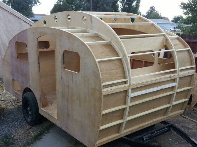

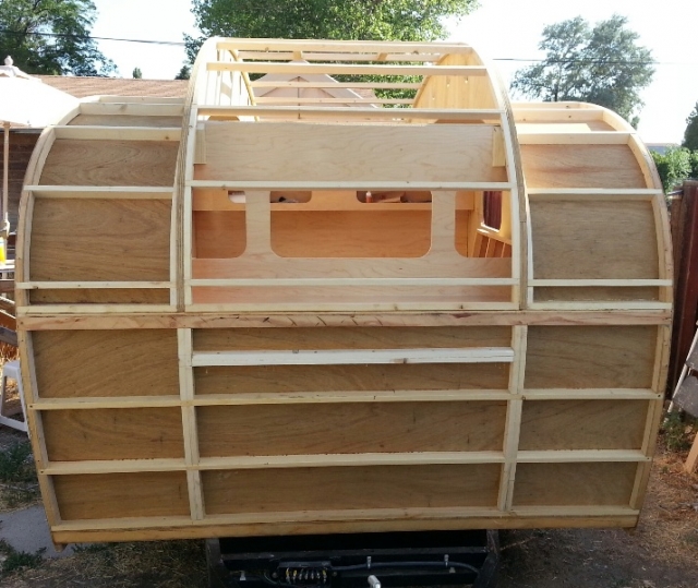

Re: Modified 2+2 trolley top - roof spars -page 8

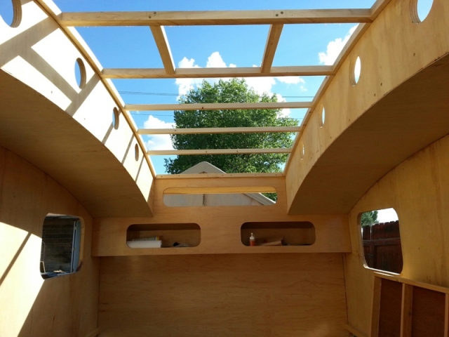

Postby danlott » Sat Jul 27, 2013 10:53 pm

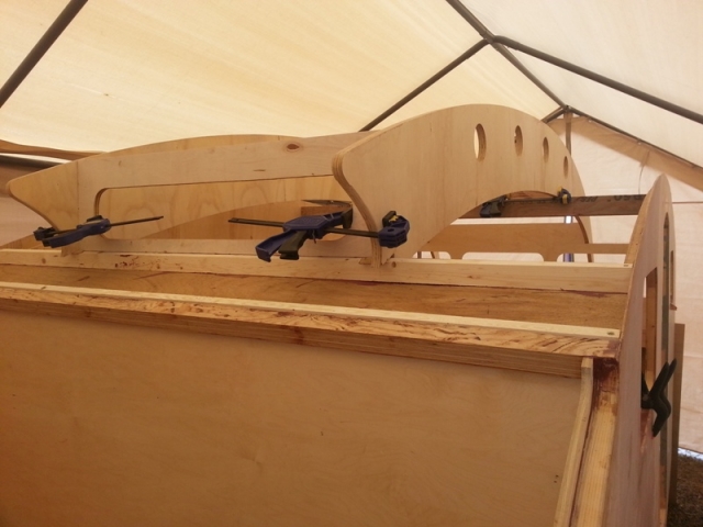

I have made some pretty good progress on my trailer. I have the trolley top sides installed, all the roof spars installed and some of the interior roof skin installed. I still have the plywood to install on the interior of the trolley top and then I will be able to start installing the wiring.
Here are a few pictures of what my trailer looks like today.
Dan

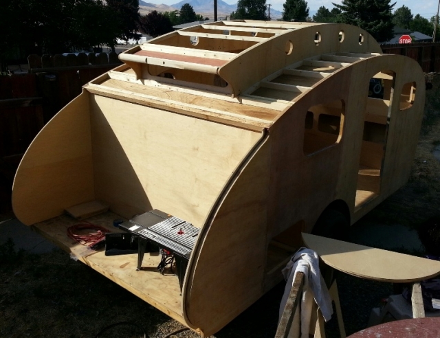

Postby danlott » Sun Jul 28, 2013 11:28 am
KCStudly wrote:Is that a flat spot in the rear of the trolley top for a third brake light? Nice touch! :applause:
Yes it will be third brake light. It will be a brake light and also additional turn indicator.
You can also see one of my mistakes in this photo. I forgot to include the thickness of the roof plywood in the rear radius off the trolley top sides. I plan on filling this area with fiberglass reinforced bondo or thickened epoxy after I install the roof plywood.
Dan
