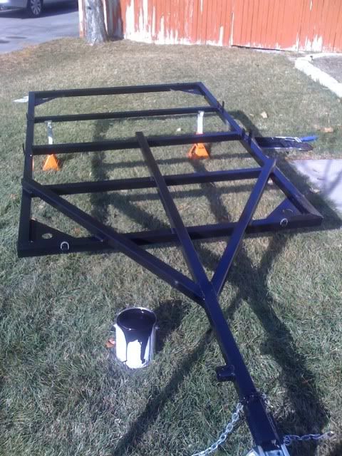

Postby Robbie » Fri Dec 02, 2011 10:59 am
Well I used the last good day of the year and got the axle, frame and shackles all primed up and I got a final coat on the axle and shackles. That Rustoleum Stop-Rust enamel paint is good stuff! It goes on very smooth and has a very durable feel to it when fully dried.
I was getting worried about how I was going to paint my frame with the cold weather here but I lucked out again. One of the guys in the paint shop of my work is a good friend of mine and he uses this same paint on his trailers for his jeeps and he sprayed his with the airless sprayer right in our paint booth. So probably next Saturday for the low price of a breakfast burrito he is going to help me spray the frame here at work. I have almost 2 weeks off work for Christmas so if all goes to plan I will have this thing rolling before next year!!! :D

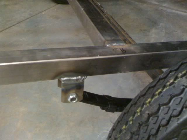

Postby Robbie » Thu Dec 15, 2011 12:08 am

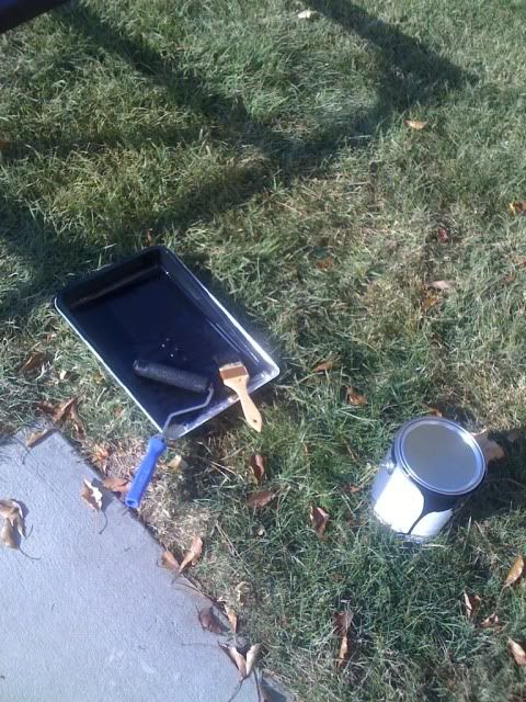

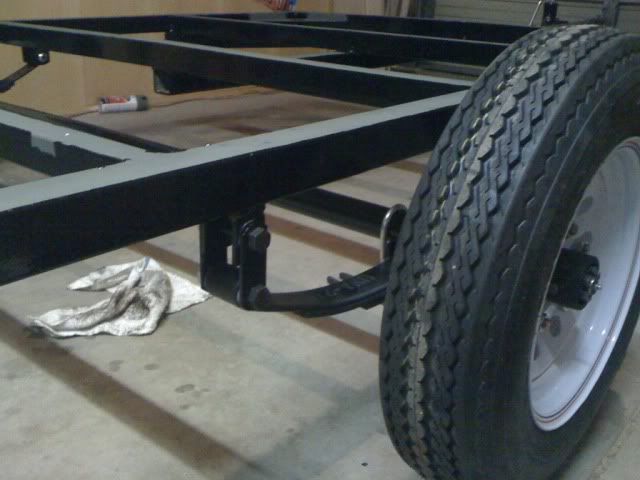

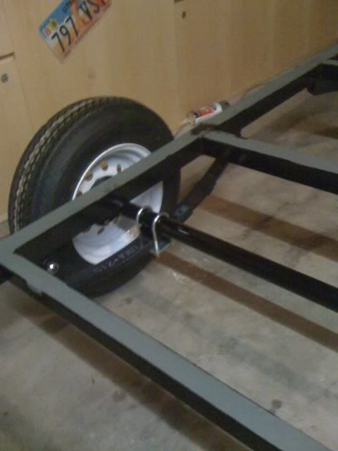

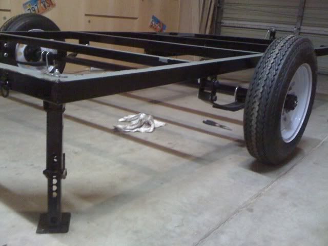

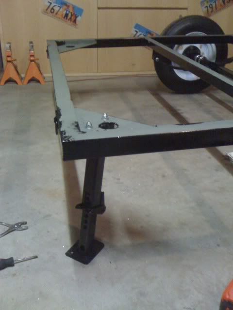

I've almost got the trailer completed and ready for the shell! I used a self-etching primer on the entire thing and have done 2 coats of Rustoleum oil-based Professional enamel on the bottom side of the frame and am going to do the last 2 coats top side this weekend so I can get the shell bolted down over christmas break.

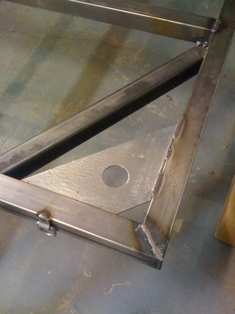

Tonight I got the springs, axle and wheels mounted and got one of the rear stabilizers bolted on. The dang cold weather drained my drill batteries so the other stabilizer will have to wait until this weekend. I added some 1/16" nylon washers between the springs and hangers and shackles to keep the metal on metal friction down. Here are some pics of the painting and assembly...
Here are the painting supplies: foam roller (kinda bunk but they were free) and crappy brush!
Just about finished!
Rear stabilizer bolted to corner gusset...

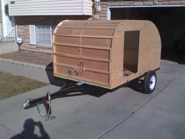

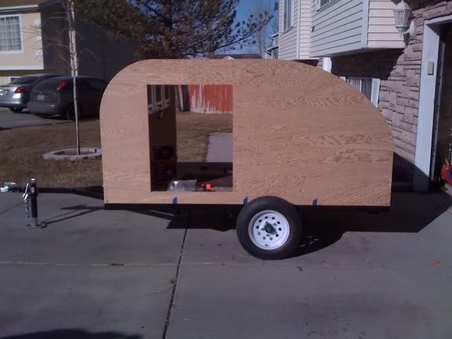

Postby Robbie » Sat Dec 31, 2011 6:37 pm

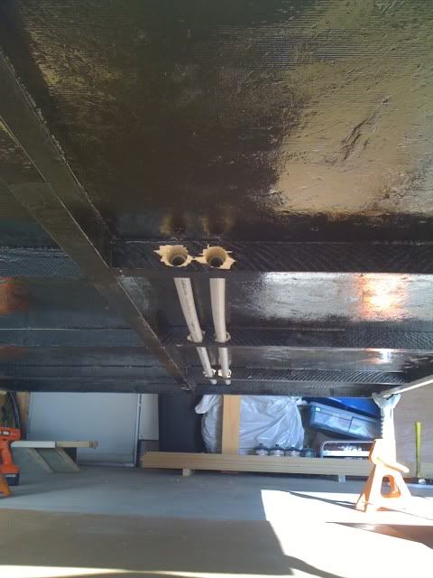

Well its about time for an update! The weather in Utah has been unusually warm and sunny so I took advantage of it. I got the rest of the trailer painted up on Christmas afternoon and a couple days later I got to work on the underside.

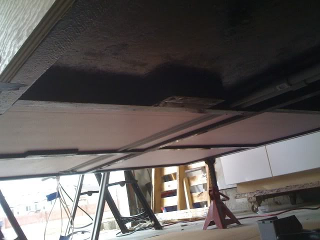

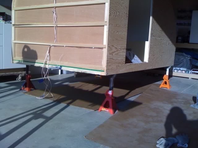

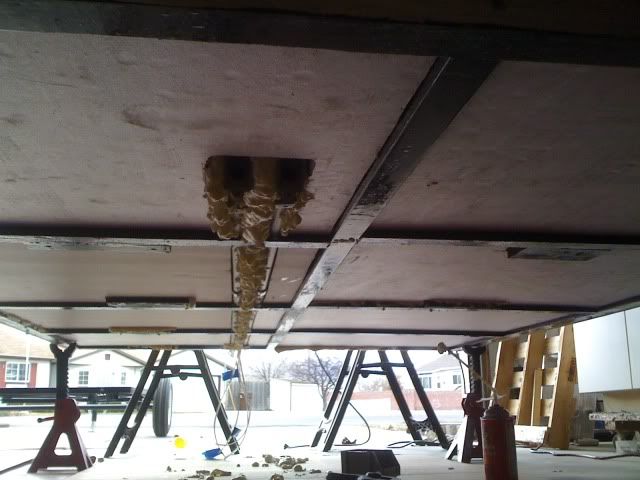

I got the cab on jack stands to give me some more room underneath to work with the insulation and conduit.

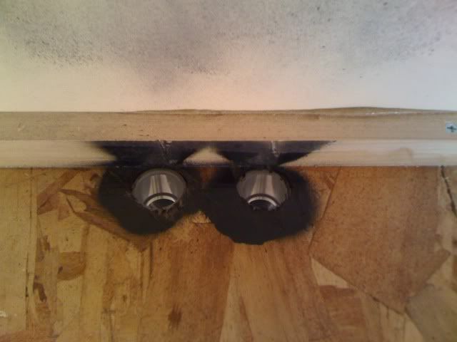

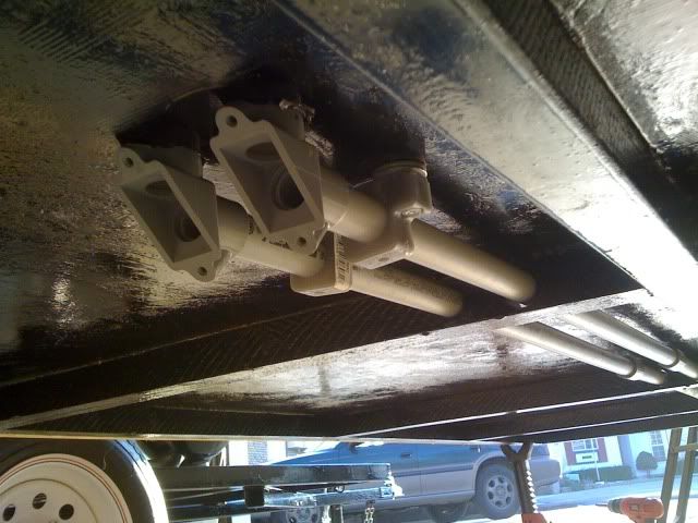

The 2 110v lines come up into the storage area via some access 90* elbows. One line will be for a surge strip in the storage area and the other for the interior outlet.
Once the conduit was ran I got to work on the insulation. 1" foam board from HD. I was weary about fastening them to the bottom of the trailer but I cut them so they fit snug and used a TON of polyurethane construction adhesive to keep them on.
I used the expand-a-foam to fill in all the gaps around the conduit lines. Once that was hard and dry I trimmed off the excess and used some roofing/flashing sealant to hit all the edges and holes to make sure no water would get up in there. What a mess that stuff makes! It all turned out really good and I think it will help with insulating quite a bit.

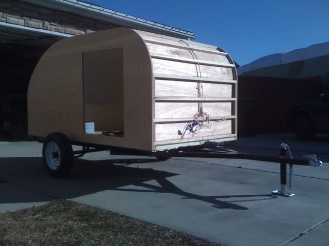

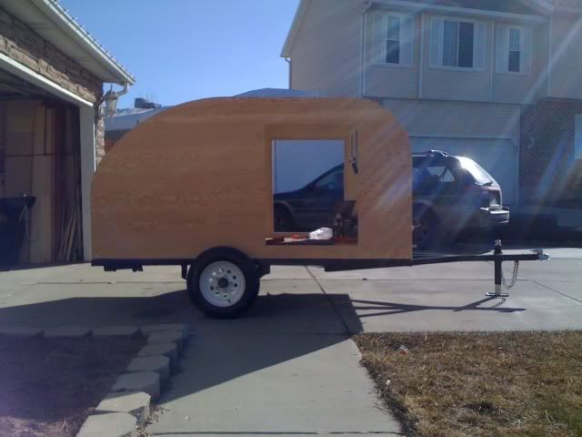

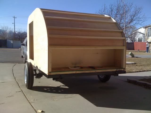

A couple of my buddies came over today and helped me get the cab onto the frame! This was exciting because it is really looking like a trailer now AND I get half my garage back! Woohoo! Its only bolted on at the rear with 3 bolts right now but I will have 11 total and get the rest on through out the week. There will need to be some shimming but nothing more than a 1/8"-1/4" at one corner. I'm super excited to get it this far after starting out with a pile of scrap wood.
I think my axle placement will be perfect also as it's quite light and easy to move around right now but once the tongue box is on and the battery is in I think it will be just about perfect. IIRC the axle is 40" from the rear of the trailer frame.

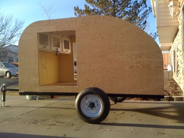

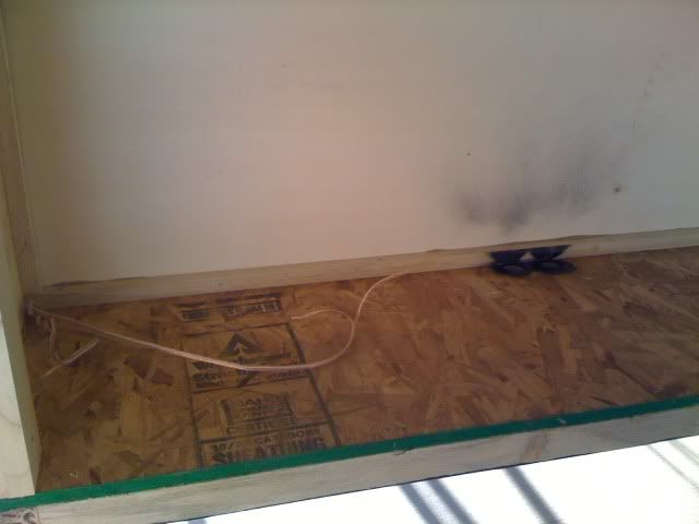

So the rear shelf is assembled and ready to be installed, along with the front electronics box that will house a 12v outlet and the porch light switch and hang from the bottom of the front cabinets. And I also got the rear electrical outlets installed, just need to wire them up!

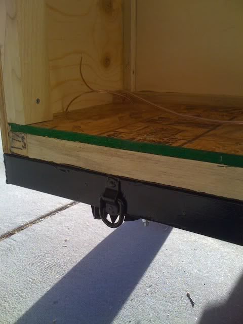

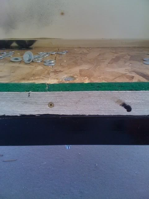

Over the weekend I got all the holes drilled and got the cab bolted down and then I realized that since the frame is out of plane slightly, and I forgot to seal between the cab and the frame, the bottom of the plywood walls are completely exposed in the front couple feet and are unsealed. So tonight I am going to pull the cab back off the frame and get a few coats of primer/sealer along that bottom edge and then a few coats of the Rustoleum enamel and hit a heavy bead of roofing sealer all along the perimeter before I set it back down. That should help protect that bottom edge of the walls.
2 steps foward, 1 step backward. :lol: :cry:
