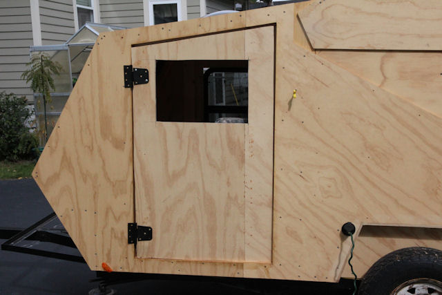

Okay, so winter is almost over... 3 weeks until spring!!! I figured I'd better get off my duff and start moving again.
Today's project was to get the 2nd door started. Can you believe it took all day just to frame out this silly door? :?
FWIW, I did use biscuits through and through!!! ;)
But any sawdust is better than no sawdust at all! :)
Re: Rockhopper - 2nd door started...
Postby starleen2 » Sun Mar 03, 2013 7:45 pm
Much better layout on the door - the new window cut out looks promising. :thumbsup:

Postby stomperxj » Sun Mar 03, 2013 11:31 pm
Looks good Mike- I see you are using the trusty Stanley Gate Hinge. Those are the best hinges for the price I think...

Postby mikeschn » Sun May 26, 2013 6:52 am
Summer is finally here again!
Got the doors done, and got the outside skin on.
I put putty in all the holes, and this morning I am going to start sanding...
The plan is to be able to start putting fiberglass on the roof this afternoon.
