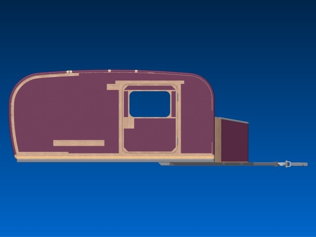

Re: Father-Daughter Build 2013-14
Postby KCStudly » Wed Jan 29, 2014 11:22 pm
I think I am the only one to use the term "bustle", so no worries that you don't know what I mean!
TPCE profile is basically a Benroy with a slight curve in the roof, and a bit more curve in the rear sticking out just a touch up high like a canned ham or, kind of like a southern belle's dress at the hips... hence my term "bustle".
Not at all as tapered or acute as a true teardrop.
TPCE profile.
Southern Belle's Bustle
