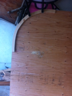

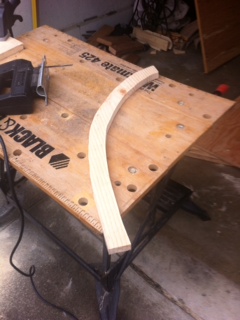

Postby mariannf » Mon Jan 25, 2016 3:09 pm
curved framing 2.jpg (30.79 KiB) Viewed 3325 times
curved framing.jpg (36.44 KiB) Viewed 3325 times
I started cutting the curved framing that will go on the sidewalls. I used spare 1x12, laid it under the wall and traced the wall curve. Then I cut using a jigsaw which I found much easier than a router for this work. the finished framing is about 1x2...which is what i am using through out for framing. I will glue it and screw it on when closer to installation, and then sand it to smooth out imperfections.

Postby KCStudly » Mon Jan 25, 2016 3:48 pm
A couple of pointers; it would be better to use narrower stock... say 1x4... and miter cut them around the curve as you go. You will get less waste that way and the grain will follow around the curve (perpendicular to the radii) more consistently. With the 1x12 you will waste more wood and the grain has transitioned to end grain by the time you got around the curve. It is much more likely to split and won't take a screw as well.
On the jigsaw vs. router; cut the blanks with the jigsaw but go wide of your line by about 1/8 inch. Then after you fasten it to the side, run the router with a top bearing flush cutting bit with the bearing following your nicely sanded wall edge trimming off the excess. That way the blocking will match the wall perfectly, best of both worlds.

Postby mariannf » Mon Jan 25, 2016 4:36 pm
KCStudly wrote:A couple of pointers; it would be better to use narrower stock... say 1x4... and miter cut them around the curve as you go. You will get less waste that way and the grain will follow around the curve (perpendicular to the radii) more consistently. With the 1x12 you will waste more wood and the grain has transitioned to end grain by the time you got around the curve. It is much more likely to split and won't take a screw as well.

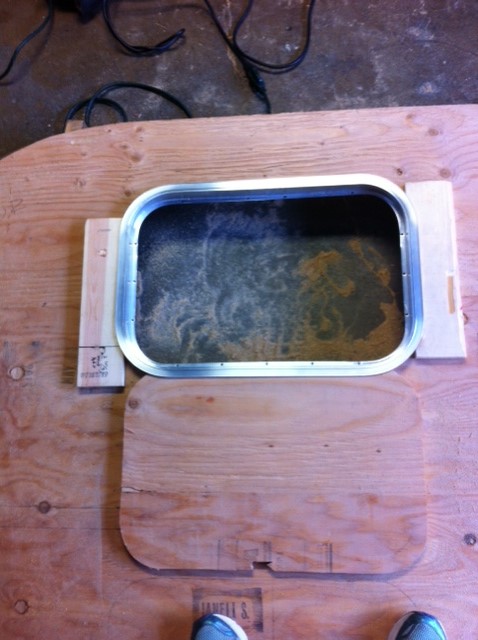

Postby mariannf » Sun Feb 07, 2016 3:26 pm
The attachment image.jpg is no longer available
After a hiatus, I have started making the cuts for the doors and windows. I marked their location based on the drawn plan, then based on advice in the forum and examination of the pieces traced them out using the trim ring. All pieces were bought from vintage technologies. I made the cut for the first window using a jigsaw. I cut about 1/8 of an inch inside tje trace mark to assure I didn't make the cut too big. The initial cut was a bit too small so in a very slow process of making adjustments with both the jigsaw and sander I got the first window cut out. There is one more window and two doors.
