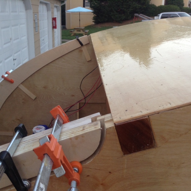

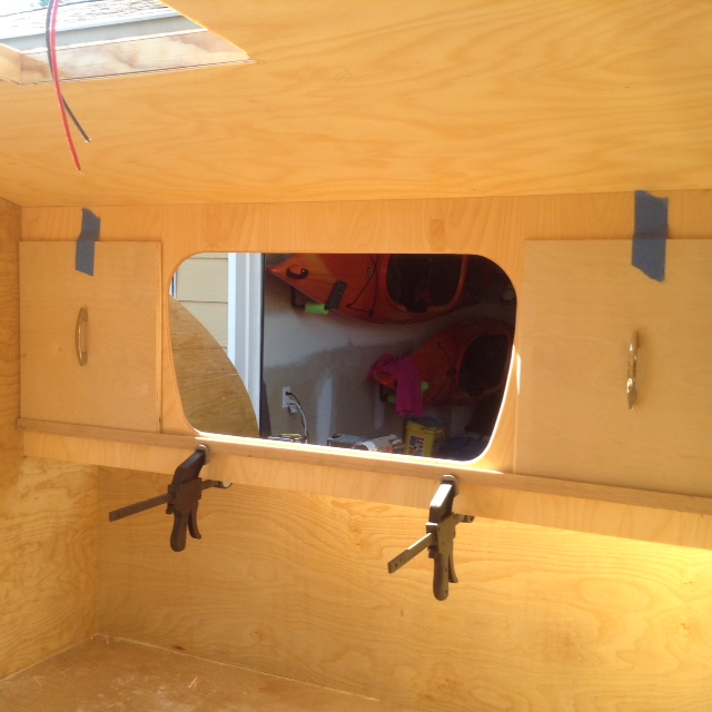

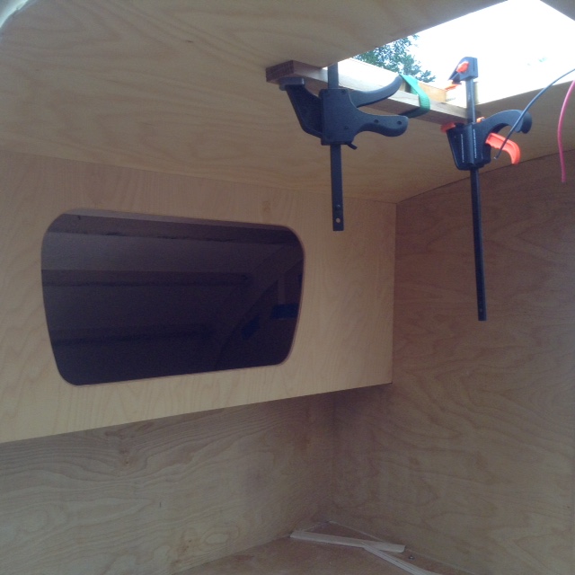

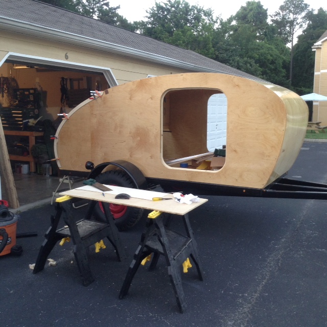

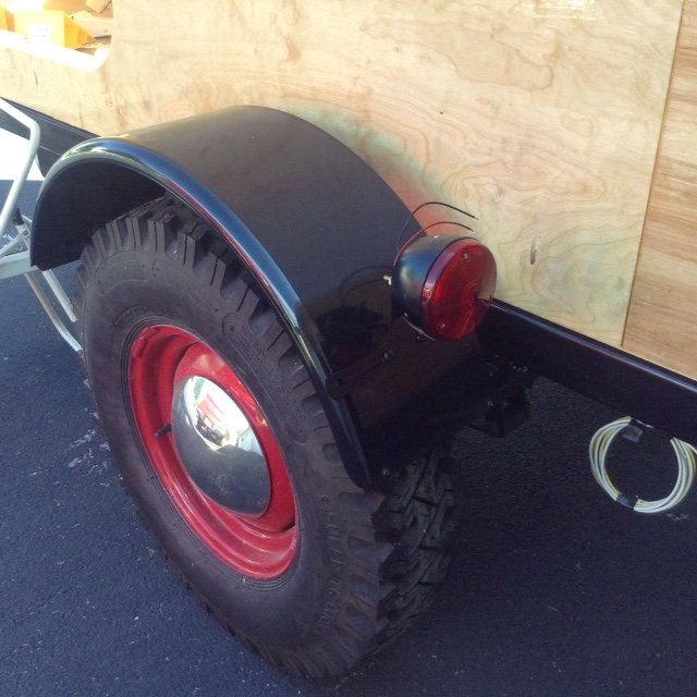

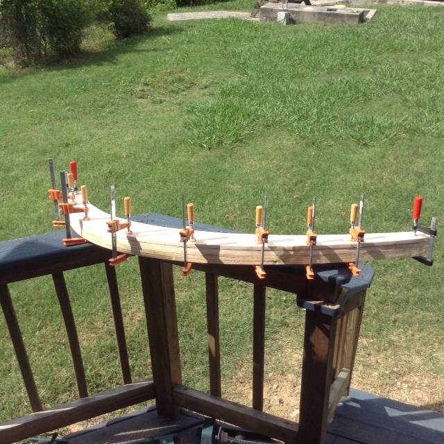

Tonight I clamped the hatch sides with gussets onto the back of the TD. The starboard side pretty much fell right into place with the 1/8" spacers. Woo Hoo! The port side was a different story. It seems there is a slight warp or twist in it. About 1/8". :frightened: Had to enlist the help of Mrs. Kokomoto to hold the shims in place while I twisted myself into pretzels trying to clamp it in place. I'd think I had it right, then discover the 1/4" gap (to allow for the aluminum molding) was off on one end or the other. I felt like one of those guys that spin China plates in the tops of poles. :? It turns out that my troublesome hatch side not only has a warp, but also a slightly inconsistent gap. Also about 1/8" larger. I finally averaged out all the errors, called it good, and proceeded to mark the lengths of each spar since they will probably not be identical. I only hope that once they are all fastened in place that they will hold the sides exactly where they need to be, and stay there. I plan to use 2 kreg screws in the end of each spar with TB3. That should cancel out the warp. :thinking: with fingers crossed.
The dry fit of the cabin-to-galley window went well, and I got the tail lights bolted on to the fenders.
kokomoto
Posts: 244
Joined: Tue Oct 18, 2016 3:18 pm
Location: SE Tennessee
Re: Off-road Teardrop Design/Build
Postby kokomoto » Sun Jun 11, 2017 8:30 pm

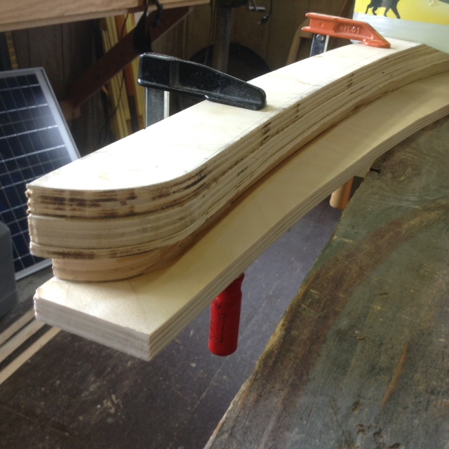

Hatch side
Hatch side glued
Starboard hatch side clamped in place

Postby kokomoto » Sun Jun 11, 2017 8:38 pm
Window open
Window closed
Tail light

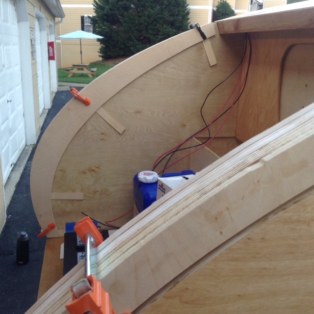

Postby kokomoto » Wed Jun 14, 2017 8:50 pm

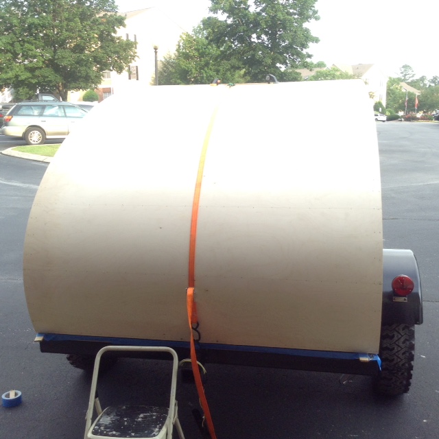

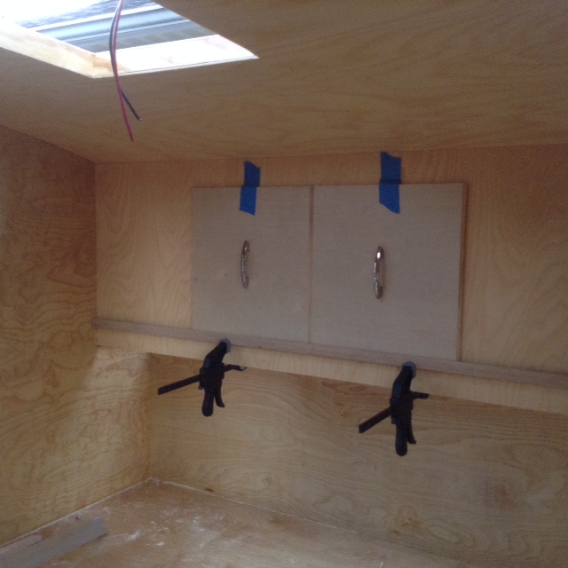

Installed outer skin on hatch. I used Popsicle sticks to keep the spacing between the gussets and galley wall, and glued the plywood in place.
Hatch outer
Hatch inside
Improvised strap anchor
