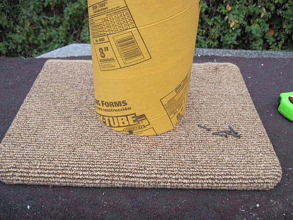

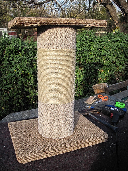

I took a short time-out from my camper build to create a couple of cat scratching posts/perches, one for my cat Dewey and one for my Mom's cats. Dewey just LOVES it! He not only naps on top but also stretches on the post or grabs it with all fours and circles it! He's never been a "furniture scratcher" but can't seem to resist digging his claws into the sisal rope and carpeted column.
I hope you don't mind if I outline on this build thread how I constructed these, maybe some will find it a worthwhile project. These are quick and easy to build and much cheaper than the store-bought ones.
For the bases I used pieces of laminate countertop cut-outs, free from the dumpster bin at the laminate counter shop. Yeah, I'm addicted to that place. :lol:
I sawed the cut-outs in half, making two bases, and rounded the corners. Then, using my 1/4 crown stapler w/3/4" staples, I tacked either regular carpet or rubber-backed rugs to them. The rugs worked better as they were more flexible. I found some at Goodwill, 99 cents for a set. For the top perch area, I used a smaller platform.
For the column I used an 8" Quickcrete sonotube, HD around $7. One tube will make two perches. I cut two plywood circles and fastened them inside the bottom/top of the tube and then screwed each to the base/platform.
I used a carpet scrap to wrap the lower portion of the column, the same staples work good here and actually get a good bite when powered into the cardboard sonotube. Then, I tacked down one end of the sisal rope and wrapped the column, stapling every coupla wraps, finally finishing the top with more carpet. 100' of sisal (two pkgs.) was used for the wrap.
I had considered adding sandbags to the column interior, cats don't trust a wobbly post, but the weight of the base seems sufficient without them. I should also mention that sisal rope is the recommended rope for cat scratching posts and there are several varieties, some with more odor than others. I used Harbor Freight sisal (which has a stronger odor, but is cheaper than WM, HD or L) on Dew's column and the more expensive sisal on the one I made for Mom. She reports that her two cats like their posts also.
I'm fairly pleased with the results and Dew doesn't seem to mind that the corners aren't perfect.

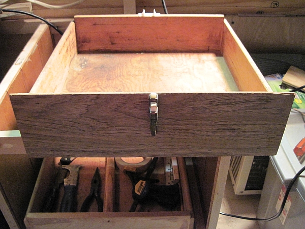

I salvaged the drawers from the pop-up and will use them. Here's one of the drawers before refinishing.

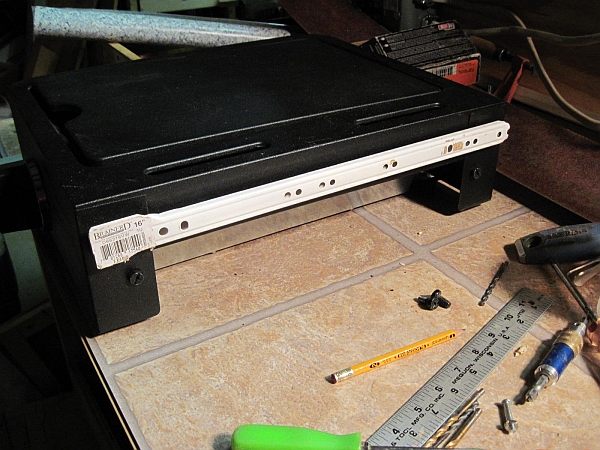

Poor picture, will take a better shot later. I found this at L several yrs. ago on end-of-season close-out and grabbed it. It's an accessory to a full-sized grill, a side-burner. It has a spark ignitor and a propane cannister screws into it from below. I plan to mount it on a slide-out, below the counter and above the a/c area. The cannister will fit when slid in, no removal needed. I need to purchase some bolts that won't interfere with the slider, the ones I have are round head and don't work. Sturdiness of the slider-mounted burner is something I question now. If it winds up floppy I'll come up with a different approach.

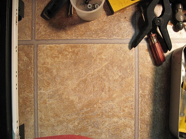

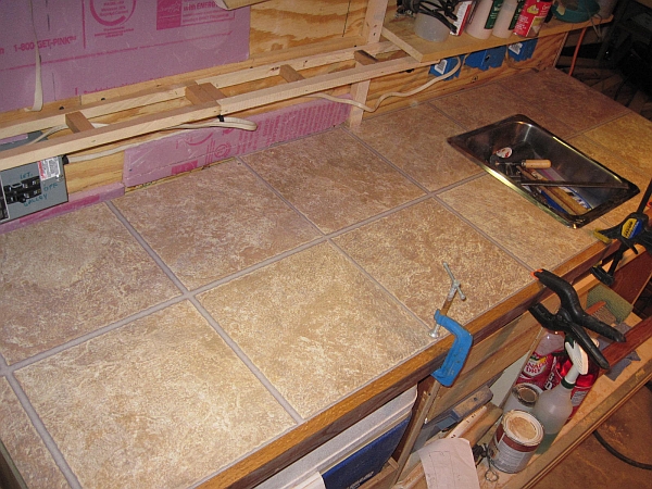

There's also a bit of my countertop showing in that pic. I've decided to use laminate flooring. I picked this up at Habitat for Humanity and hope it will work out ok. I like the tile look without the weight. I tested it out with 1/4" ply as a base and it doesn't flex with my countertop depth of 23" and multiple divider supports underneath. Floor laminate isn't recommended for countertop usage but with reasonable care I think it will be fine. No cutting board, no huge water spills, etc. I'll add Titebond to the joints for insurance.

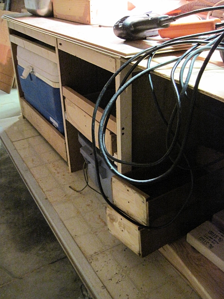

The slide-out tray for the Igloo is roughed-in, along with the lower bin for the Rubbermaid Dutch Oven box, with drawers above.
A close-up shot of the counter-top flooring laminate.
I decided, for the benefit of less weight, to use sandwich construction for the lower galley divider walls but I question that decision now for the multiple drawer areas. Installing multiple sliders for stacked drawers requires the installation of horizontal framing, adding to the weight and complexity of the build. 1/2" ply dividers might be a better option, they would be thinner, that could change.

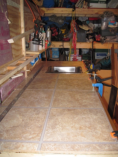

I attached a piece of laminated MDF (salvaged sink-cut out) to one end of the countertop, cut the sink hole, and planned to surface the remainder of the countertop with flooring laminate. Then, I changed my mind. I didn't have a good solution for making the transition waterproof, high priority.
So, I removed the MDF piece (PL premium adhesive works great) and went with all flooring laminate. Router (with flush trim bit) was used to trim off the unneeded locking edges.
Here's what 73 inches of countertop looks like. What will I ever do with all that space? :lol:
