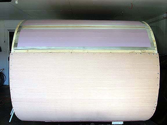

Took it outside and blew off the sanding dust - now it's ready for for the insulation. currently I'm pre-bending the front plywood to make it go on a bit easier :thinking:

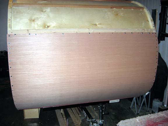

Thomas – the plywood is 5mm luan – a little stiff to bend, but if you prebend it – it can be coaxed into shape. The good news - no creaks, cracks , or pops - Just one smooth sheet wrapped around the lower curve. The upper portion will be easier since it's one curve. The screws are Just temporary until the adhesive is set (thanks Tom ==>aggie79 for another great tip). I added the washers to spread out the clamping force of the screws. What you do not see are the 18 gauge 1 inch long staples placed along the edges and the spars. I insulated with one inch foam insulation. Once the top portion is skinned, and screws removed, I'll do a flush cut to trim off the excess.

starleen2 wrote:Thomas – the plywood is 5mm luan – a little stiff to bend, but if you prebend it – it can be coaxed into shape. The good news - no creaks, cracks , or pops - Just one smooth sheet wrapped around the lower curve. The upper portion will be easier since it's one curve. The screws are Just temporary until the adhesive is set (thanks Tom ==>aggie79 for another great tip). I added the washers to spread out the clamping force of the screws. What you do not see are the 18 gauge 1 inch long staples placed along the edges and the spars. I insulated with one inch foam insulation. Once the top portion is skinned, and screws removed, I'll do a flush cut to trim off the excess.

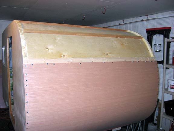

Getting ready to do the top section. I got the insulation installed and gaps sealed and edges sealed with foil tape.

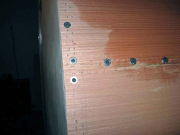

A little water helps to make the bend
Here's a close up of the scews and washers - it helps to spreads out the clamping force of the screw. After the bend is set - these will be removed.

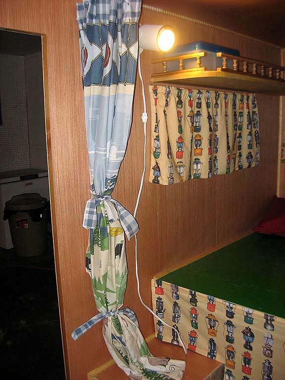

We got the privacy curtain installed,. As you can see it’s a standy for Mrs. Starleen!
Tied up and out of the way when not needed
(if you like the design – ask Planovet where he got it – If was gifted to me on my birthday – Thanks again Mark and Cindi, told ya’ you would see it again!)

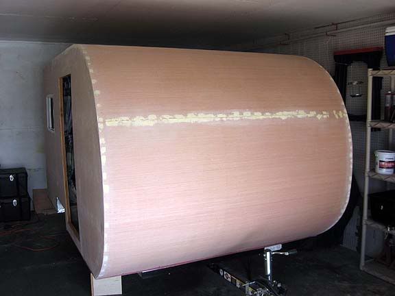

Finally flush cut the edges, all the screws removed, washers removed, counter sunk holes, screw re-installed , filled, sanded flush

:thumbsup: :applause: Wow! I wish I had used washers. Seems to keep the screws from digging in! :thumbsup: Is you curtain rod spring loaded or something else? :worship:

Miriam C - the rod is a clothes hanger rod secured by two cups on the wall. It is made of metal and very strong. I have used the compression types before - But their limit is 6 feet - the inside dimension is 6 feet two inches ;)

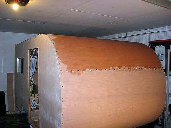

The leg is better this weekend - and it was gorgeous weekend to do some work on the camper - Couldn't bend down to to do any trailer wiring. So I spent most of the day doing filler work - Filling in screw holes, sanding down filler , getting it prepared for the epoxy - but now the weather has to warm up some more and I can open up the garage. I need plenty of ventilation lest the neighbors think I'm running a meth lab ;)
