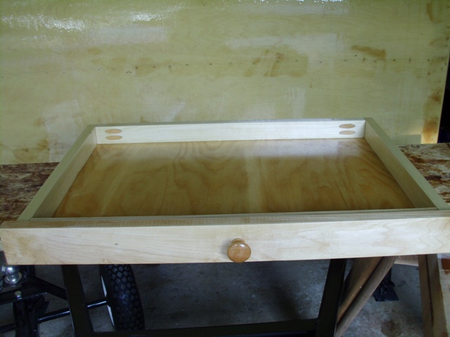

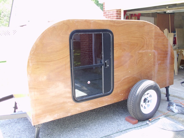

But first I needed to get my door openings sanded and get the doors fitted into them. I must have tried to put each door in twenty times or more before I finally got it right. (I really need to improve my skills with the jigsaw.) But they fit in now, tightly (which I think is a good thing) and I can get the plywood edges sealed up again in preparation for painting. (I thought I was going to be painting this weekend, but did not feel like doing all that sanding and prep work out in the heat.)

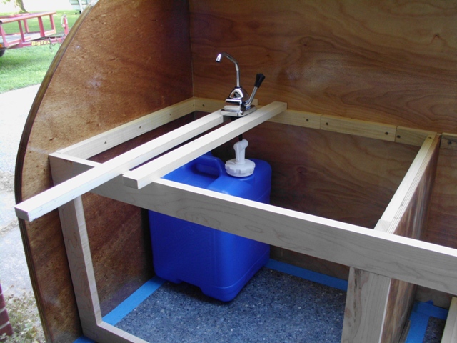

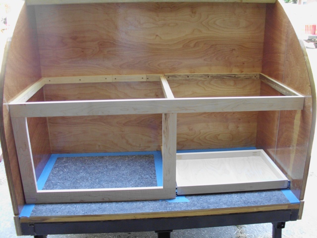

I am loving working on the galley (and I am crazy about my Kreg jig). It's a simple plan, but should give us everything we need and can be added to later.
First let me explain about the weird wood tones in the galley. The cabinet wall by the cooler area that has the horrible dark stain on it, well, we'll just call that an error in judgement. And it was an error that cost me a face frame. The color on the can of stain was a nice light golden color, but when I put it on the wood....YIKES. But did I stop with just the face frame? No...of course I didn't. I figured it must be that it needed to dry, and then it would lighten up to that nice light golden color.
:laughing1: :laughing1: :laughing1: :laughing1:
I did not want dark wood, so.... I went and got new wood to rebuild the face frame. The walls were going to be painted white anyway, so now the interior of the cabinets will be white also. It also gave me an opportunity to start over with a different wood. I have been using poplar for all my framing and had intended to use it for the cabinets also, but I decided I did not like the natural tone of it (sort of ashen) and I am afraid now to try and stain it again, so I went looking for a wood that was not as heavy as oak but that I thought would look nice natural. I settled on maple and I am very happy with that decision. It is the exact look I wanted.
So here's what I have so far.
The right side has a sliding drawer for the cooler. The side next to the cooler will be left open, no shelves, and will only have one large door so that I will have easy access to load large items (like the water jug) and will not be restricted in the size of the containers I store in there. My stuff will mostly be organized into Tupperware type containers anyway and they stack easily enough on top of each other. Above the cabinets will be a single shelf, 5" deep, with galley rail. I am putting some Shaker style pegs under the shelf to hang coffee mugs, pot holders, cooking utensils and the like. I will put mounting hardware over the cabinet door where I can mount a table extension. The table will be long enough to allow the cabinet door to open fully when the table is in position.

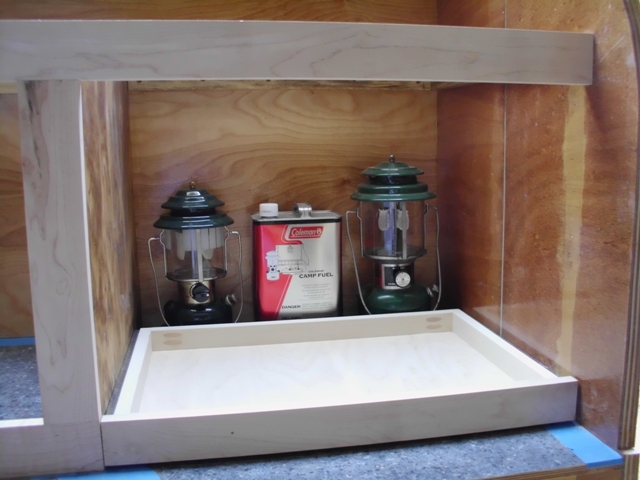

I found that the area behind the cooler drawer is a perfect fit for two Coleman lanterns and a can of fuel. I have a couple ideas for how to secure/protect them back there.
I shaved about 3/8" off the bottom of the drawer facing so that it would have room to clear the molding across the rear on the floor when the drawer is extended and still match up with the height of the other face frame.
The hand pump will draw directly from this water jug and there will be just a small stainless steel bowl in the counter. I had planned on and purchased a regular sink with p-trap and drain and all, but I think all that plumbing just eats up too much space below the counter that could be better used for storage. We really wanted the ability to draw water with a pump though so we wouldn't have to mess with that big jug every time we needed to use a few ounces of water. We will be able to load the jug in the cabinet empty, then lift out the bowl and stick the hose in to fill it.

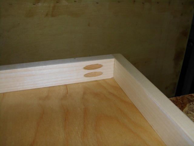

I used my Kreg jig for my joinery and I just love it. I do not have the carpentry skills (or the tools) to do joints of this quality any other way. Plus I love the look of the plugs. I think they add an interesting visual element to the piece.
This will be the basic style of my cabinetry throughout. I guess it is basically Shaker, and it is very appealing to me.
