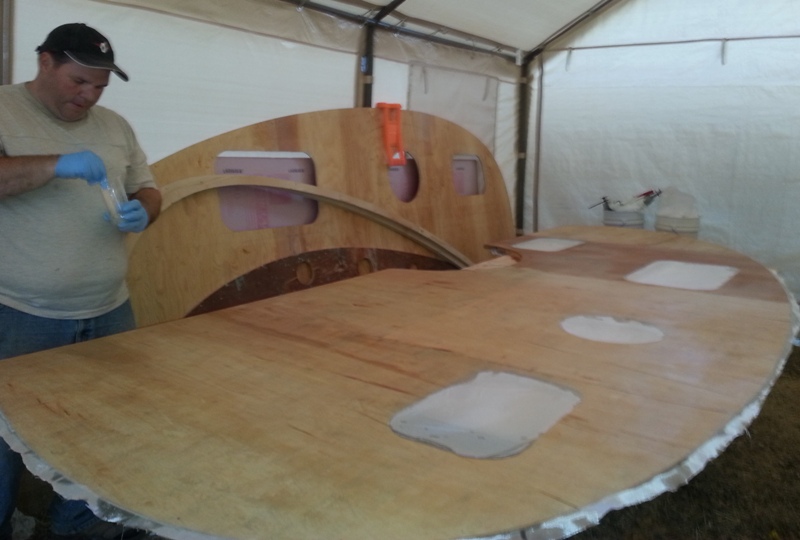

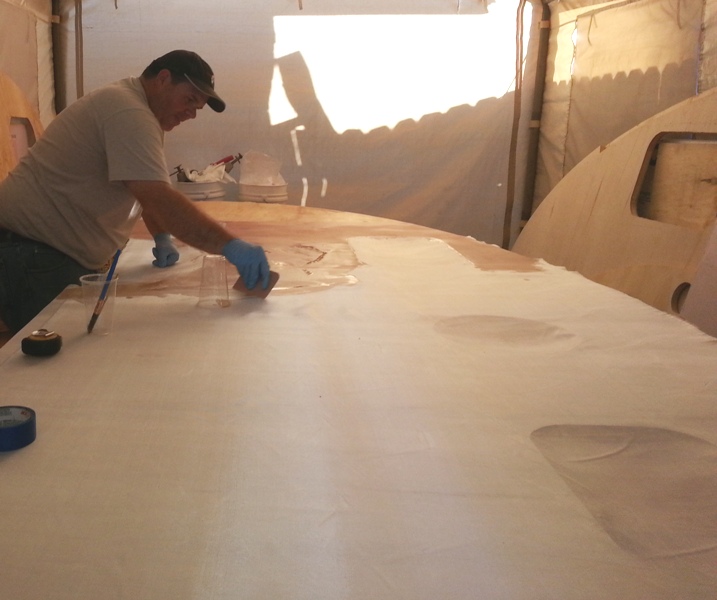

Interesting stuff, this fiberglass!!!
Re: Rockhopper - Fiberglass
Postby KCStudly » Mon May 27, 2013 10:41 am
Looking good, Mike.
I take it this is your first time using FG. Any additional comments that you can share with those of us who have little experience with the stuff?
Postby mikeschn » Mon May 27, 2013 11:24 am
Yea,
Bubbles... I hate them.
Where the fiberglass doesn't lay down flat on the plywood!!!
But the good news is I tried sanding down a bubble today that we made yesterday, and it sands down well.
I have a lot of sanding to do.

I'm sure I made every mistake in the book with this fiberglass, but then, isn't that what a sander is for?
I finished this on Monday, and it's in the garage curing so that I can try to sand it smooth this weekend.
