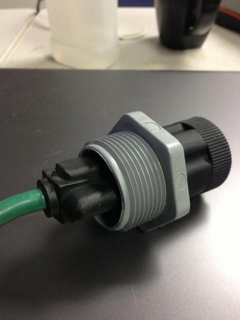

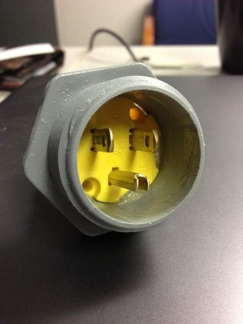

Thanks! I was really looking for a wider pinstripe, but was to cheap (it was like $30 for 35 feet, and I needed 40 feet), so I bought this, but didn't realize it was double, I started putting it in and loved it! Today I worked on my shore power connector. Couldn't find one locally so I used a 1-1/4 threaded plastic fitting with the slip coupling cut off, and epoxied a male plug in it. I will mount it flush and have an outside electrical box cover that will go over the front of it.

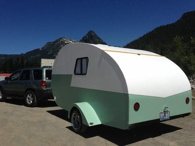

First trip down the road a success! No problems towing once my car realized it had a load and adjusted accordingly. Set up and ready for some beach time!
But first a stop at our favorite burger joint:
