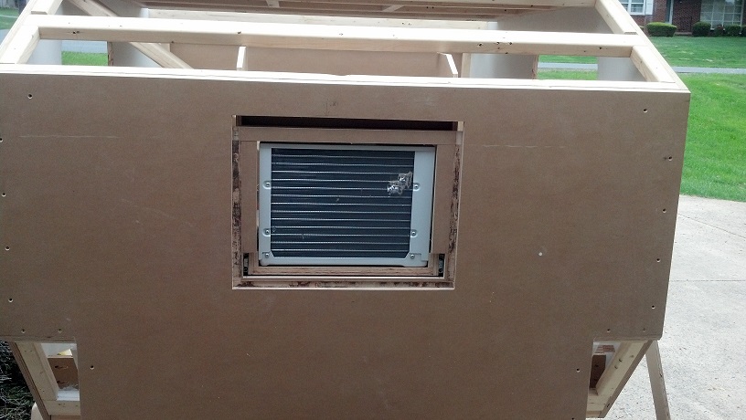

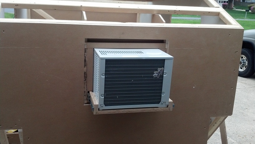

We accomplished our goal, the air conditioner is in. :D
20140509 AC deployed small.jpg (115.73 KiB) Viewed 2302 times
It slides back into the tear nicely, a flush door with T-molding and a short hurricane hinge will complete the package.
20140509 AC stowed small.jpg (123.29 KiB) Viewed 2302 times
Someone might've dropped an object that mashed some of the AC fins. :oops:

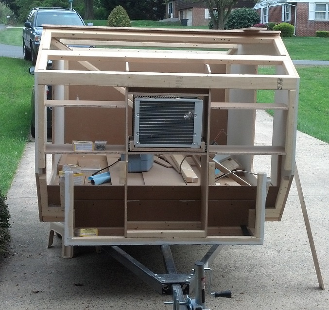

And then we finished the front shelves.
The bottom openings get bottom-hinged doors, middle openings on each side are left open and the top openings get sliding doors.
20140509 front shelves small.jpg (183.56 KiB) Viewed 2302 times

Take a tiny flat blade screw driver (or better yet an HVAC fin comb) and very carefully re-set those fins. You'd be surprised how easy it is to make them look half way decent again (and functioning). Just take your time. :thumbsup:
Re: 4-Day Weekender - AC installed
Postby capnTelescope » Fri May 09, 2014 10:33 pm
"Let he who is without (bent) fins cast the first stone." :roll:
KC's got the cure.

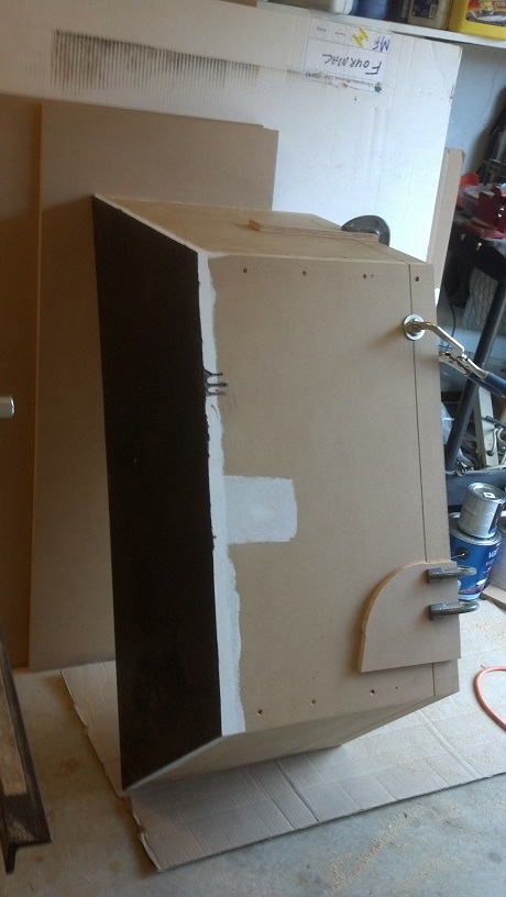

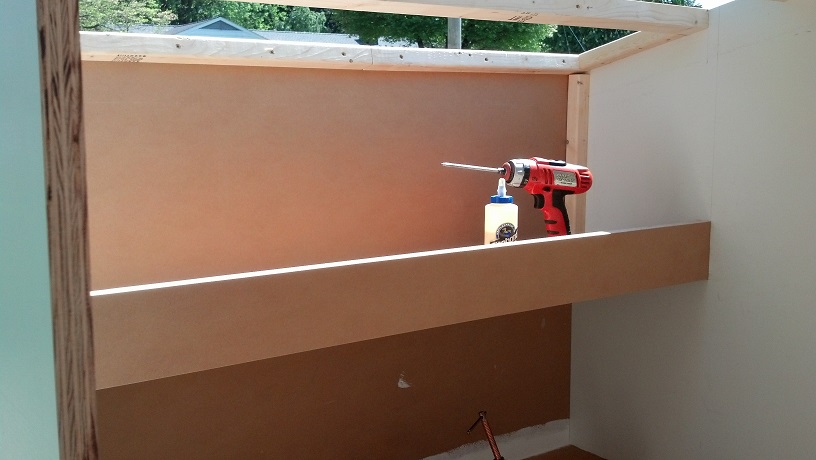

Today I cut the forward cabinets for electrical raceways, I really should have done those earlier when I could have used the table saw, but the Multimax did the job without much fuss. I also cut the doors for the lower headboard cabinets, I haven't decided if I'll do just a finger hole or a hand slot in them, and I need to put a small brace behind each door on the underside of the shelf so that if we lean back on them it won't put all the stress on the hinges.
I also installed part of the foot of the bed cabinet. It has a really high lip because I want to be able to add a sling bed in front of it if our future calls for it. There's a second piece that goes up at the roofline to hold the tops of the sliding doors but I couldn't align and screw it solo so it will have to wait for another day.
20140511 foot cabinet small.jpg (89.46 KiB) Viewed 2216 times

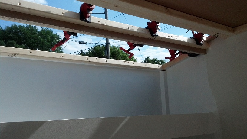

The headboard lower doors are 100% ready for paint, along with a few other pieces. I'm considering clearing out a portion of my basement so I can paint there rather than wait for a 100% clear day to leave the trailer in the driveway while I paint in the garage. I put two coats of primer on the floor and in the storage box (I really should have painted that interior before I attached it to the floor, that was a pain to paint), I'll hold off on the paint until I've finished the walls.
I was able to fit the pieces that will hold the upper sliding door tracks both at the foot of the bed and the headboard, along with their accompanying 2x4s that will hold up the ceiling panels (I'm planning for beadboard, but may go with luan) that will conceal the wiring and insulation.

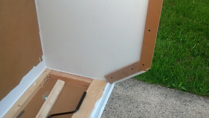

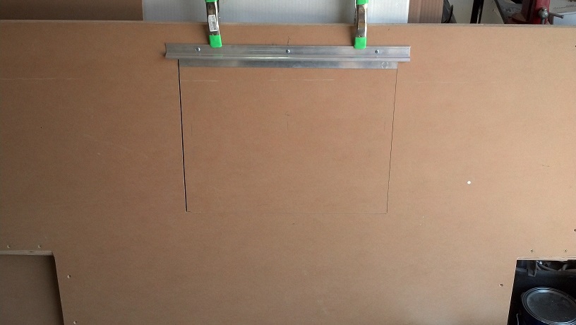

I also fit the hinge for the AC door. I realized after I cut the door part of the hinge that I should have left that side a little long as well, now I'll have to make the T-molding a little long to compensate.
20140518 AC door small.jpg (83.5 KiB) Viewed 2070 times

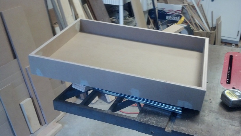

First I put the front and back faces on the oven's drawer.
20140523 oven drawer small.jpg (101.66 KiB) Viewed 1966 times

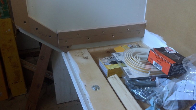

Then I added the jambs for the lower hatch to seal against.
20140523 curb jamb small.jpg (139.21 KiB) Viewed 1966 times
The road-side jamb had to be notched for the panel you can see here, that will offset the slide for the oven drawer by 1/4" so it can slide without scraping on the wall or seal.
20140524 road jamb small.jpg (96.21 KiB) Viewed 1966 times

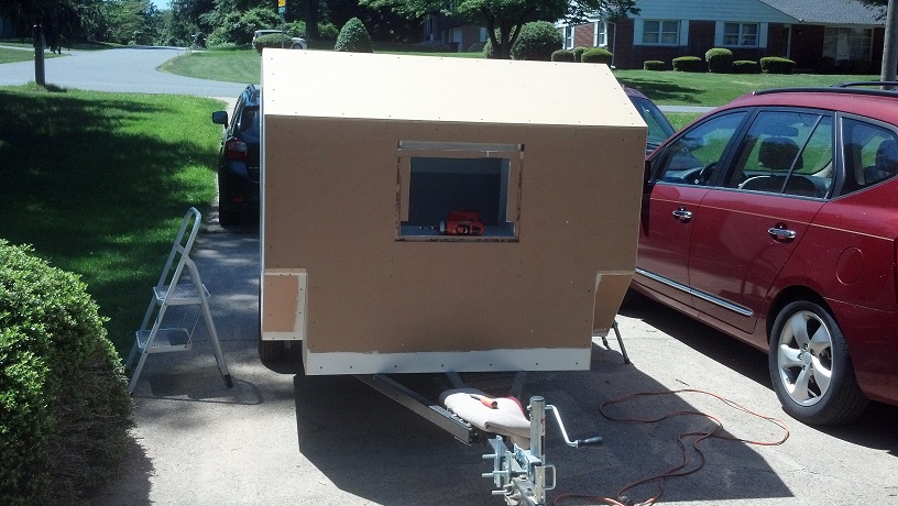

It was a bit of a slow week for trailer progress, but today we managed to glue, countersink and screw down all of the exterior panels.

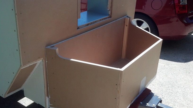

Then we cut the tongue box for the lid style I wanted.
20140601 cutting tongue box small.jpg (95.88 KiB) Viewed 1894 times
To get this finished product:
