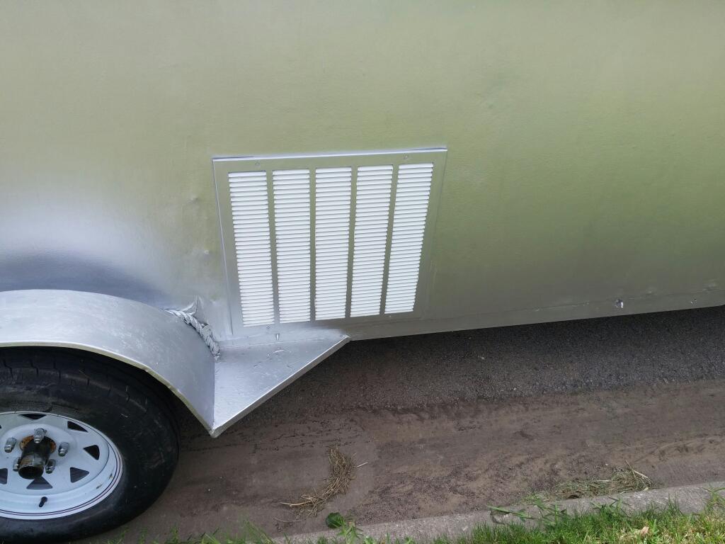

On the morning of departure I stopped at home depot and bought a air return grill for the AC. They only had white, so I painted it with the last of my touch up paint. As joked about, I did indeed hit the road Wednesday morning with wet paint.
Is it me, or with the big grill over the a.c., does it kind of look like a big robot head?

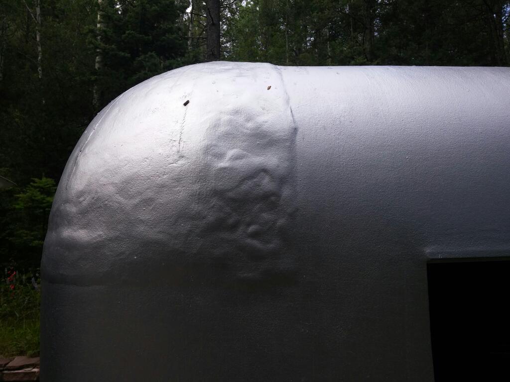

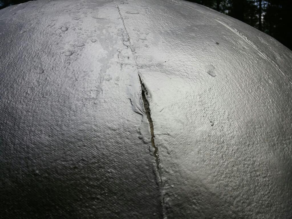

When I picked up the trailer from storage on Monday morning, the corners had clearly continued to expand as they were much lumpier and are starting to split the seams in places.
I'm wondering if the altitude might be the culprit. Built at 500ft, used at 5000ft. Definitely shows that the expanding foam in large forms is unstable. I might need to cut the corners out and do the stacked arches of the pink stuff after all.
