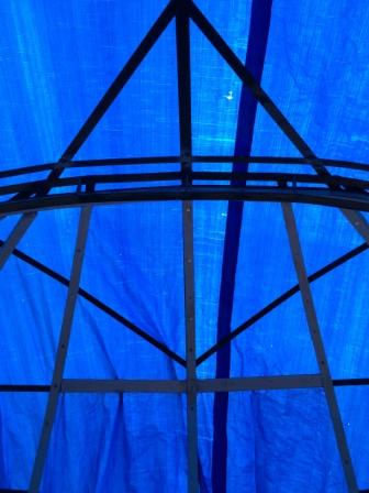

today's update---still chuggin' along with the sticks----popping in steel when i think i need it. for instance---- ceiling backing over the doors. had to zap in some straps. nearly completed the interior studs now. tomorrow (sunday) i will put in some more wee angle tabs to help secure the flooring, and start gutting the cargo trailer. having a party here on the 12th----a perfect time to get help lifting thunderdome onto its new platform !!
pl fest.JPG (28.65 KiB) Viewed 1778 times

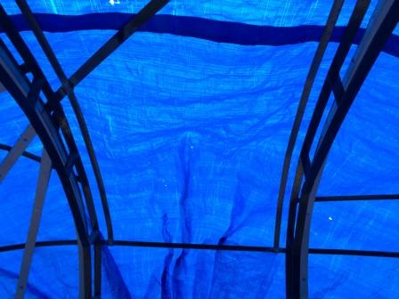

below--- just over one of the doors
centre ceiling.JPG (26.74 KiB) Viewed 1778 times
this is just over the front windows
over the front window.JPG (25.67 KiB) Viewed 1778 times

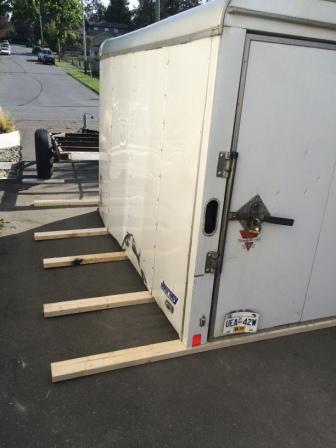

holy ____ that was a noisy operation. i stood inside, set my eye on the horizon, and lay waste to the four directions with a sawzall !
vladimir traileroff.JPG (21.88 KiB) Viewed 1687 times
zipped all the crud off and wire brushed and methyl hydrated and painted with tremclad. i'll be replacing the back end after the new buggy goes on top....

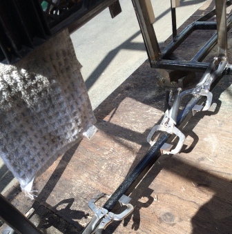

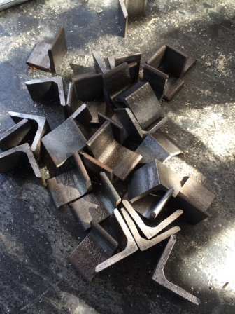

cut a few dozen tabs today to help hold the floor down----
tabs tabs tabs.JPG (92.72 KiB) Viewed 1686 times
i plan on about 6 pieces of flooring so i can recycle that sacrificial bulkhead plywood from earlier in the build
so these tabs will come in handy. in the case of floor rot it MAY be less work later if i have more pieces of floor ?----

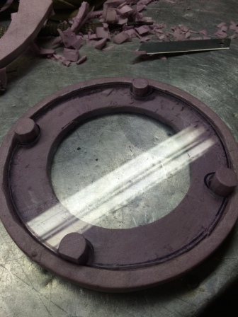

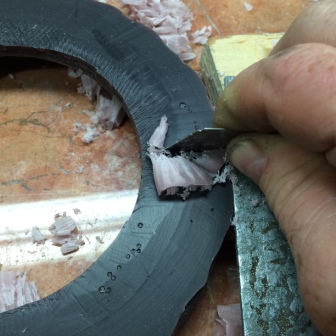

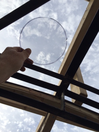

because i had to wait for the neighbour to go out before i could make my noise this morning---i thought i would give a stab at the wee 4" portal windows that we want along the roof.
they will be aluminum, and rife with personality (imperfections)
step 1 : plexi and placement
step 2 : foam porthole mock-up
foam porthole mockup.JPG (66.28 KiB) Viewed 1686 times
step 3: silicone mold. darn foam is all floaty !
silicone mold.JPG (78.39 KiB) Viewed 1686 times
:beer:
renaissance man-----MUST....MAKE......EVERYTHING !! (wife interjects here---"EXCEPT MONEY !")
dave campbell
Posts: 124
Joined: Mon Jul 13, 2015 5:07 pm
Re: go ahead, call me crazy !
Postby dave campbell » Wed Sep 09, 2015 3:02 am

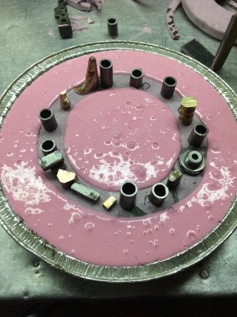

porthole continued-----

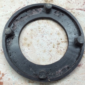

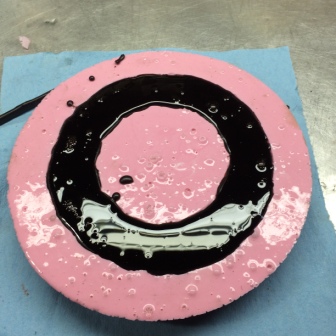

step 4 : hot wax
hot wax.JPG (54.67 KiB) Viewed 1683 times
step 5 : whole lotta love
step 6: ready for the sand mold soon (maybe some rivet detail ?)
the four tabs are there so i can bolt these on from the inside....
wax porthole.JPG (63.42 KiB) Viewed 1683 times

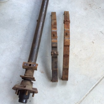

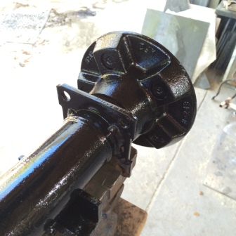

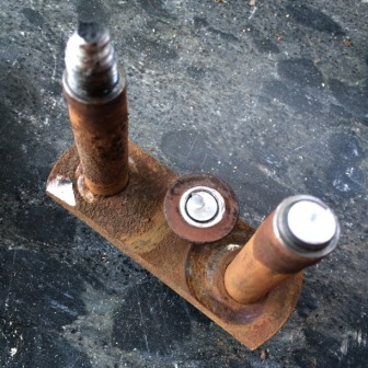

latest update from campbell's machine shop----removed the axle and springs yesterday, so this afternoon i took the angle grinders and brushes to them. also yesterday i zapped on the rearmost bar of the chassis, and painted it today along with a couple nice coats of tremclad gloss black rust paint. methyl hydrate to everything before paint.
new bolts to hold the leaf springs to the chassis---as the old ones were in rough shape. i actually sheared the threaded section of one of them right off. all others i restored---wire wheel, re-tapped etc....
here's the pics-----
axel and leaf.JPG (32.28 KiB) Viewed 1613 times
silver springs.JPG (59.03 KiB) Viewed 1613 times
black axel.JPG (48.31 KiB) Viewed 1613 times

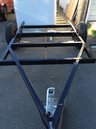

Postby dave campbell » Thu Sep 10, 2015 8:31 pm
a few more shots---

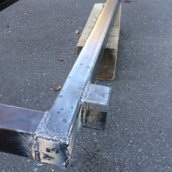

the base of the new unit was supposed to have one of the cross-bars sitting on the rearmost bar of the donor chassis (which was 5" front to back, 60 side to side) but that bar was rotten and (not thinking) i replaced it with 2X3 stock---to match the rest of the chassis.
thus the extra tabs on the back
new rear bar.JPG (61.37 KiB) Viewed 1610 times

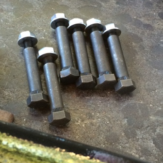

these bolts were 3.50 apiece--- and the girl at the desk was also going to charge me 3.50 each for the nuts as well ! i saw her write it down and total it so....
me------"i'll just by those elsewhere thanks. they should be 50, MAYBE 85 cents at the most "
her----"well that's what it says on the box...."
me (goes to look) "holy cr__ they ARE 3.50 each for a friggin' nut..."
other girl-----"i'll go ask the boss because that seems weird (exits room)
and so on this goes between 3 of us and the mystery boss for a few minutes until the second girl comes back and says----"hey says to give them to you as a combo for 3.75 for a nut and bolt"
meanwhile i had already paid for the other stuff and the first girl wasn't interested in another transaction so i got them for free !
new gear.JPG (59.04 KiB) Viewed 1610 times
