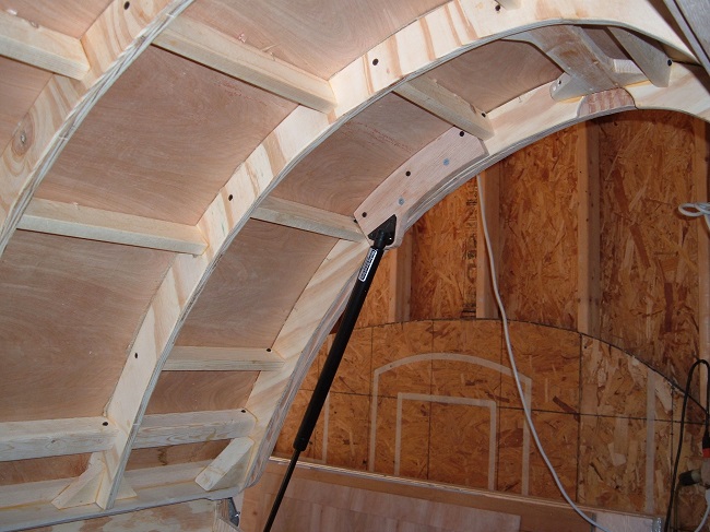

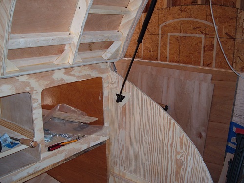

Been winning a few and losing a few here the past couple days. I've got both struts mounted. Turns out the 115# struts I guessed at, are way way too powerful. One strut alone was lifting the hatch by itself 95% of the way. A slight touch with your finger and it was full raised. Plus it took a good tug to get it come down. I just guessed at strut power from going by what others have stated they used. I knew I was most likely going to have to swap them out to get them right. I did make sure that multiple pressures were available in the exact dimension struts I used before I picked these.
Another thing I noticed is that the struts keep pushing back through their whole travel from open to close. Some people have stated that at a point near closing the struts begin to help with shutting the hatch. No way with mine. As a matter of fact they get tougher to push down the further down I close the hatch. My first guess is it's partly because of how ridiculously over powered they are. I am fairly certain the geometry is right as the strut travels.
Since the cabin ceiling is not in, or galley cabinets in, I can see into the strut area. They move/travel fine with no binding, or hitting any thing. The have a slight downward angle to them when the hatch is closed. At full open they have some forward angle and are not full vertical. The hatch hinge works smooth as can be too. I do need to lift the hatch very high to get headroom at the low point. At full required lift height the hatch piano hinge is just short being at a 90 degrees from it's closed position.
My setup stacks up like this:
Hatch width" 62"
Hatch length: 53"
Strut to hatch attach point, from hinge center line: 22.5"
Strut to hath attach point, down from hatch surface: 3"
Strut full extend length: 27"
Strut full closed length: 15.5"
Strut full closed position, distance between wall and hatch mount points: 16.25"
Plus just now I cobbled up a platform to set my bathroom scale on . With the hatch somewhat level ( hard to tell when comparing to a curved surface) or aprox halfway through its travel, I get 44.5# with a stick from the hatch strut attach mount ball to the scale.
Below are a couple pic's of dry fit up. For now all brackets are just screwed in place. The can be moved if required. I also found I had room to space the lower mount from the wall by 3/8" and still clear my galley cabinet door. I did so to get the strut straighter. The struts do operate at a slight left to right angle due to hatch mount bracket thickness, location on inside hatch rail, and so forth. It's not much of an angle and well within the limits of the travel of the strut ball mounts. I do not have any kind of bind at mounts.
I realize that I have such low mount point weight because of how far away from the hinge the hatch mount point is. However I also want enough strut lift power to keep the hatch solid open on a windy day. So my guess is to order a set of 50# and 60# struts. Return which ever does not work. Please feel free to chime in with your thoughts on what to order, and why. Round trip strut shipping is $20 a pop. So I'm going to place another $20 bet on the strut roulette wheel and see how I do. That's the reason for ordering 2 different lift pressures this time. Same $20 bet to get both sets here. :thinking: I have not placed an order yet for replacement struts. Look forward to any input on what choices to make.

I'm certainly no expert and have never mounted gas struts, but the gas strut calculator spreadsheet says different. Many people say it worked exactly right when it came time for them to mount their struts.
Using 53" as the overall hatch length, 11.5" as the stroke length, 22.5" as the spring attachment to hinge center point, and 44.5 as hatch dead weight it shows a strut force of 29 lbs.
IF this is correct (someone please double check me) then I'd order a set of 30#, but if you want to order 2 and return 1, I'd get 30# and 40#.

Does your hatch weigh 33 pounds? Are the struts opening a bit near the end of the close? the stresses on the parts depends a lot on where they are mounted. Mount closer to the ends and less force is needed. I assume the struts are strong enough to max out their travel or are limited by the hinge. Putting force on it. I assume the struts are able to hold the hatch from blowing open further?

Well it might be time for a broomstick hatch support. I got this first set of struts off eBay. I emailed seller and he is saying that once installed struts are now "used" and he can't sell as new. His return policy does not state that. Just says returns accepted within 30 days. So I sent them back to him. Plus notified ebay and paypal of the return. So that's hassle #1.
Hassle#2 is the local auto parts stores offer struts that are twice the price and just a tad not right in length or force. So not to thrilled about that way either.
Found another online source that is reasonable price like the first set I bought. However shipping will be on me both ways, if I need to exchange or return.
I'm going to work on a different part of the project for a while, and think over what I'm going to do here with this hatch support stuff.
Thanks for the input on the struts guys. I may still pursue the gas setup. Just had my fill of it for a bit right now.

Once some of the frustration wore off, I looked more online for more gas struts. I did try McMaster, thanks for that tip, but did not have what I wanted. Found another supplier with large selection of several struts of the right specs. So I called them first about return policy. They assured me no hassle exchanges. Just how it goes with these things. Their price was higher but they had a free shipping special. That brought them within a buck or two of competitors price after shipping.
So I ordered a pair of 30lb struts. Homebrewer ran my spec's for me on the sites strut calculator. Thanks for that as I do not have a spreadsheet program on my laptop to use that calculator with. So we shall see how it goes this time. I still have some free return shipping thru PayPal. So if some returns are required, to get this right, so be it.

Still fooling with the struts. The 30# units turned out to be way too light. I appreciate the help from the forum here for running the calculations. I think because mine mount in a very different location from what that calculator was geared for, it was not the right setup for me.
Grumpy guy strut seller from ebay refunded me after all for that first set I bought. So all he did was lose my repeat business. No big deal. I've got a new strut supplier who has no problem with returns. They ship to me for free. PayPal pays for return shipping. So that works out okay.
So now I know whats too much strut and too little strut pressure. Maybe this time my WAG as to what they should be, will be helped along by what I now know. I also realized I needed to allow for the hatch gaining a few pounds too. I still have to it add canvas and glue outer skin, 3-4 coats of paint, hatch lock bolts and T handle, wiring, galley light, and 4 tail lights. I've reordered a set of 60# and 70# struts and hope one or the other does it this time.

I have not had the hatch off since it was built. So no way to weigh it loose. My 60-70# strut guess this time is based on how it felt to lift it with the two 30# struts installed. The 30# ones gave some help on the way up, but could not hold it up or full open.
