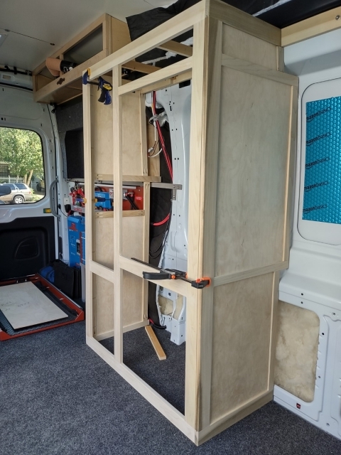

Postby noseoil » Mon Aug 29, 2022 8:43 am
For aircraft cabinets, scribe to the interior panels, grind with a small wheel, fit, scribe, fit, scribe & "presto" a cabinet which fits to the air frame & interior panels.
I would use cardboard panels & tape to fit the sides, top & bottom of each piece. Once the cabinet is assembled, trial fit to the structure, check for gaps, grind & fit again. Then, once it's a good fit, fasten it in place. It's a lot of work which requires some thinking & careful cutting & grinding, but it works well enough after a bit of practice.
The "easy" way it to cut things a bit short, then tape & wax where the cabinet will fit to structure & panels, apply Bondo to the edges & let it sit. Finish the cabinet (laminate) & install...
It's a major PITA, but it works.

Postby bdosborn » Mon Aug 29, 2022 9:16 am
noseoil wrote:I would use cardboard panels & tape to fit the sides, top & bottom of each piece. Once the cabinet is assembled, trial fit to the structure, check for gaps, grind & fit again. Then, once it's a good fit, fasten it in place. It's a lot of work which requires some thinking & careful cutting & grinding, but it works well enough after a bit of practice.
That's exactly what I did, what a PITA. :fb
It's no wonder that some people prefer the Promaster van; it's a lot more square that the Transit.

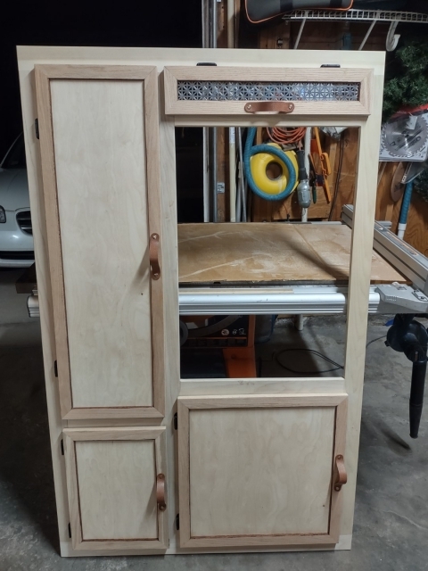

I've got all the cabinet doors and sides made:
And I took everything apart so I can start applying the finish. Thankfully, most of the Oh Glorious Sanding is done. I'm really looking forward to getting this part of the build done.

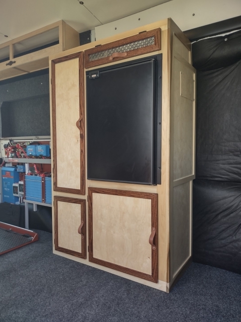

Postby bdosborn » Wed Sep 07, 2022 9:02 am
Success! I got the fridge cabinet finished and installed. I think it looks pretty darn spiffy!
