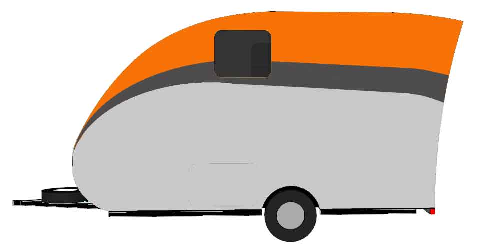

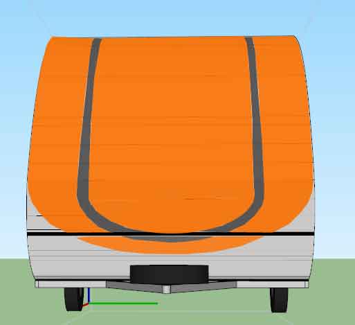

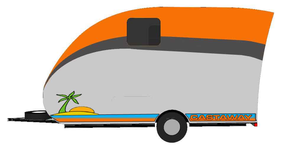

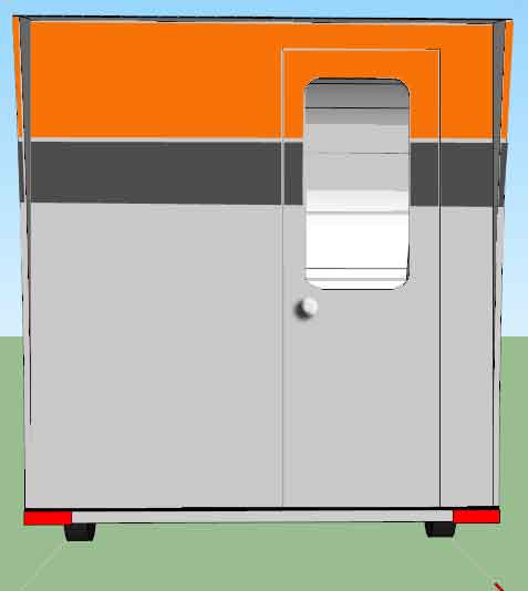

As for paint, this:
Martiangod wrote:Image
Looks really good to me, so I'll go with it. Chris, your idea for paint looks way better than anything I was able to come up with when I was sketching on paper. :lol:
I think the front being orange will be too much, so the orange area on this will be white, and the U shape will be orange:

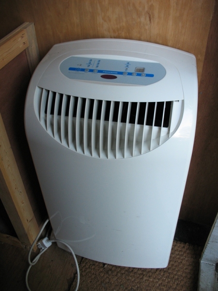

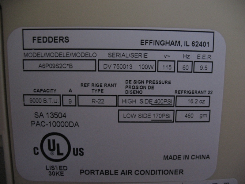

First off, the tiny 4300 BTU AC unit I had wasn't cutting it, so I'm upgrading to this:
Yay BTUs!

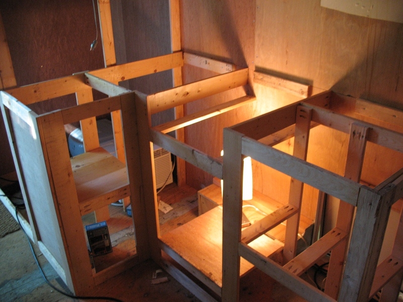

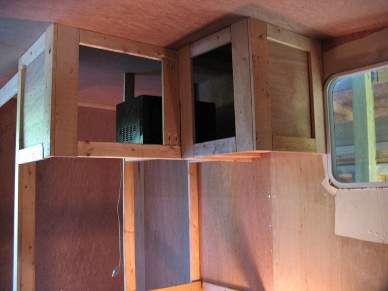

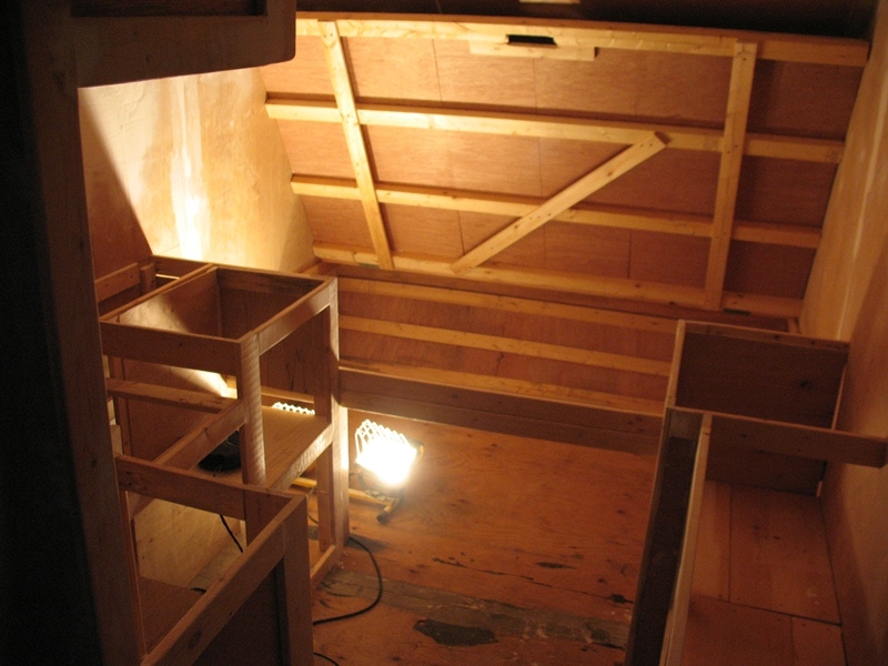

Cabinets coming together:
Top cabinet, where the microwave will go:
Shelves going in passenger side:

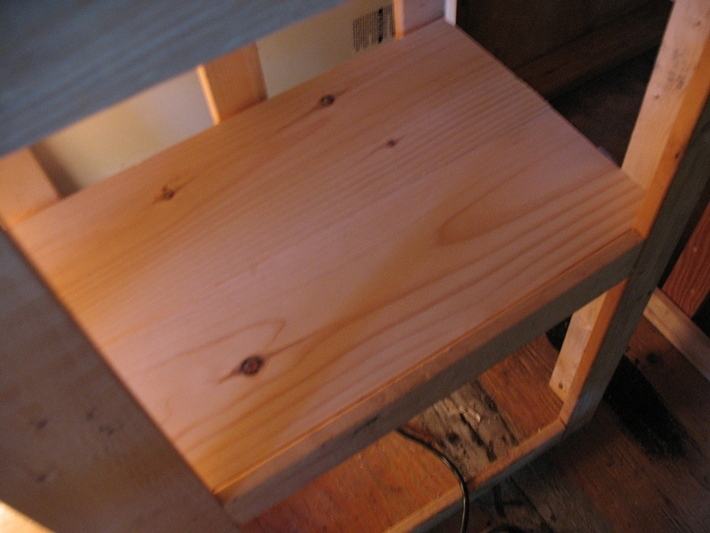

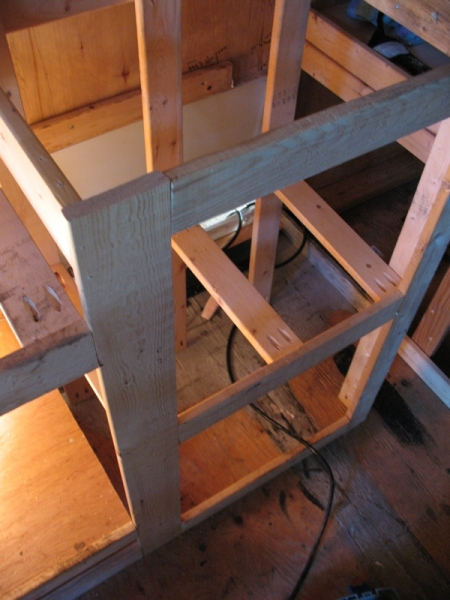

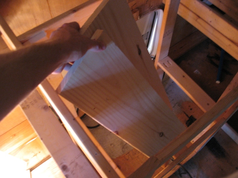

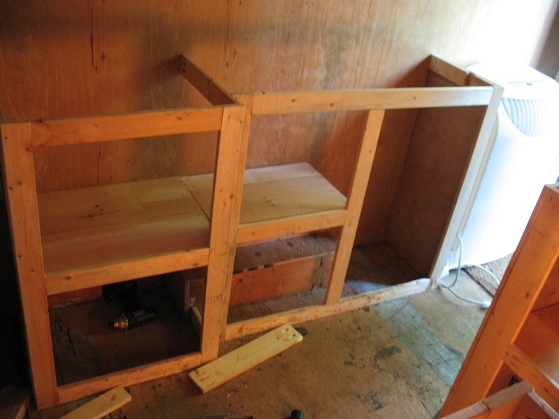

Real quick, here's how I did the shelves... Start by putting support pieces across the bottom:
Cut a couple of pine boards to size:
Nail those splintery monsters into place:
...Then repeat for all the shelves. :lol:

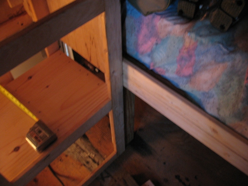

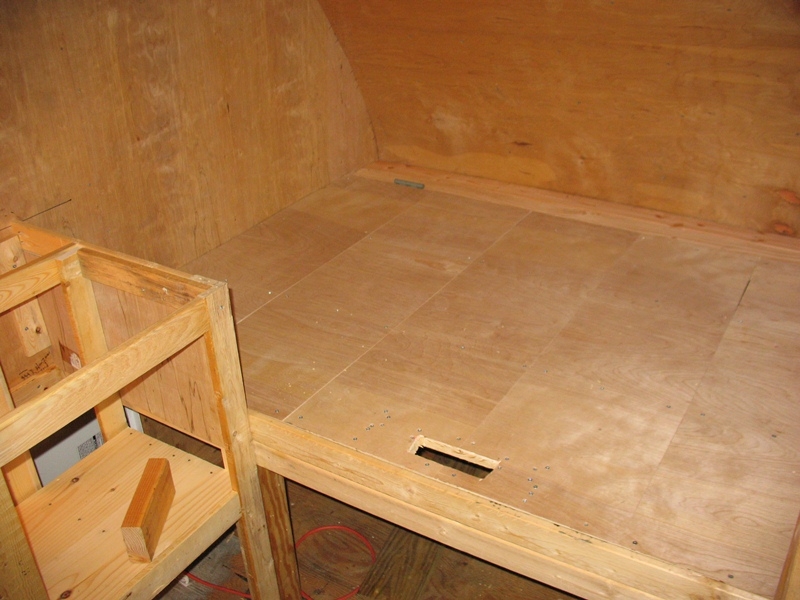

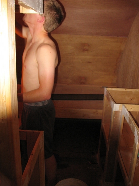

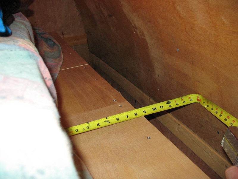

I had a bit more time that night, so I went ahead and increased the sleeping area, per the boss (my wife's) request...
Before:
After:
About 7 more inches! I can probably cram a full-sized bed in here now:

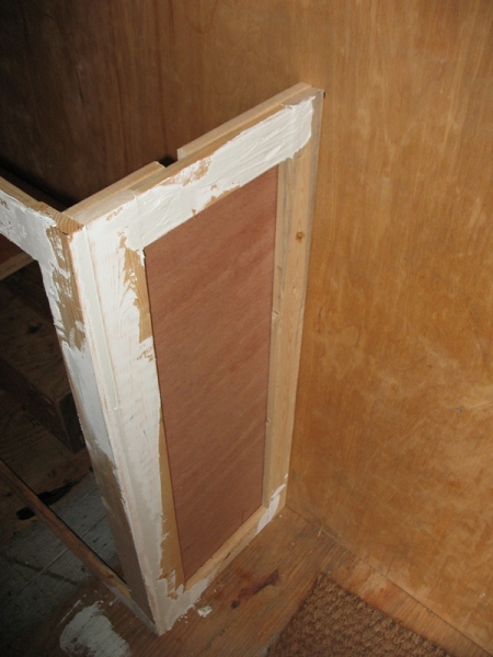

I added hinges and filled in the gap:
Woodworking was pretty much done, so I spackled the next work day...

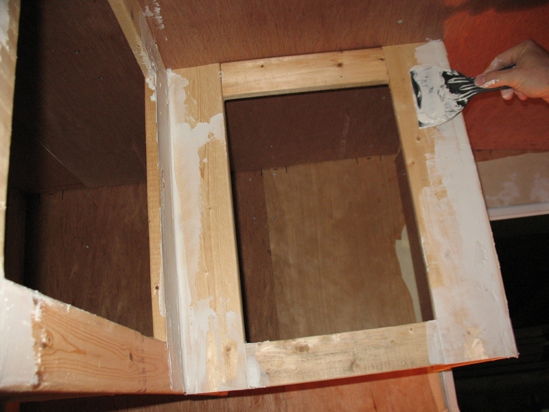

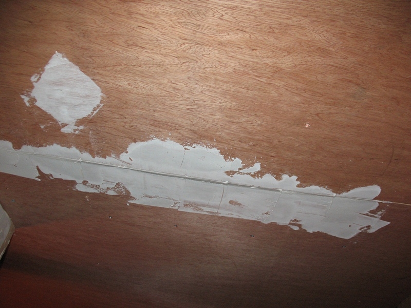

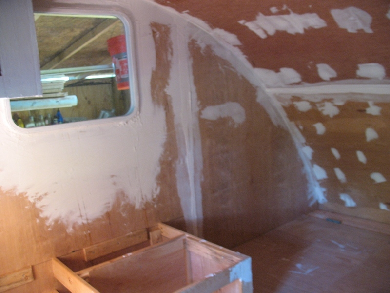

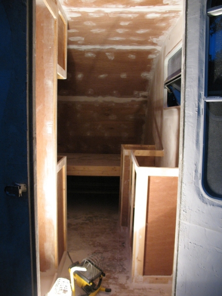

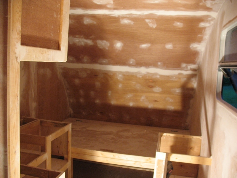

Back to building though, I used spackle on the wood to smooth seams and cover blemishes. It'll all get painted white anyways, so no need to waste coin on fancy wood putty when I have drywall spackle laying around.
More spackle:
Spackling the roof:
Each seam and screwhole got a good coat:

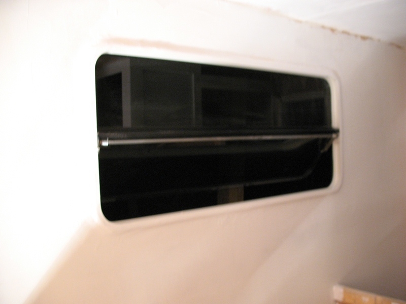

Also, spackled around the windows to smooth them out. My windows were under $30 each from Ebay, and none came with trim rings. So, they're in there with liquid nails... I used a LOT of spackle to smooth them against the walls:

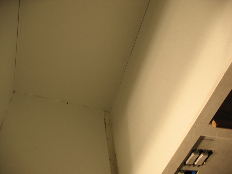

FINALLY done with spackling:
Even though it doesn't look like much, that's easily 20 hours of spreading spackle over a week. :thumbdown:

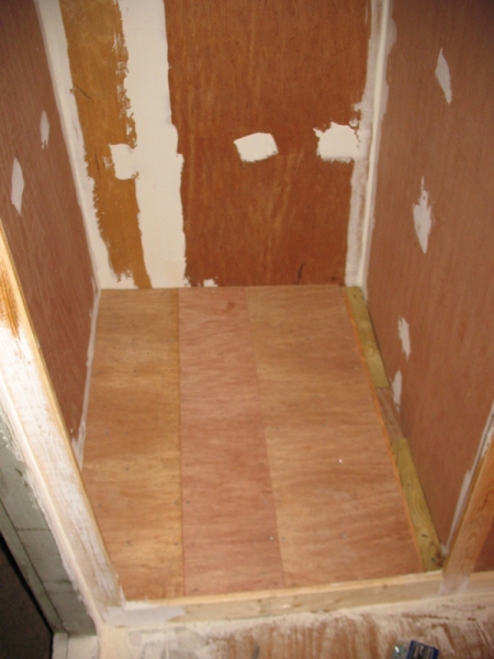

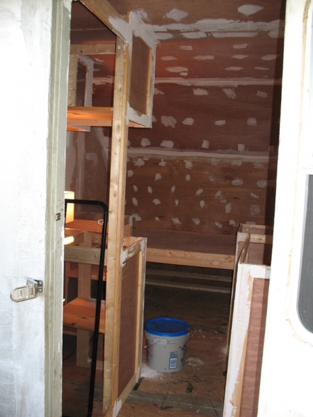

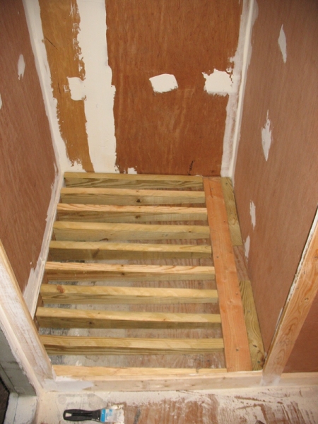

I went ahead and put up the bathroom wall to spackle/smooth it too. I'll probably fiberglass the whole interior, but a flat surface will be easier to work with. Here's the wall up as I started sanding:

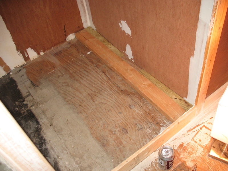

Here's the floor:
It'll taper down to a drain in the side there:
At this point, I was out of luaun plywood, so I sheathed with 3 scraps:

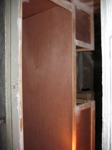

I also realized I had forgotten to add the wall on the other side of the bathroom, under the kitchen cabinets. I added it after I had sanded some, which is why this looks half-sanded, half-crap, all mess. :R

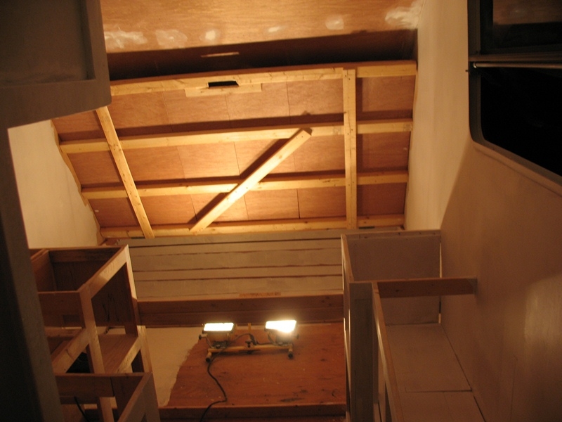

I pulled the trailer out so that dust wouldn't blow over all my tools in the carport... There is a LOT of dust...
Just look at that layer of dust. Crazy.
It all looks nice and smoooooth after sanding:
HELP DUST EVERYWHERE
End result was nice and clean again though!

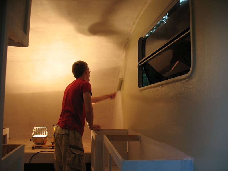

Re: The Pup's Penthouse - 7/2/12 - Starting interior paint
Postby synaps3 » Mon Jul 02, 2012 11:22 pm

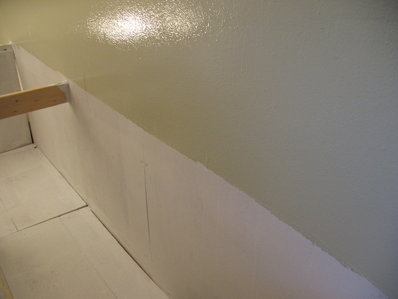

I started painting everywhere, but didn't quite finish. The below is from 3 hours of painting:
The finish is nice and smooth, the sanding was worth the effort. I definitely have at least another 3 or 4 hours of painting left now.

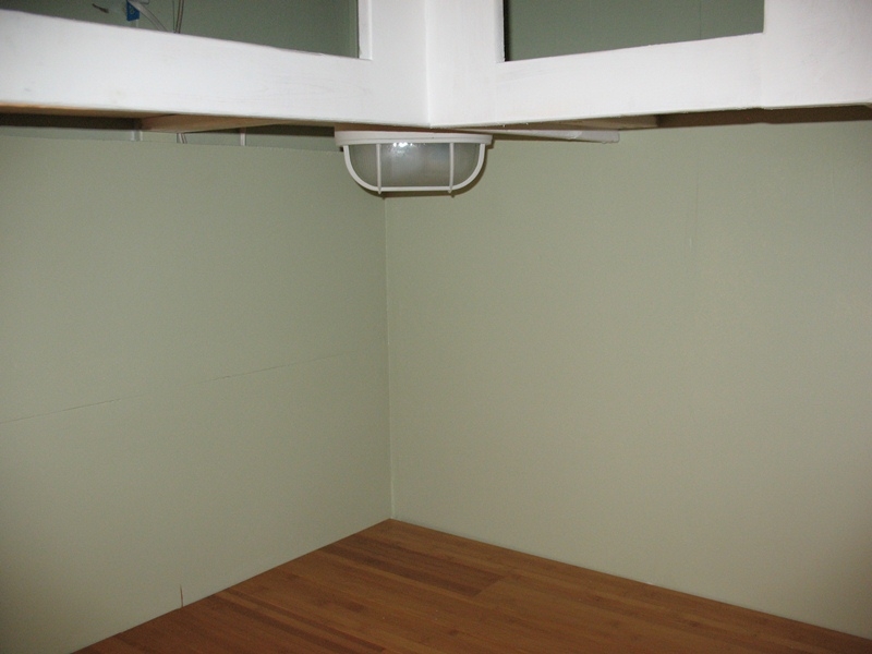

Being ever the budget-conscious individual, I mixed all the random paint in my shed. I had some white, yellow, and two greens... It turned out pretty!
Dead cans
Maddiedog had to stay inside during paint, I didn't want her getting paint on paws. :lol:
Time to roll it on:
Pretty colors:

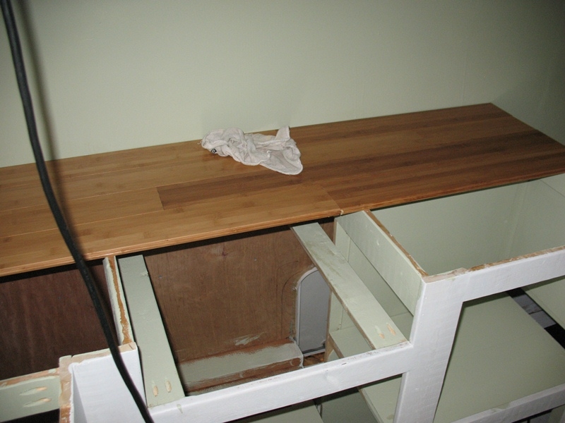

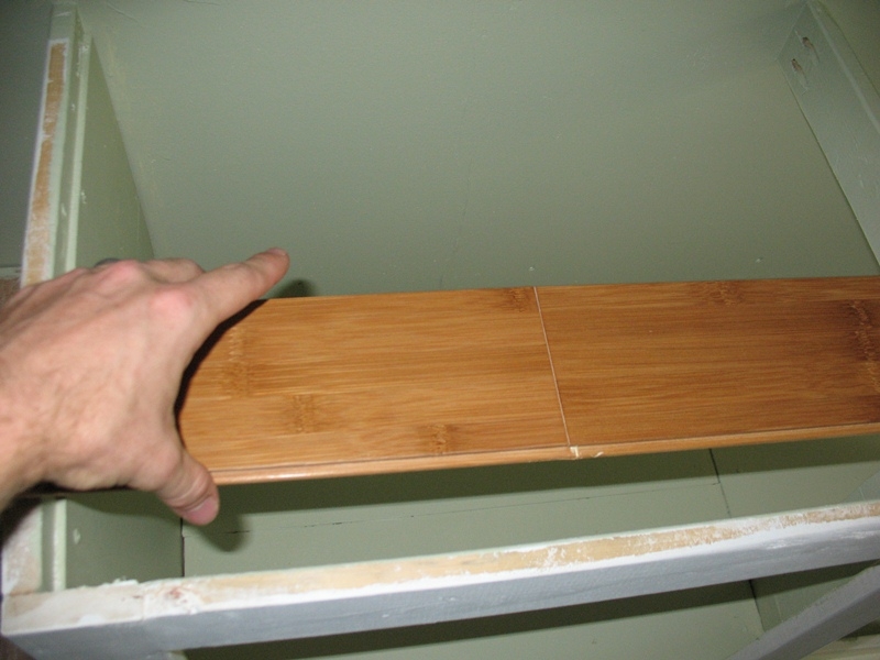

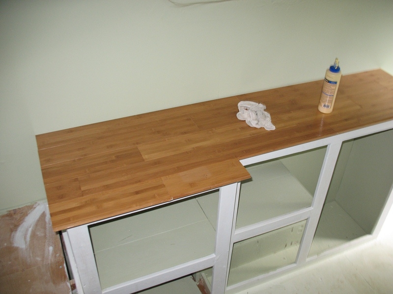

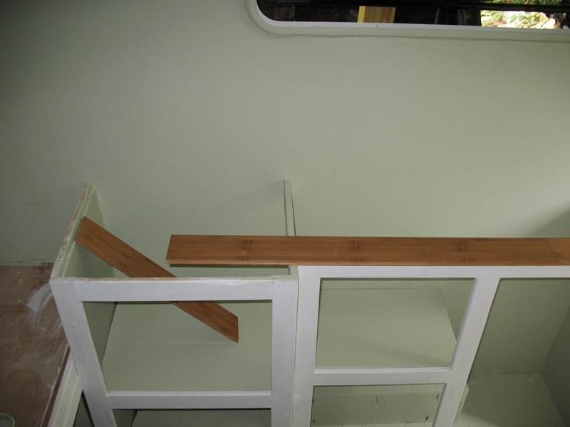

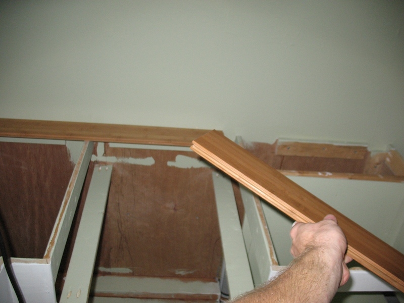

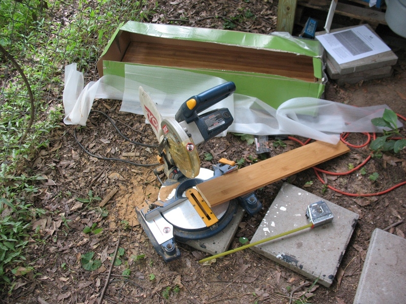

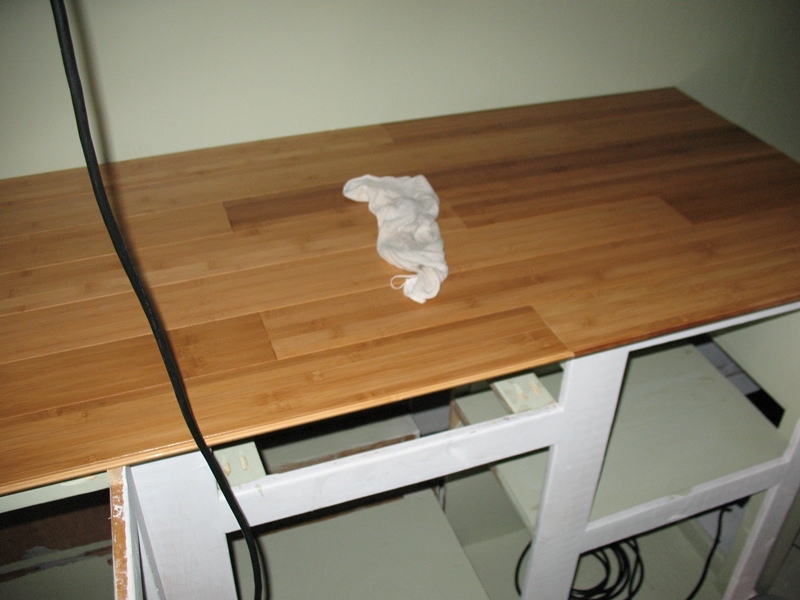

Up next, I started the countertops.

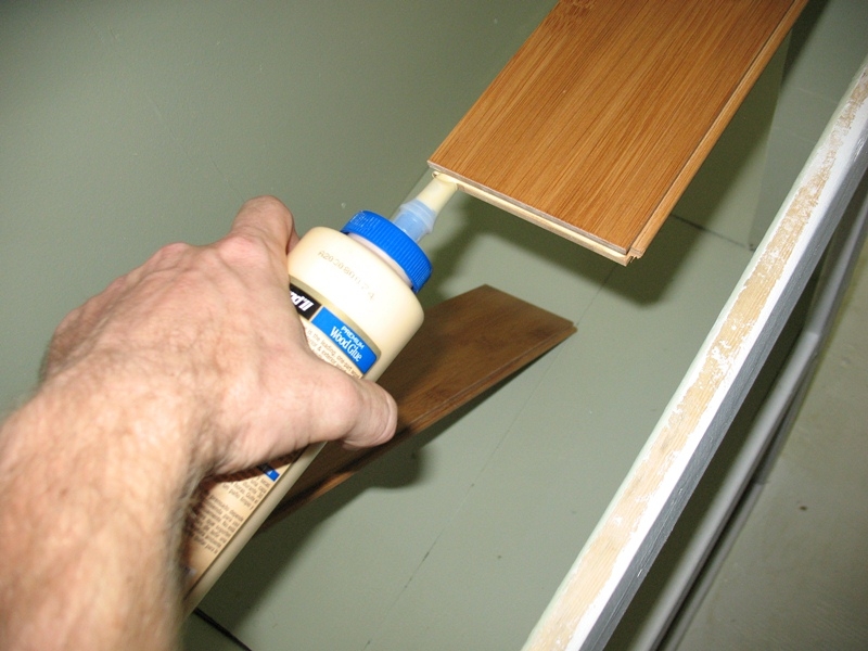

I'm using bamboo flooring. It's cheaper than countertops (formica or otherwise), lighter, and I love the way it looks. I'll use bamboo flooring on the floor as well, so everything will match and be pretty. I'll have to go back and smooth the edges later.
As with anything else, measure, cut, put in place...
Then repeat:
Also, do the other side:

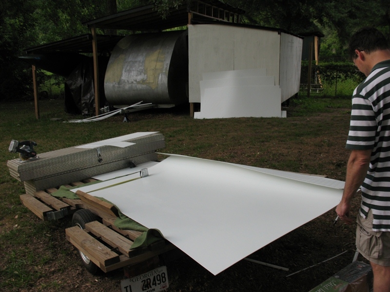

Next, I put up FRP for the shower/bathroom.
FRP was miserable. FRP adhesive is basically liquid nails, and they recommend putting it on like you do tile backing (with a trowel, grooved onto the surface). The FRP adhesive was so horrible, I didn't have a spare second to use the camera without getting adhesive on the camera, or without the adhesive drying. It's horrible crap, and I don't recommend anyone using it. Actually, if I could do it again, I would have just fiberglassed the whole thing. :?
Oh well, live and learn.
My dad came over last Saturday to help. We went to Home Depot, got FRP, and got to work. Here's my dad, pondering how we should proceed:
We used my utility trailer as a sawhorse, because the sawhorses were being used to hold up all the stuff that normally resides in the camper. It's all on a board, on sawhorses, on the leftmost portion of the carport in the picture above. I covered it all in a tarp, to stay dry. I've got my Coleman portable grill, camp chairs, cook gear, the mattress, fridge, AC, etc all under there. Anyways, I digress.
We cut the FRP. It was nasty, and smelled like ghetto napalm (put styrafoam in gasoline, same smell). After cutting and sizing the three pieces, we used the aforementioned AWFUL liquid nails FRP adhesive / horrible doom gunk crap on the walls and started mounting the pieces.
End result was ok, the trim pieces didn't line up, so a bead of caulk will go there:
I still need to caulk the edges and put FRP on the ceiling. It's a mess. Like I said before, never again. :?

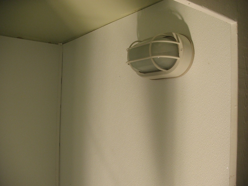

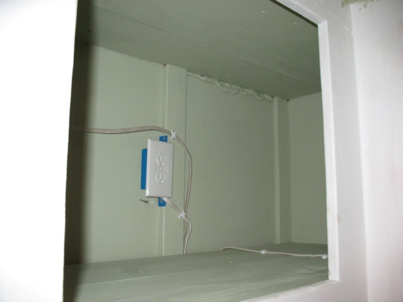

I started my electrical work by wiring the light in the bathroom and the light over the counter.
Both fixtures were cheap, on clearance at Home Depot for under $10 each.
In the bathroom:
Under the cabinet:

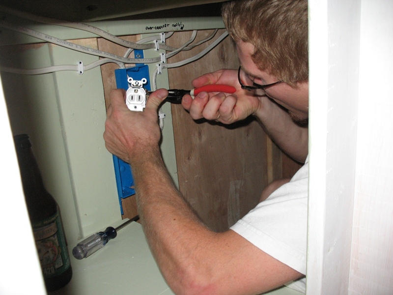

Tonight, I had time to wire the switches for the two lights (actually pictured above in the pictures of FRP -- they were taken today :oops: ), an outlet above the counters for the microwave:
And started wiring an outlet below for the TV:
I'll keep doing wiring the rest of the week, hoping to finish wiring at least by Friday. :thumbsup:
