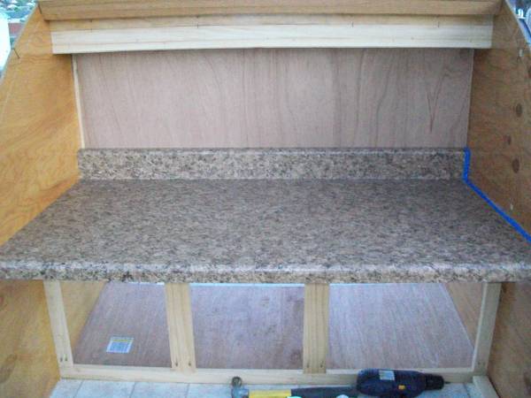

Hi Everyone: I did get a little done today. I was able to finish up the wall studs and I placed the remainder of the blocking for the red oak wall panels to attach to. I need to finish trimming the door openings out tomorrow. I will take pictures of that tomorrow. I went to HD today and bought a four foot counter top that was pre-built. I had to cut 3/4" off one side so it would fit into the opening. I need to cut it so I can fit the sink into it tomorrow. There is a 3/4" overhang under the front edge of it where my lower cabinet face frame will slide in to. It is starting to show progress now.

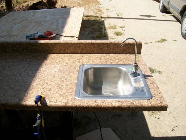

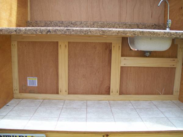

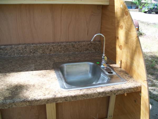

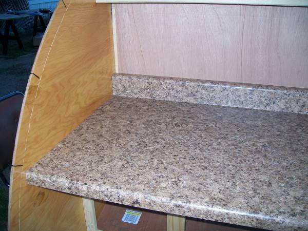

Here is the sink installed in the counter top.
It is just setting in the TD now.
I had to intrude into the cabin to get the sink to fit.
I will build a box to cover the sink from view and make a smaller wire chase along the top of the foot well.
That's what I got done to day. It has been a productive day if you ask me.

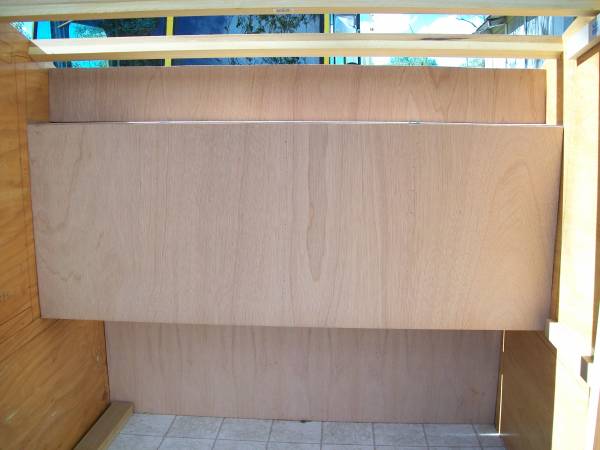

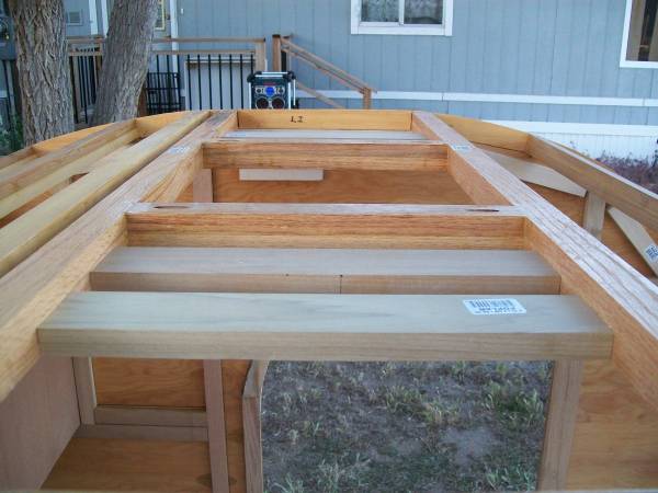

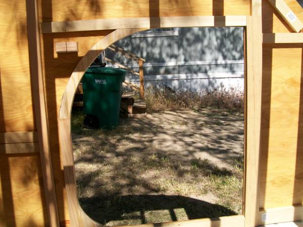

I got back on my TD this morning and got some more done today on the build. I finished up installing the wall studs and blocking for the light switches, porch lights and I finished trimming out the door openings.

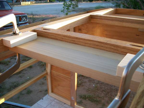

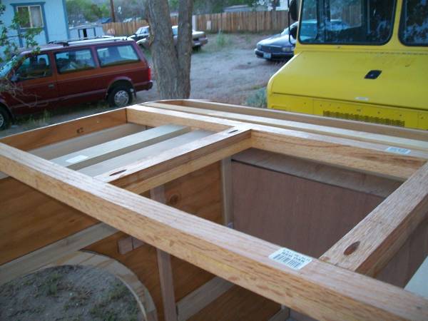

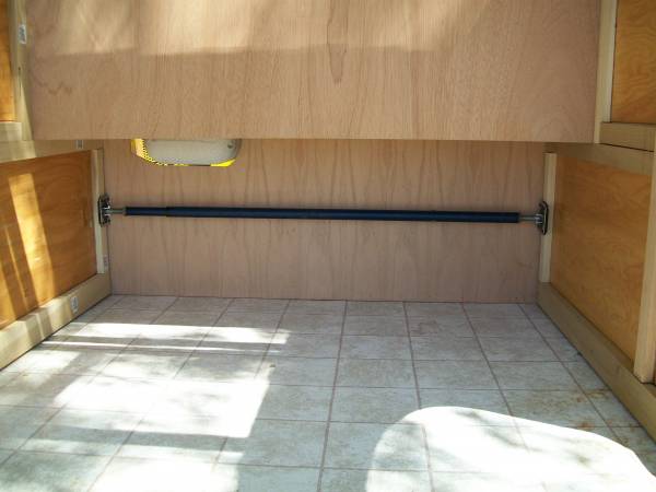

I did not have any help when I placed these rear vertical supports for the wall skins and I had this cargo holding bar in my truck and it would not go as narrow as I needed it to. So I drilled new locking holes it the bar and it worked like a champ. The two holes go straight through the bar and there are spring loaded pins that snap into the holes I drilled. This held the two boards in place so I could glue and screw them in place from the outside of the trailer.
This is what it looks like now with the framing and blocking installed.

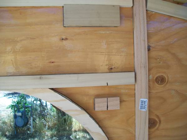

In the next picture, the blocking for the light switches and the larger piece of wood on the top will support the screws for the porch light and are now attached.

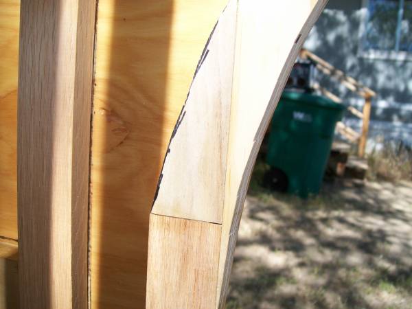

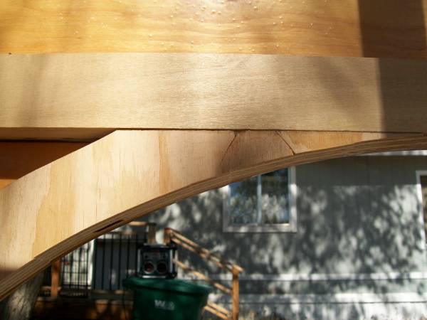

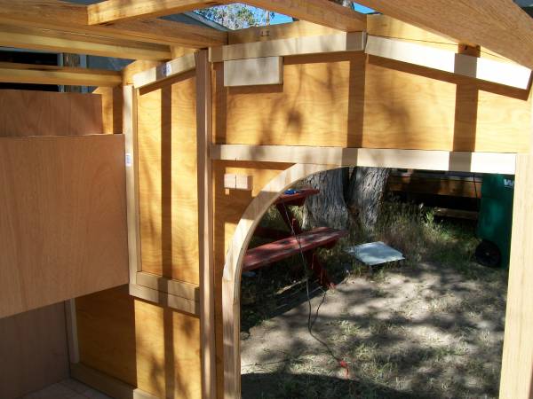

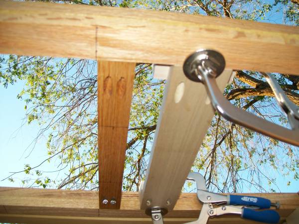

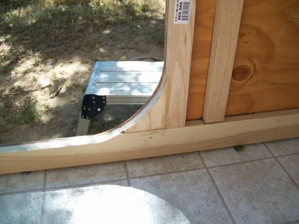

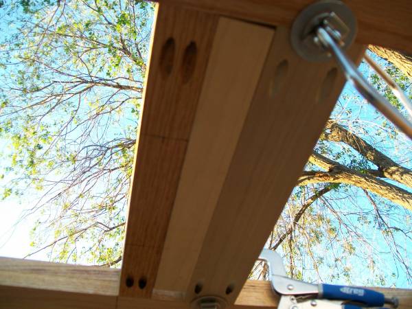

Below you can see how the door opening was trimmed out. I used some oak, some poplar and some 3/4" plywood. You can see the different woods in these next few pictures. I used oak for where the door latch will be attached to. This way the screws will hold better than they would if I used a softer wood.
In this picture you can see all three kinds of wood I used. They are glued to the inside piece of wall plywood and glued to the other types of wood and they butt up together. I used a lot of PL poly adhesive here.
This is at the top of the door opening where it starts to sweep downward on the rear of the opening. I still need to do some finish sanding.

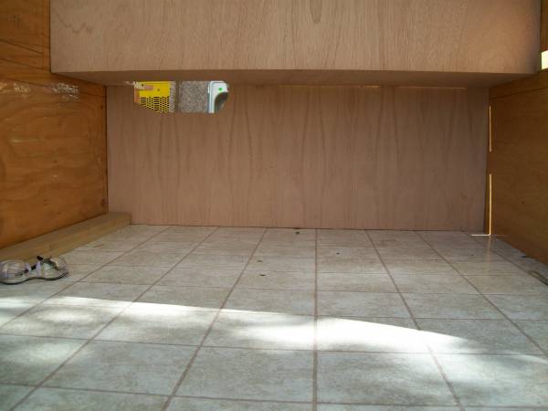

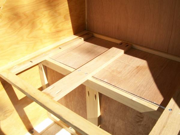

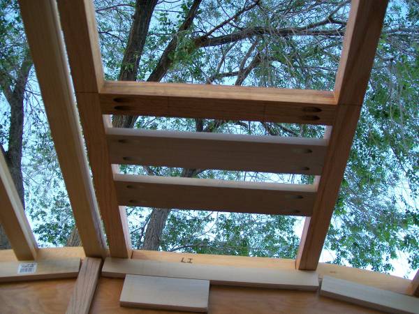

Well I still had some daylight, so I kept building. I added the cabin overhead light bracing. This way I will have some meat to screw into when I install the cabin lights.

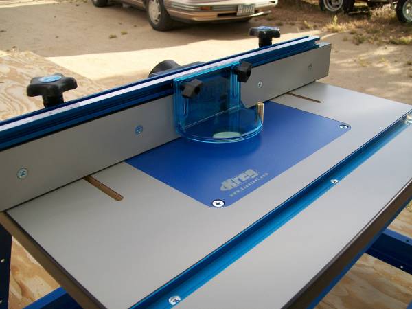

Hey everyone: With all of the overtime I have been putting in at my job lately, I was able to keep some of that OT pay that "Uncle Sam" didn't take for himself. I used some to buy a new tool that I can use on my build here in the near future. I also plan to build and replace the cabinet doors in my kitchen using this tool.
I paid dearly for this Kreg portable bench top router table. $>
It took a while to put together, but this is what it looks like.
I still have to mount the router in the mounting plate. I will do that a little later on.
