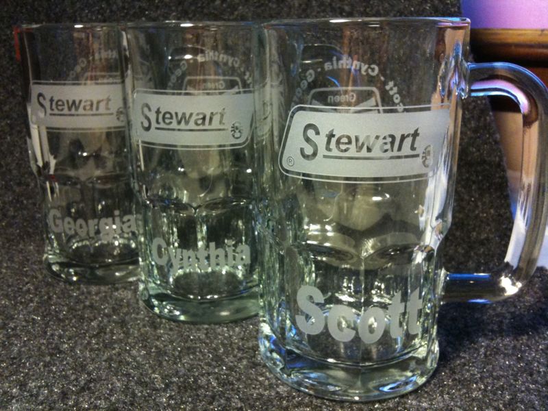

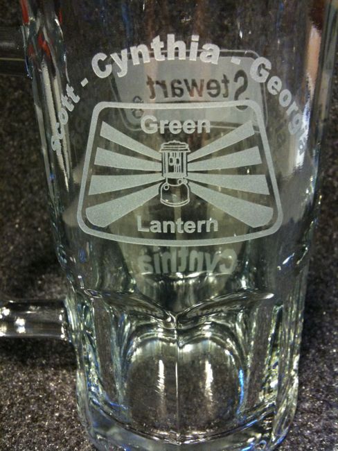

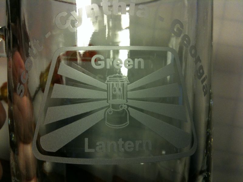

Looky what I have for the Green Lantern build – Darren B at victory graphix did these for us. Darren is a member of this forum. his work can be found at victorygraphix.com
Spectaular Job!
Sorry for such a large picture - but the details are super. Thanks Darren :thumbsup:

those cups are amazing I totally love your theme you jus need to get the little lantern party lights hit,em with some paint I'm kinda curious what are your plans for an awning are going to do that logo really big... can't wait to see more

Glad you like them Scott and thanks for the complements. :thumbsup:

Scott, those mugs are spectacular! What a great addition to the project. :thumbsup:
Darren, you do great work! :applause:

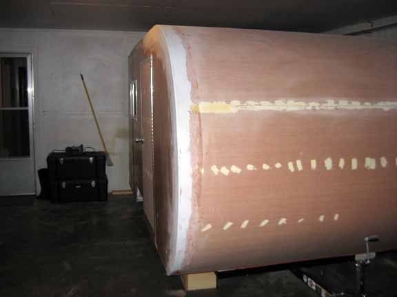

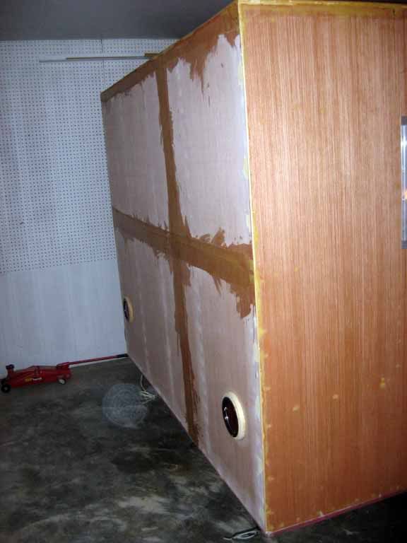

Well the time has arrived – a little warmer weather! My fiberglass tape and epoxy arrived from my good friends at Raka. Got my disposable gloves, cups, spreaders, rollers, etc – all you need for applying the glass tape. I decided to use the fiberglass tape because the edges are sealed and won’t unravel. First I took a router with a round over bit to round the edges - - fiberglass doesn’t really like 90* corners. Then, using the tape, I sealed all the edges followed by a coat on the entire side. I finished by applying a skim coat of filler to hide the tape edges and to smooth everything out – one side done.
Top, back, front, and other side to go. Once all sides are done, contoured, and sanded, It' will get a final coat to encapsulate it. Did I mention that I really do not like sanding?

Another day and more sanding - sanding, sanding, sanding! Oh yeah - did I mention how much sanding I'm doing to this thing! But each day I'm getting closer - I need to take the door off so I can give it a good coating before paint. However this is the last major step before paint and it has to be right for that seamless look - so water just beads up and rolls off the roof, around the curves, and has a straight unobstructed path to the ground! ;)
