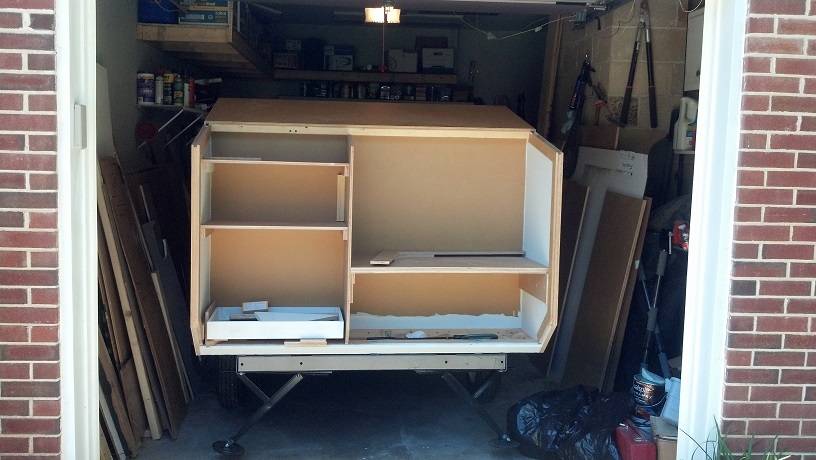

So it has been a busy month with not a lot of trailer progress due to some real-life stuff, now I have to really get back into it and I decided to start with the galley divider, countertop and basic shelves.
The countertop ended up 38" off the ground, so a little higher than a kitchen counter, but I wanted to make sure I'd get 5" tall drawers and 8" of space beneath them (so my camp kitchen and dutch oven will fit). I still need to add a divider and support under the countertop to bear the weight of the drawers, but I have to figure out how much to relieve it so my pie irons, propane tree, etc, will fit in the lower tray underneath the dutch oven, etc.
20140705 galley countertop small.jpg (140.94 KiB) Viewed 2164 times
I decided to leave the center divider the full height to make a shelf so that we can store plates, bowls, etc, up there without using valuable space in the middle cabinet. It will get a front lip, but that will need to wait until the hatch is completed as the lip will be need slots cut in it to accommodate the hatch ribs.

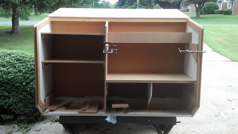

I decided to add a shelf above the countertop in the galley.
20140713 galley shelf small.jpg (137.34 KiB) Viewed 2001 times
The shelf is 9" deep with a 3.75" lip and the countertop is 19" deep, both are 35" wide. The underside of the shelf is 14" above the countertop (I measured a few random things around the kitchen and pantry and thought that was a good compromise). I wouldn't recommend such a large and low shelf for someone that plans to use a two-burner stove on their countertop, but we're not planning to cook in the galley.
The clamps and scraps are to hold it in place while I played around with its vertical position, I've taken the entire galley apart to be painted individually, it will then be screwed together so if I ever get a bigger oven or need to adjust a dimension, I can break it down easily. I have all the wood designated for the under-counter drawers, but I don't have a pneumatic nailer to put them together with so I'll wait until I can borrow one to cut them instead of risking losing one of the pieces.

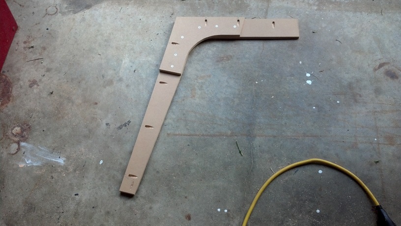

I also forgot to share a picture of my hatch spares when I made them a while back, so here's one of them. The lower panel of the hatch will fold down independently, so this just has to hold the top and rear panels together.
20140713 hatch spar small.jpg (139.5 KiB) Viewed 2001 times
The spar is three pieces of plywood, the upper and lower pieces bisect the angle and then the gusset holds them together. I have four spars in total, two with the gusset on the left, two on the right.
I'm not quite sure what I'll do for hatch props at the moment, there aren't many good places to put one on the oven side, unless I put it really high up. :thinking:

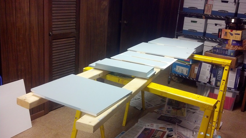

When it gets too dark or unfavorable weather conditions, I head down to the basement to paint all the removable pieces. Here's one of my painting stations, I have another one about the same size set up on the other side of the room.
20140718 paint station small.jpg (134.91 KiB) Viewed 1910 times
From front to back, there are the two pieces to the foot cabinet divider, the two forward lower panels (which were just installed this morning), and the under floor storage compartment covers (yes, one's bigger than the other, measure-once-cut-once didn't work out in my favor that day, I did my math wrong for the centerline and the circular saw's offset :lol: ). Leaning against the wall to the left is the AC door.
