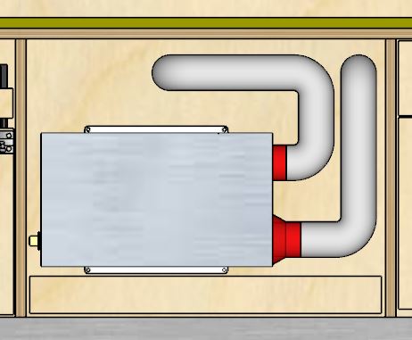

Postby eLink » Wed Jul 17, 2019 7:45 pm
Great idea about the Propex Heater location!
I had planned to mount mine under the deck and run just the ducts up behind the cooler, but your idea makes more sense... No need to worry about damage from the road. Will you be mounting it sideways on the bulkhead?
Like this?
eLink
Posts: 191
Images: 142
Location: Los Angeles
Re: #4
Postby tony.latham » Wed Jul 17, 2019 8:18 pm
It will be flat on the floor behind the cooler. The intake/exhaust lines go straight down through the floor. It looks a little lonely in this photo:
