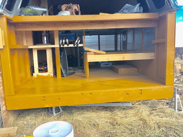

Quite a bit of progress today. Much doesn’t show, but it has been bugging me for a long time. First, the bolts that hold the rear ‘bumper’ had to be removed and countersunk so the rear doors would sit flat across them. The design has changed since they were put in and the doors will now be behind the bumper. There will be a 2x2 across the bottom of the bumper for the doors to sit on for support during travel. I also got the rest of the ugly seal/paint applied to the galley area.
The bed platform isn’t in place in this photo and the countertop has been removed.

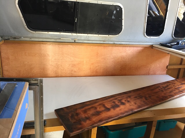

Thanks! I sanded and varnished the galley counter today. I wish I knew the history of this wood. The boards (I had two of them) were 20 feet long, a foot wide and rounded on one edge. Someone suggested ‘stair tread’ material. Could be. But, they are perfect, clear, NO knots. VERY gray. I had to use the belt sander on this one to get some of the color to show through. Must be old growth redwood, no idea how they got here. I found them in my garage when we moved here.

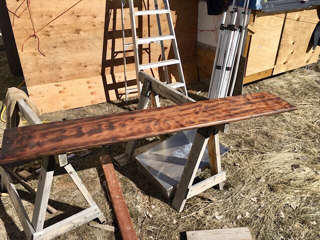

Here’s the galley countertop. I’ll varnish it one more coat tomorrow.

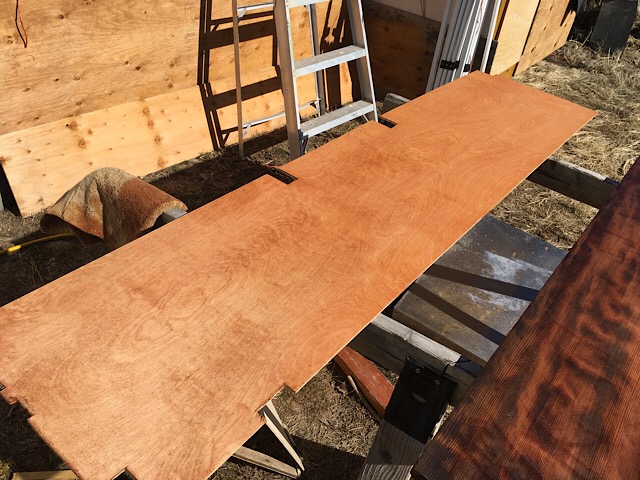

And this is the first piece of paneling with a coat of stain. It will get varnished tomorrow I hope. (Birch, “1/4”) They didn’t have any of the 5/32” underlayment plywood at HD the other day. Even with all those notches... it fits!

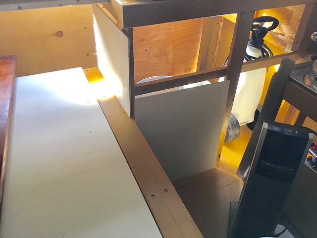

The paneling got a coat of varnish today and the countertop another coat. The paneling is in place in this pic, the countertop just lying on the bed for now. Most of the camper will be paneled with the same stained and varnished birch plywood. All the ugly ‘primer’ will be painted a nice tan color and maybe even the entire topper.
There will of course be a bulkhead between the foot of the bed and the galley.

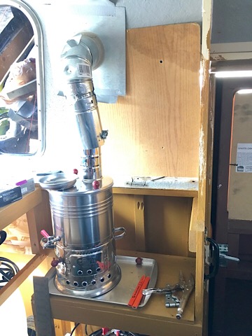

You can see the 3 gallon shower sprayer in this pic. I removed the TALL handle and it will be replaced with a rope handle to allow towing the filled unit from a water source. It will be painted black for solar heat collection too. That cabinet will have a drawer in the upper opening, plus a pull out table. There will also be doors, two in the galley and one in the cabin for access to the potty bucket.
The smoke pipe for the stove/water heater is wonky in this pic, it is just propped up. I wanted to see how much space is left... and there’s room for a single burner stove to sit to the right of the heater. That way I can heat coffee or soup or something simple without involving the galley. The shelf will be covered with a stainless steel ‘shelf’ that will be propped up enough for a cookie sheet to fit under it. That will allow air flow under the heater and stove as well as provide a good place to sit hot pans by using the cookie sheet on the shelf to the left. All of that area will be lined with aluminum heat protection too.

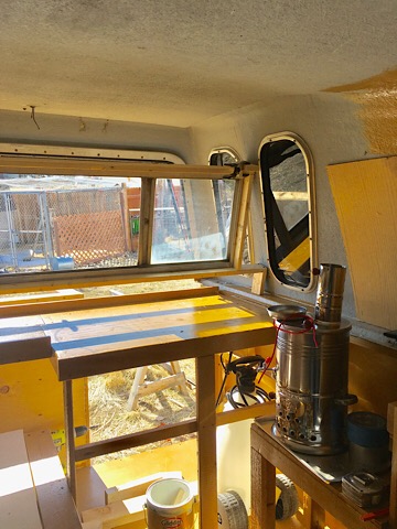

I was going to paint, but decided to play with the interior cabinetry more today. I managed to fit the divider wall/window in place. I had intended to make it vertical, but it wouldn’t work out like I wanted, so it has a slant to it. That actually worked out well. It makes less reflection inside and leaves LOTS of room above the window/wall for a nice cabinet. The space below the window/wall will be storage and also house the electrical controls and outlets. I ordered the controller for the solar panel yesterday, and it should fit nicely into the space.
Looks like this from outside, with the hatch open. Again, the bottom half of the rear end will be two doors that hold the cooler and stove.
The view from inside is nice, I didn’t want to lose any of the view out the back if possible. There are sliding windows for the center section, I took them out to reduce the chance of breaking them during installation.
