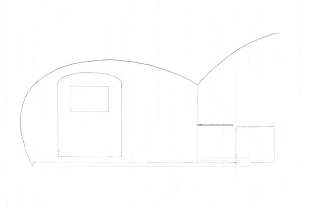

The great design debate continues...a frontrunner may be emerging?
It's not just my grandpa that's party to this madness. I now have my uncle spending work time looking up teardrops. He printed me off the 1947 Mechanix Illustrated article and I was inspired by the rustic look of Howard Warren's 4x10.
I initially rejected this type of traditional profile that narrows to a point at the aft end because I didn't want to bang my shins while leaning over to the galley and aggravating my already bad back. I've gotten around this by designing a full-width slideout that not only gets the stove, etc out where one doesn't have to lean over, but also has the effect of nearly doubling counterspace (as a permanantly mounted counter remains while the lower portion slides out) and allowing the galley to be housed in about 1/2 of the total length called for in the Mechanix Illustrated plans.
My version of the old design is 5' wide, 9' long with 78" mattress length (enough for my 5' 10" height). Here's a rough sketch that didn't scan very well.
1) Thoughts on latest design?
2) Thoughts on car undercoating to be used to seal bottom of floor and framing members? It's rubberized and flexible...I'm thinking it may be a good choice.

Postby aggie79 » Wed Dec 31, 2008 9:19 am
bbarry wrote:1) Thoughts on latest design?
I think your design choice is very good.
The slideout galley is nice; however, you may want to check your interior measurements to be sure your bulkhead (assuming you are planning on having one) will leave you with the depth for the mattress.
Have you thought about a 10-foot length? The reason I ask is that Andrew already has the profile curves plotted for the trailer-for-two in the design library. Also, 4' x 10' plywood can be found fairly easily, so if you're paying for the materials, you might as well use them.
If I've done my work correctly, I should have 78" in front of the bulkhead for the mattress. This should be enough for me...I had my wife measure me laying down! :lol: That leaves me 24" of floor behind the bulkhead (minus the width of the ply for the bulkhead itself). It's hard to see in the drawing I uploaded as it didn't scan very well. Using the profile I plotted on graph paper, this should give me 18" of cabinet depth at counter height and the slideout will come out from there. I'm sure there's something I'm not calculating...but after all, that's why plans are only plans!
Good to think about! I am trying to stick with a 9' overall length if possible because I'm building off a 4x8 trailer. If I keep the floor to 8'6" I only have a few inches of front/rear overhang. I am considering stretching the floor to 9' and the overall length to 9'6". That would allow me to expand the sleeping compartment to 80" and the galley to accomodate the hatch without losing counter depth. I will be using 5x10 sheets as I need more than 4 feet to skirt and cover the frame while still providing comfortable sitting height inside. I think 52" or so ought to do it. Luckily, my wife works for a large local lumber and building supply company. She's pricing the ply out for me today. Hopefully with her discount, it won't be bad.

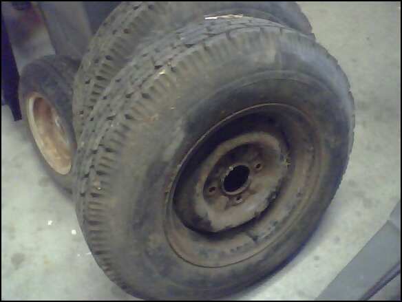

The tire and wheel selection has been a giant pain! After having decided on a profile and design direction, I went in search of an appropriate wheel/tire/hub combo. I'm starting with 4 on 4" hubs which is nearly impossible to find any wheels greater than 12" for.
I thought I hit the jackpot when I found a pair of 13" steel wheels with a 4 bolt pattern complete with original bias ply tires. They look great (or would with a little cosmetic work to the wheel). The tires aren't worn, weather checked, cracking or anything. They look brand new! The best part is, I found them in our barn...FREE! They were off my great-grandma's 1963 Chevy II. Then reality set in when I measured and found they had 4 on a 4.5" pattern. After searching the internet high and low, I've determined that you can't find 4 on 4.5" hubs (willing to be proven wrong if someone out there knows of a source).

1) Use the new wagon wheels I found on my existing hubs. Cost: wheels ($60) plus whatever the cost is for new tires (passenger radials would be cheap, reproduction bias ply tires...not so much).
2) Find a 13" wheel with a 4 on 4" bolt pattern that is 5.5" wide. That would have the advantage of using my existing bias ply tires and existing hubs. Cost: 2 wheels (if I can find them)
3) Replace wheels and hubs to go with a 5 on 4.5" wheel and hub, using existing bias ply tires. Cost: 2 wheels, 2 hubs

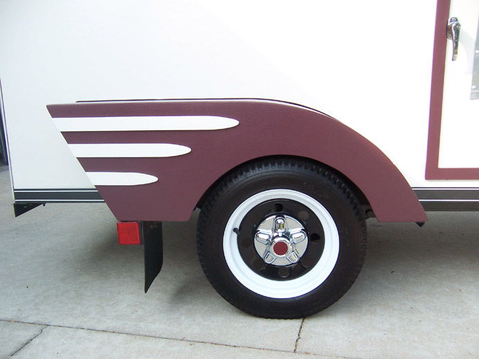

bbarry wrote:Perhaps I could paint them black and mount a baby moon on them?
That would work. Or, you could do what surveytech did with his wheels:
:thumbsup: I like that, it looks almost like a white whitewall. It's not quite what I had envisioned at first and I'd have to find a different center cap (4 bolt hub). The picture of the white wagon wheel I posted was a 5 bolt pattern, but the wheels I found are 4 bolt to match my hubs.
Thanks for the suggestion...it's a good option to keep in the back of my mind if I can't figure out how to do what I originally wanted.
