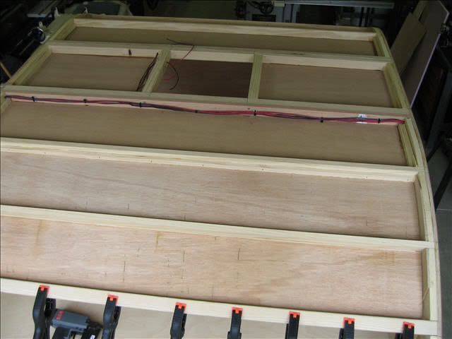

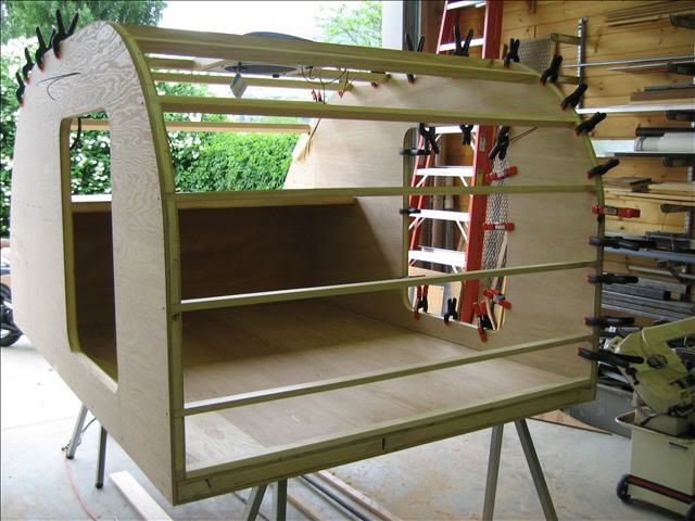

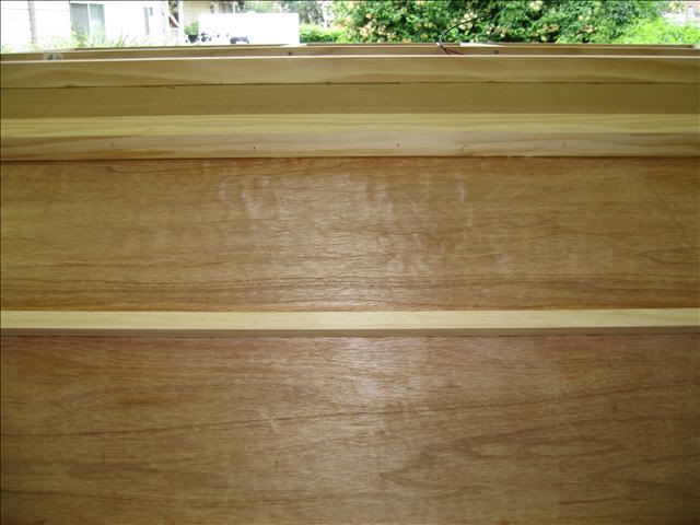

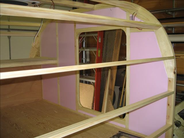

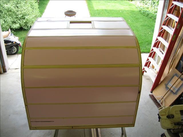

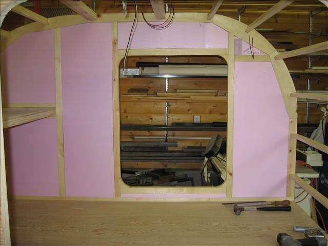

Postby jkidd6339 » Sat May 02, 2009 5:36 pm
Got a chance to work on the Teardrop a little more today. Here are some progress photos.

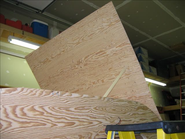

Postby jkidd6339 » Tue May 05, 2009 9:09 am
In looking for plywood for the interior walls and ceiling, most of the stuff I find is mdf core. Is this what everyone is using or do I need to keep looking for a plywood core?

Postby kennyrayandersen » Tue May 05, 2009 6:22 pm
jkidd6339 wrote:In looking for plywood for the interior walls and ceiling, most of the stuff I find is mdf core. Is this what everyone is using or do I need to keep looking for a plywood core?
1/8 inch plywood. It comes in several forms and you may have to take what you can get -- some places even seem to have a bit of trouble getting it. Luan is one form (which is actually kind of a cheap plywood), plywood is another (usually birch). I would try to use one of those if I were building out of wood. MDF is medium density fiberboard. It would probably work and I'm sure someone has used it before (nearly everything under the sun has been tried!).

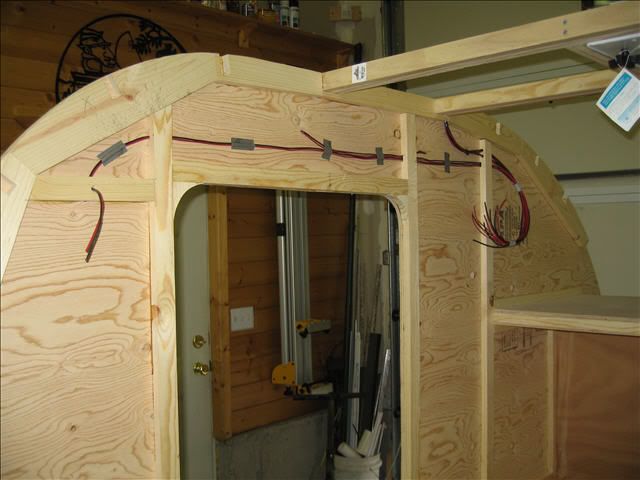

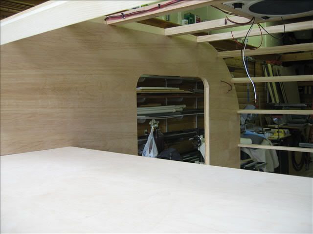

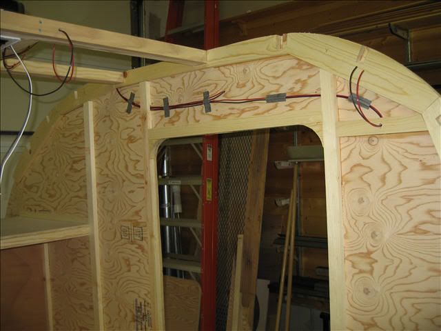

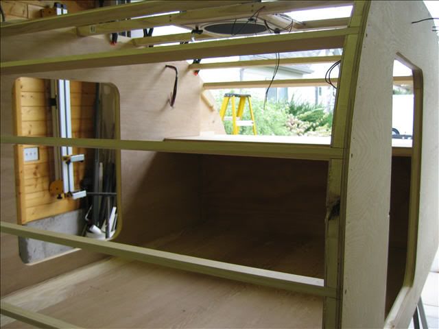

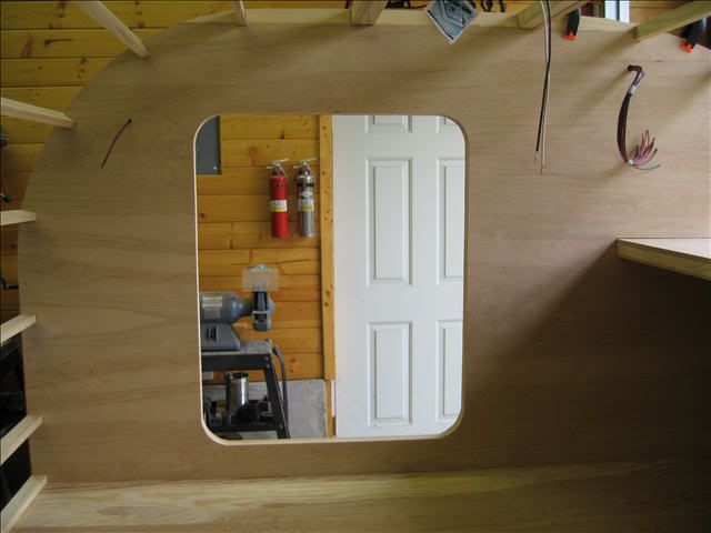

Postby jkidd6339 » Sun May 24, 2009 12:28 am
Here are a few more photos.
Interior walls installed and the spars are in permanant.

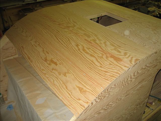

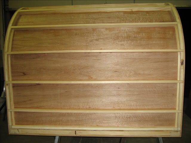

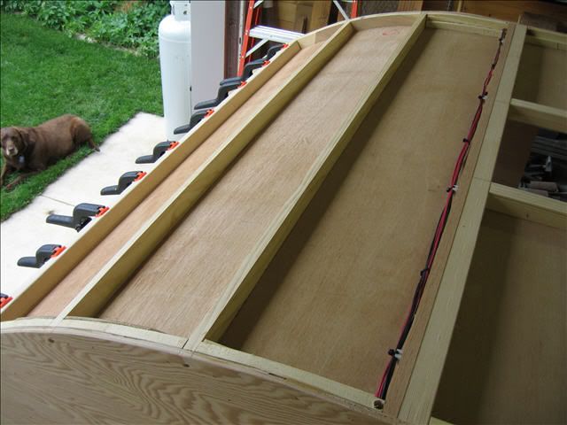

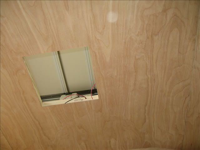

Postby jkidd6339 » Sun Jun 07, 2009 12:11 am
Thanks Thomas It was a fun trailer to build.
Here are some new pictures

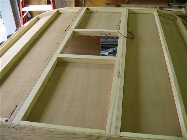

Postby KDOG » Sun Jun 07, 2009 9:40 am
Wow what did you use for the roof? Looks like 1/4".... What were your roof spar dimensions?
FAILURE TO PLAN ON YOUR PART DOES NOT CONSTITUTE AN EMERGENCY ON MY PART.
KDOG
Posts: 217
Joined: Mon Mar 26, 2007 2:31 pm
Location: Cape May Court House, NJ
Postby jkidd6339 » Sun Jun 07, 2009 10:18 am
Yes, Thomas somtime the question is, Ok how am I going to do this with one person and that's where the fun begins. Kdog the roof is 1/4" and the spars are 3/4" X 1-1/2" Except the 2 by the vent there tripled and where the seams are there doubled.
