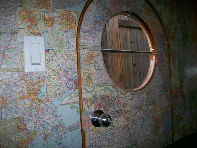

Postby bohemian » Sat Sep 26, 2009 8:55 pm
Fantastic trailer! not to long from now I'm going to have me one of them beauties. How about this for the interior. notice left of the door knob Image

Postby ktm_2000 » Wed Sep 30, 2009 11:52 am
That is an interesting interior. My wonderful triangle of commuting is displayed on the map.
I live in Worcester in the far left, Work in Providence RI to the south, And camp and fish on Cape Cod. My boat is kept right near the door jam.
