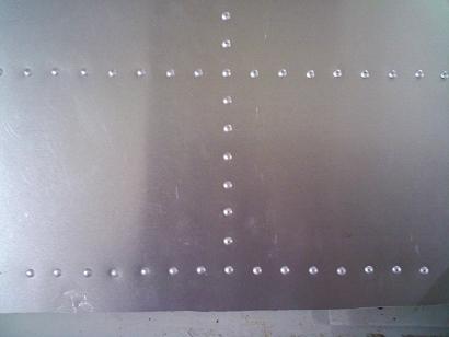

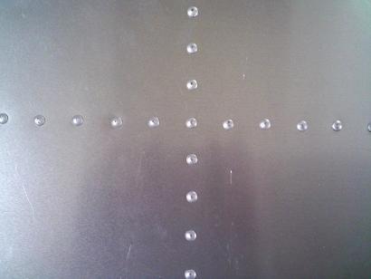

Made up sample panel of the rivots for the Bomber Tear today

Postby starleen2 » Tue Jan 19, 2010 5:08 pm
Good lookin' pattern - Who "bucked" em' on the other side for ya'? :lol:

Postby prohandyman » Tue Jan 19, 2010 5:12 pm
I figured someone would ask that question. I'm a cheatin! These are aluminum drive screws hammered thru the skin into 3/4 ply walls. That way I can build a traditional built tear and still have the rivot look! :twisted:

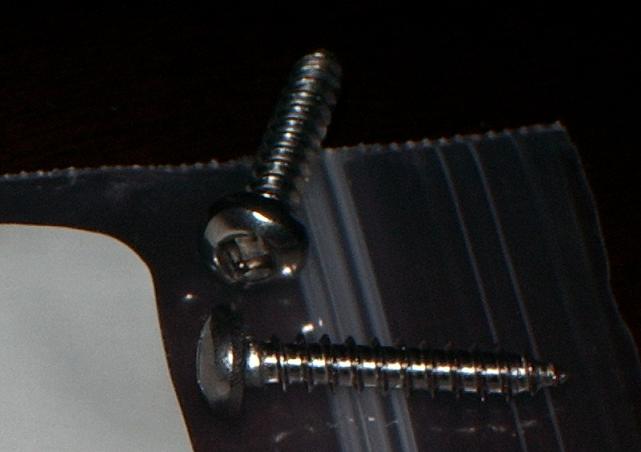

That's similar to what I did by using stainless steel pan head screws with a square drive. I also wanted that riveted look with the ease of screws.

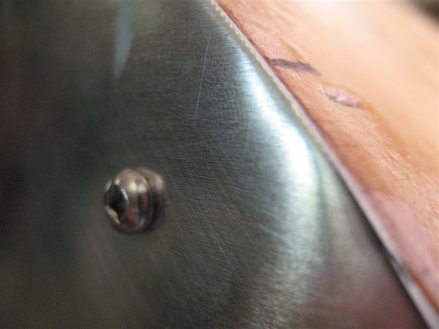

Postby jkidd6339 » Wed Jan 20, 2010 1:15 am
This is the one I was considering for my tear.

Nice job on the rivit treatment Dan! That will be something that really sets it off! It may seem like a hassle to do, just for the looks, but that's what it's all about! Doug
Postby S. Heisley » Fri Jan 22, 2010 9:19 am
I would think that screws hammered in instead of screwed in would back out more easily under road vibration; but, I imagine that you are putting a dab of some sort of glue/silicone on each one when you hammer it in, right? Do you drill a hole first? What is the actual process?

Postby prohandyman » Fri Jan 22, 2010 10:46 am
On this trial piece I pre-drilled the holes a few thousands smaller, and tapped the nails in. Pretty tight fit! On the actual camper I also plan to dab a drop of epoxy under each. They are twist nails, which detours the backing out process.

Postby planovet » Fri Jan 22, 2010 3:54 pm
Looks good! :thumbsup:
Have far apart are you putting the screws? It looks great but very labor intensive. :?
