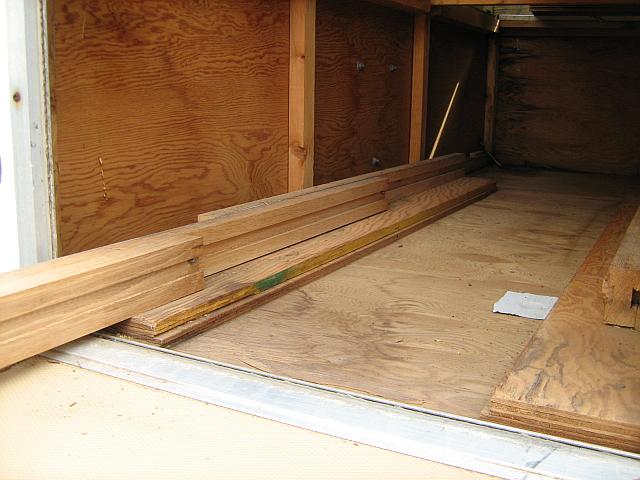

I didn't intend on doing much outside today in the brutal cold, then I get a request from Mike? How cool is that? Here ya go, buddy. If this doesn't answer your questions, lemme know. Pardon my terminology when describing the parts, there's probably a more accurate way of describing this.

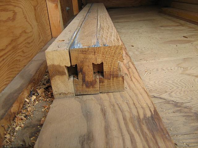

The galley box is 75" long, 19.5" wide and 12.5" high and constructed of 3/4" ply.
There are three dove-tailed rails for each side. They are built of hardwood, appears to be oak, 1.5" x 2.5" and are 44" long. All rails rest on a plywood base and the outermost rail is secured near each end with a bolt that extends through the flooring, making it stationary. The other two rails extend as the box is pulled out. A splined stop,,, I think that's the term,,, 4" in length is permanently attached to the rail ends. These 4" pieces are the only parts that travel in the dove-tail track.
In this first pic, I have removed the galley box and the view is looking at the aft group from the curbside. It's difficult to see, but the right rail (just like the center rail) has two dovetails.
This shows the three aft rails during extension.

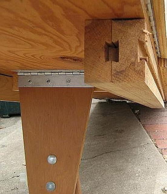

This shows the attachment to the underneath of the galley box, but you will need to imagine the rail with 2 dovetails, the one on the right, not being there. The stop is missing on that one and it's not working correctly. I haven't been able to hold the box up and get it aligned properly without an extra set of hands. So, what is permanently attached to the box and doesn't slide is the single dove-tailed piece on the left, with one stop on the opposite end.

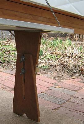

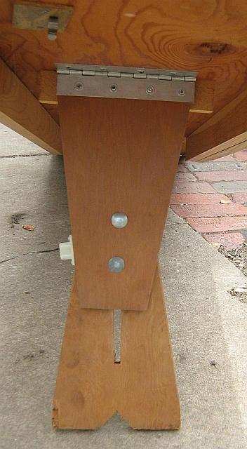

Support leg: Once the box is extended, the flip-down leg supports the end. There are two large thumb screws that allow you to vary the leg length, the near leg is slotted. A cabinet door spring clip holds the leg in place during storage.

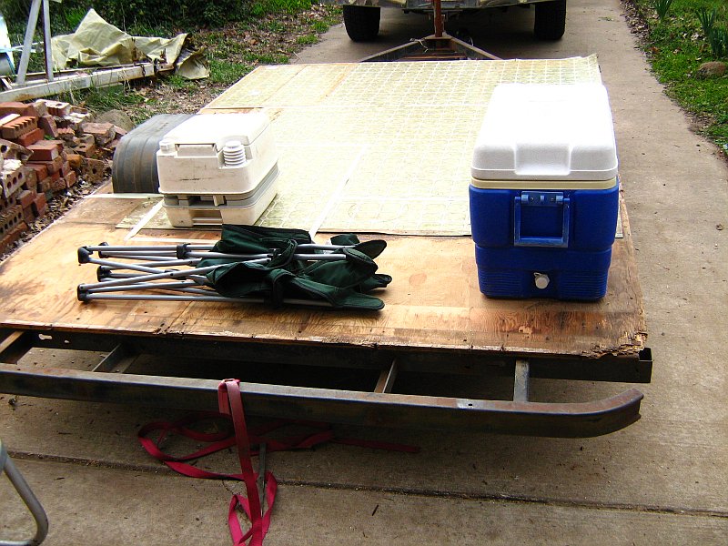

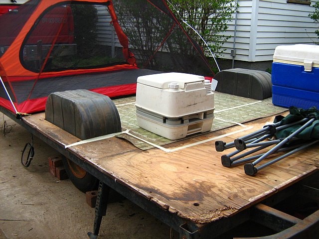

Postby StPatron » Sat Mar 20, 2010 2:04 am
Absolutely gorgeous day today in the 70's, with NWS predicting a blizzard tomorrow, so I decided it was time to continue the dismantling and see what I had to work with from bottom up. The "driveway workshop" has its limitations.
Not too bad. Corners of the flooring have some rot, expected. I will be able to half-lap replacement plywood in at the hitch end, a tongue framing member has me in good wood with a couple of small triangles. I'm thinking about extending the aft end to the existing bumper to eliminate that knee-knocker.
