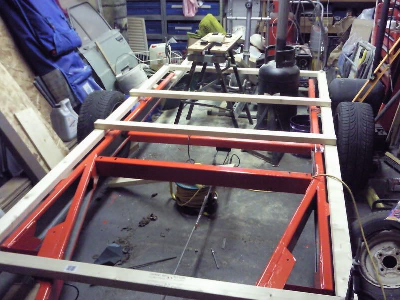

Postby Rigsby » Fri Mar 12, 2010 6:25 pm

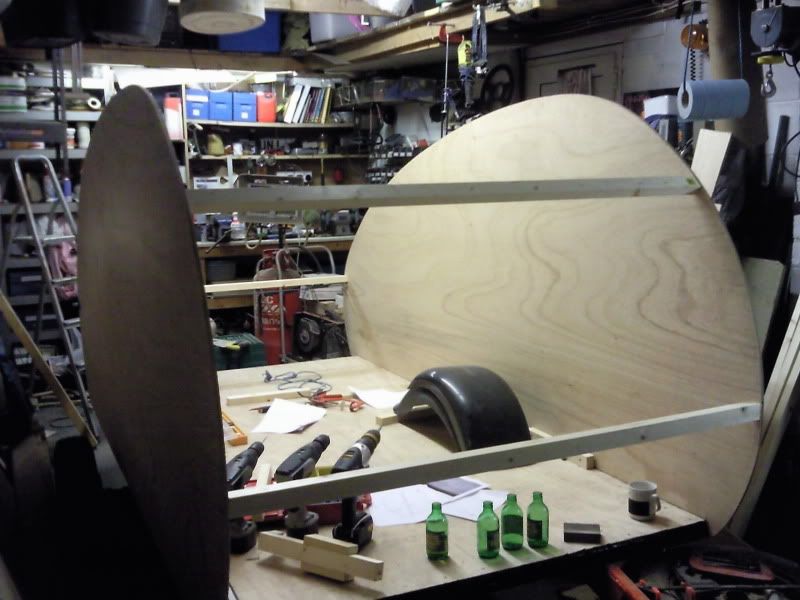

Had a bit more of a play today. Struggled a bit screwing on the sides, as the ply has a bit of a warp to it, but hopefully this will pull true once all the spars are in. At one point there was a gap 3" wider than the spars
Then Phil and Paul came over, so the job had to stop while we had a beer and talked MAN STUFF. Ive also removed the door lock from the free door, and adapted the lock tumblers to fit a key . Gave it all a clean and built it back up and it works a treat
The only picture of the day, Im sure my Garage is shrinking, Ive got to step out the door to take a picture now

Postby Rigsby » Sat Mar 13, 2010 7:24 pm

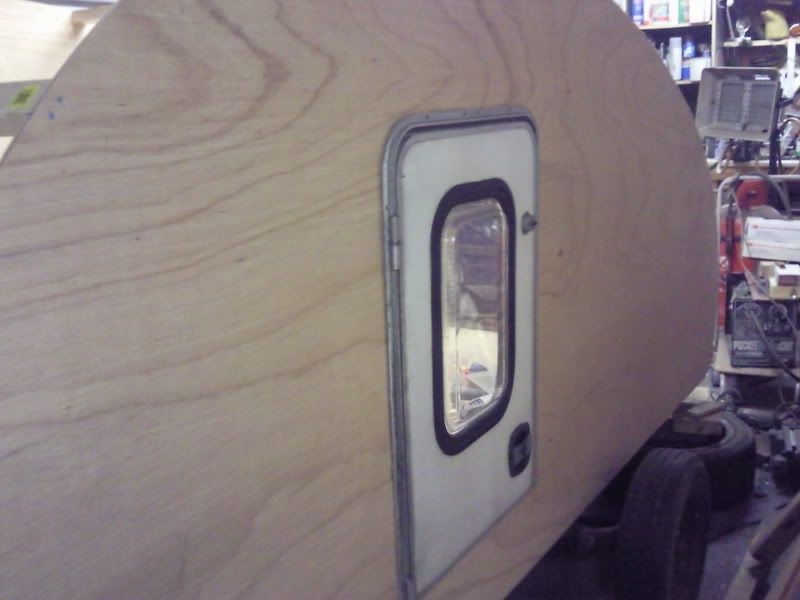

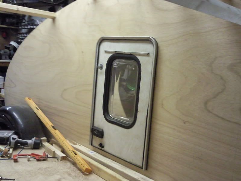

Kept out of our gert way, and played in the garage again. Screwed in all the spars that i have wood for (got to find enough wood for the last 4
Then i cut down the door frame and set to chopping the hole out. I managed it in one go with no more cutting required to get the door and frame in on a trial fit
If the door looks a bit too much to the rear, its so it can open and not go past the profile so i can have an awning on the side

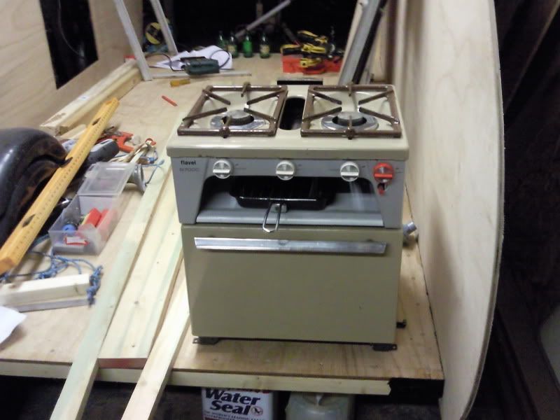

Not got anything done today on the tear, Had my mother over for a Mothers day tea. But joy of joy have i bagged a bargain for the camp kitchen. A mini gas cooker with oven, grill and two burner rings, and i didnt have to pay a penny

Postby jackdaw » Sun Mar 14, 2010 6:24 pm
Nice little cooker Steve, :thumbsup: Are you going to tell us what you had to do for it ??? Come on now.....spill the beans.... Yarkshire folk don't do free bees...do they ?

Postby Rigsby » Mon Mar 15, 2010 5:33 pm
Got to come clean, it was my mums, she used to use it at girl guide camp, when she was a leader. It was the easiest way of heating pie and peas for 20 hungry guides, when there was no power

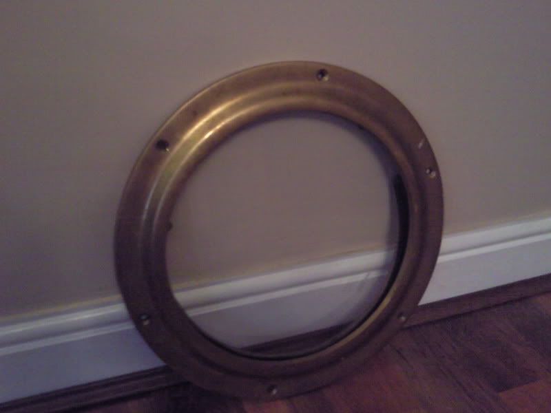

Not a lot to update with today. Managed to get a solid brass porthole window for the side opposite the door , but ran into a problem when i found the router circle cutting base adjusts to 10mm less than i need
Looks like i will have to adapt it tomorrow

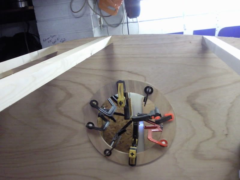

Not done much on number 2 today, spent most of the time altering the router base to be able to cut bigger holes. Once done i completely screwed up the first on by measuring the diametre needed and then not taking into acount the width of the router bit
Anyway sorted it out in the end and cut the hole for the window, and then a cople of sandwitch pieces to strengthen the side. Then spent an hour getting them in place before the glue set
