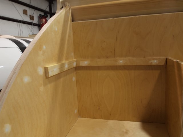

Postby Alan and Lianna » Sat May 29, 2010 3:24 am

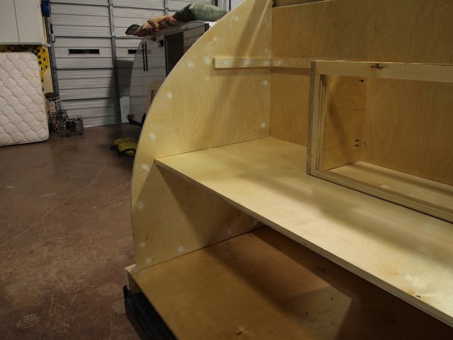

We have applied several coats of paint on the interior walls.

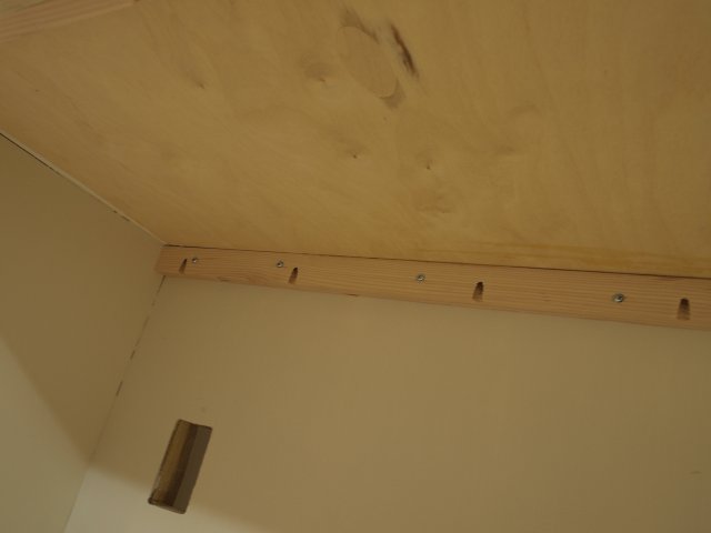

Added some shelf supports

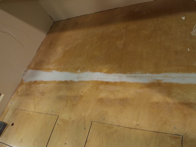

Epoxied the floor seam
Sanded the galley walls and applied CPES epoxy
After several coats getting shiny

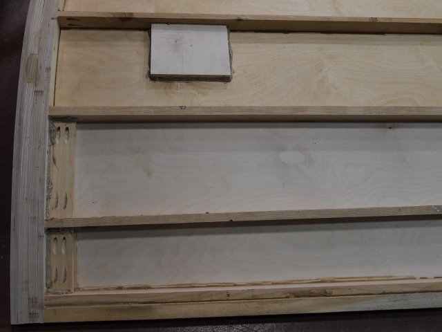

Added blocking for hatch supports and lighting
And set the hatch in place to admire our work

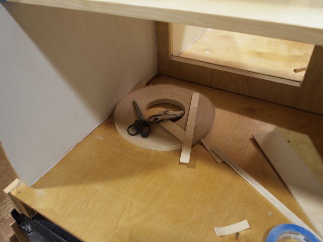

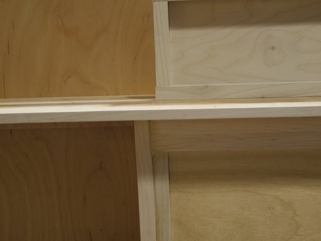

We plugged in the iron to to get ready to apply some veneer.
The edges of plywood look so much better veneered.

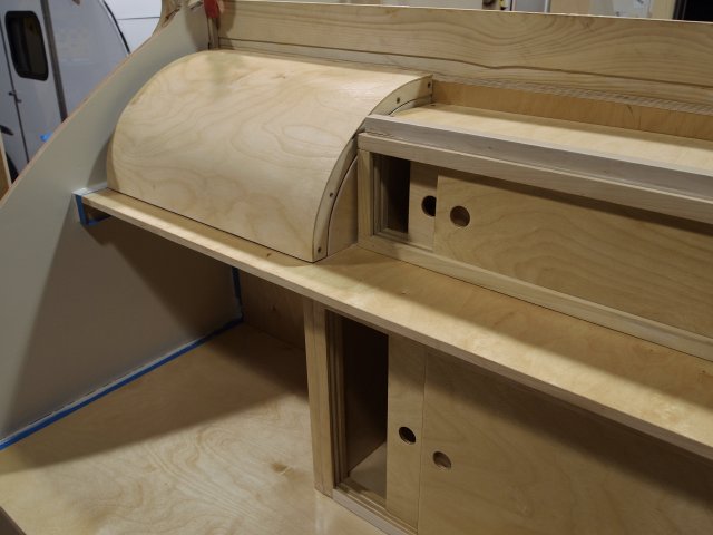

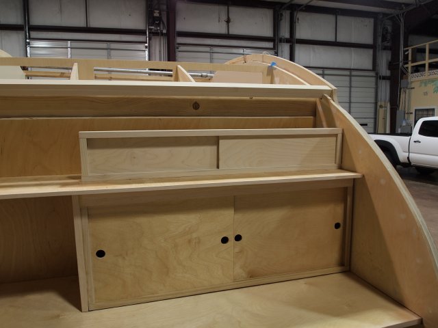

We built the upper sliding doors and set them in place.
Started working on an idea for a breadbox.
Tried another idea.
Finally agreed on an idea and started building
A breadbox hatch!
All it needs is some taillights and a license plate which we will add later

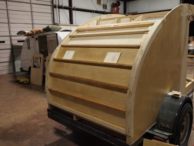

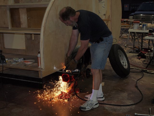

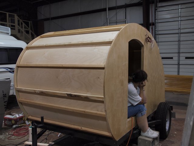

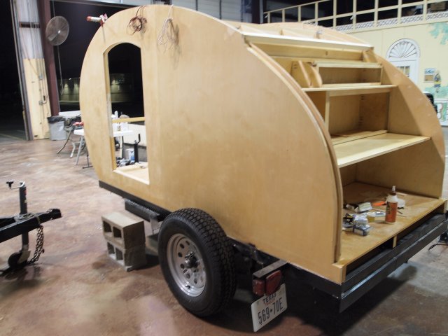

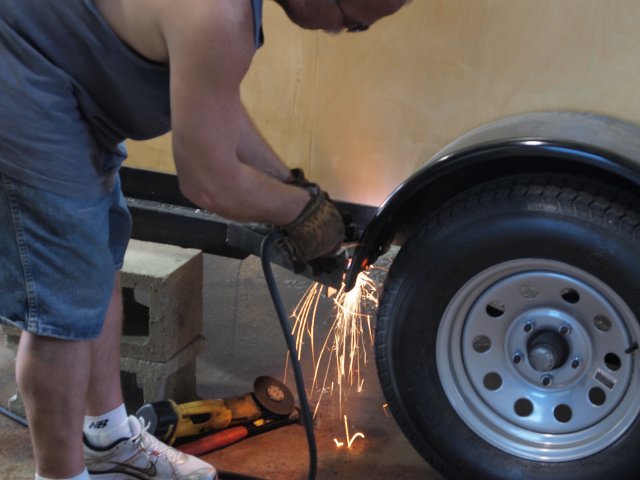

After putting up the walls, we noticed we did not have enough clearance to epoxy behind the fenders, so my brother had bought a new plasma cutter and I knew like any man with a new toy he was ready to cut something, so I invited him over and he proceeded to cutting.
He even let me do some cutting..
Now the fenders are gone
and I'll be inviting him back over in a week or two to try out that new welder he bought and hasn't used yet!

Looks great! can I ask what kind of plywood you used for the counters, and sliding doors?

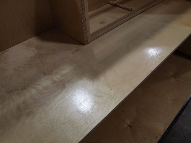

The countertop is 3/4" baltic birch plywood with birch veneer adhered to the outer edge to cover the layers. The sliding doors are 1/8" baltic birch plywood, the sliders are poplar veneered to match. The entire galley has been coated with 3 coats of epoxy and sanded in between coats.

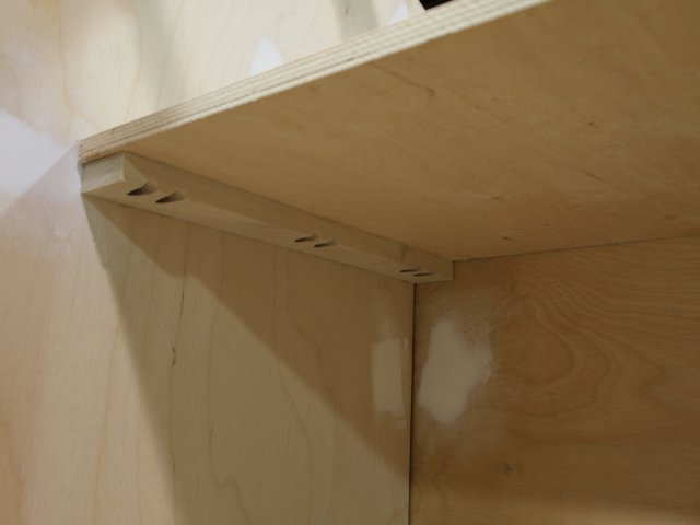

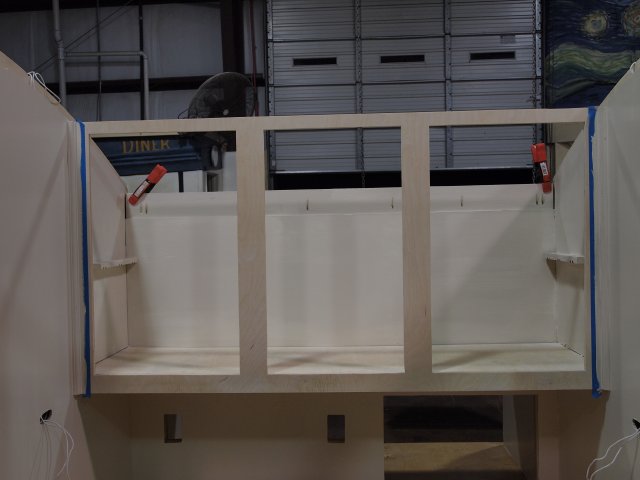

Postby Alan and Lianna » Wed Jun 02, 2010 12:33 am

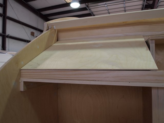

We bought some more 1/8th inch plywood today at Houston Hardwoods and picked up a 250 foot roll of veneer for $19.
Added lower shelf supports
Added upper shelf supports.
I had a router gouge at the bottom of the facing
So I shaped some scrap wood with the router
Which covered the gouge nicely

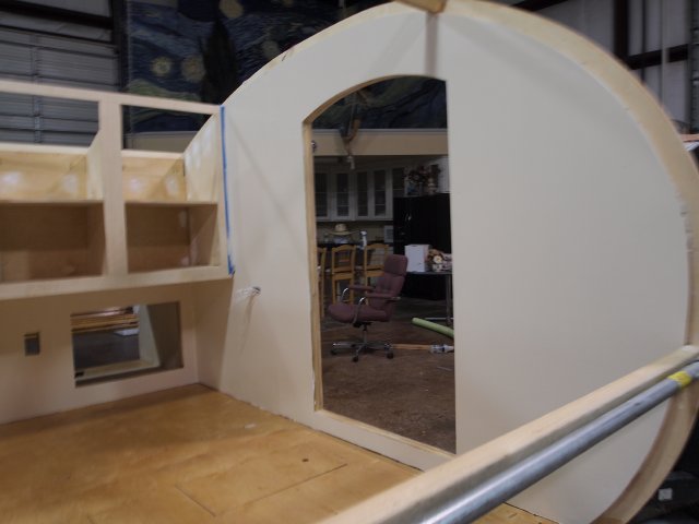

Did some more painting
The bulkhead with the first coat of paint
Painted the Galley walls

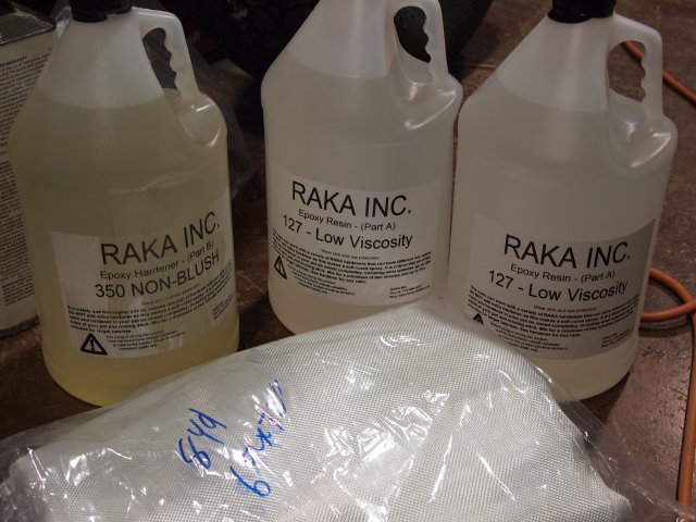

We had finished off the 2 gallons of CPES that we had 2 days ago, and have been waiting patiently for our shipment of 3 gallons of RAKA epoxy that was lost by UPS to be replaced, well it arrived today... YAHOO....
So we are concentrating on finishing up most of the interior so we can put on the ceiling possibly tomorrow night.

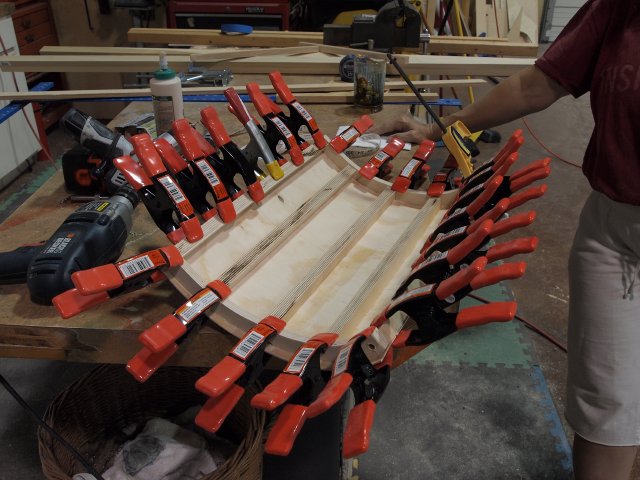

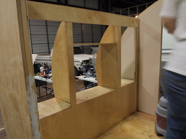

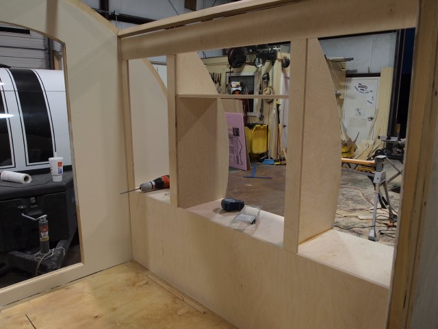

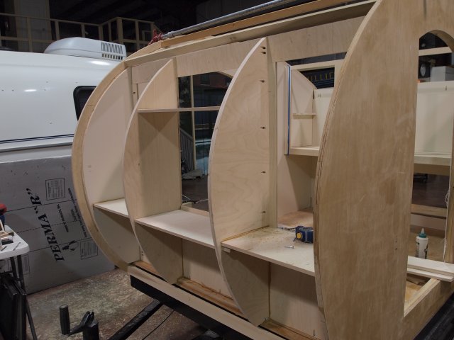

Postby Alan and Lianna » Wed Jun 02, 2010 10:54 pm

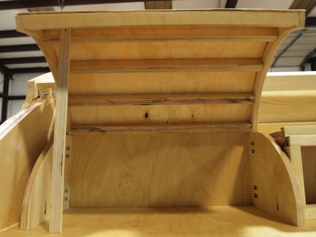

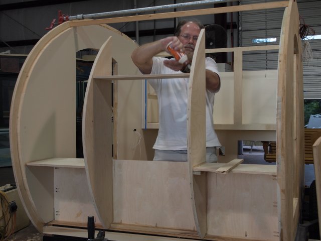

Well, today started out with a thunderstorm on the way to the shop, luckily we had the tarp covering the 6 sheets of 1/8 inch baltic birch we bought yesterday. It was coming down so hard we pulled into the car wash to better

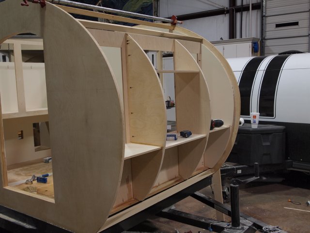

secure the tarp and got soaking wet, but we made it and the wood barely got wet. We were out of any large 1/2 inch or 3/4 inch plywood, but we did have the 1/4 inch full size template that we used to cut out the profile so we cut 6 pieces from it to match the front profile for the front cabinets and glued 2 set of three pieces together to create 2 3/4 inch dividers.
We then proceeded to assemble the front cabinets.
The center will be left open and there will be doors added later on both sides.
Not quite ready to install the ceiling, but getting close...

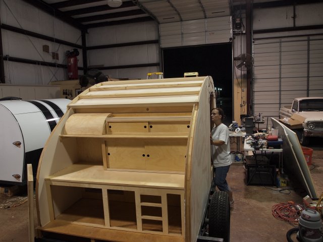

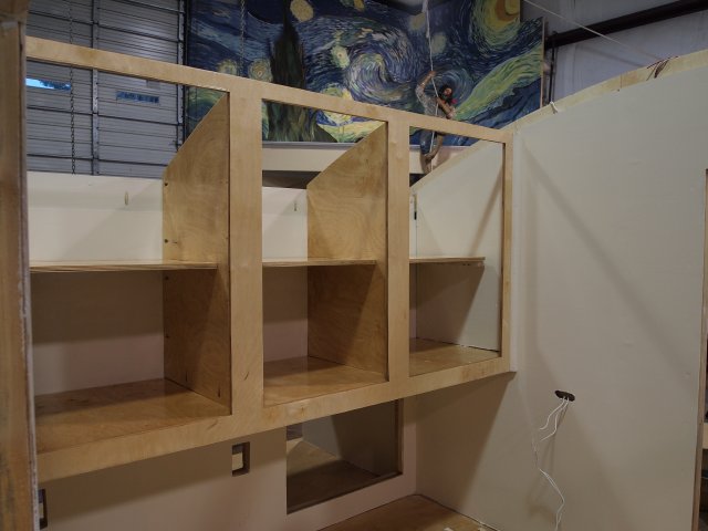

Postby Alan and Lianna » Thu Jun 03, 2010 11:56 pm

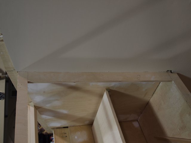

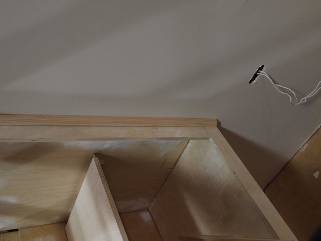

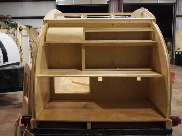

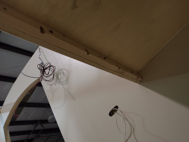

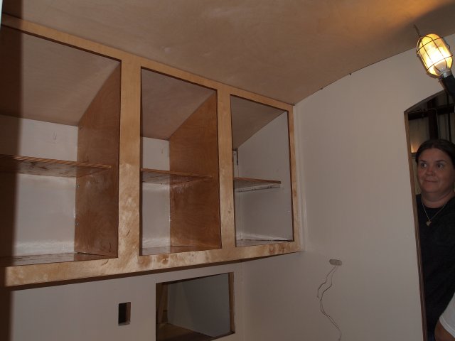

After alot of sanding and prep-work, we mounted the rear shelves and then varnished the shelves and cabinet facing.
We placed molding along both sides of the front cabinets and then sanded and varnished them too.
We installed the ceiling and spars.
We placed all of the sliding doors in the upper cabinets in the galley and temporarily put into place the lower cabinet facing just to see our progress.
Today we used the new Raka epoxy that we ordered. It is a much thicker solution than previous epoxy from Rot Doctor and little harder to work with. Tomorrow when we start again, we are considering thinning it out slightly to make it easier to spread.
